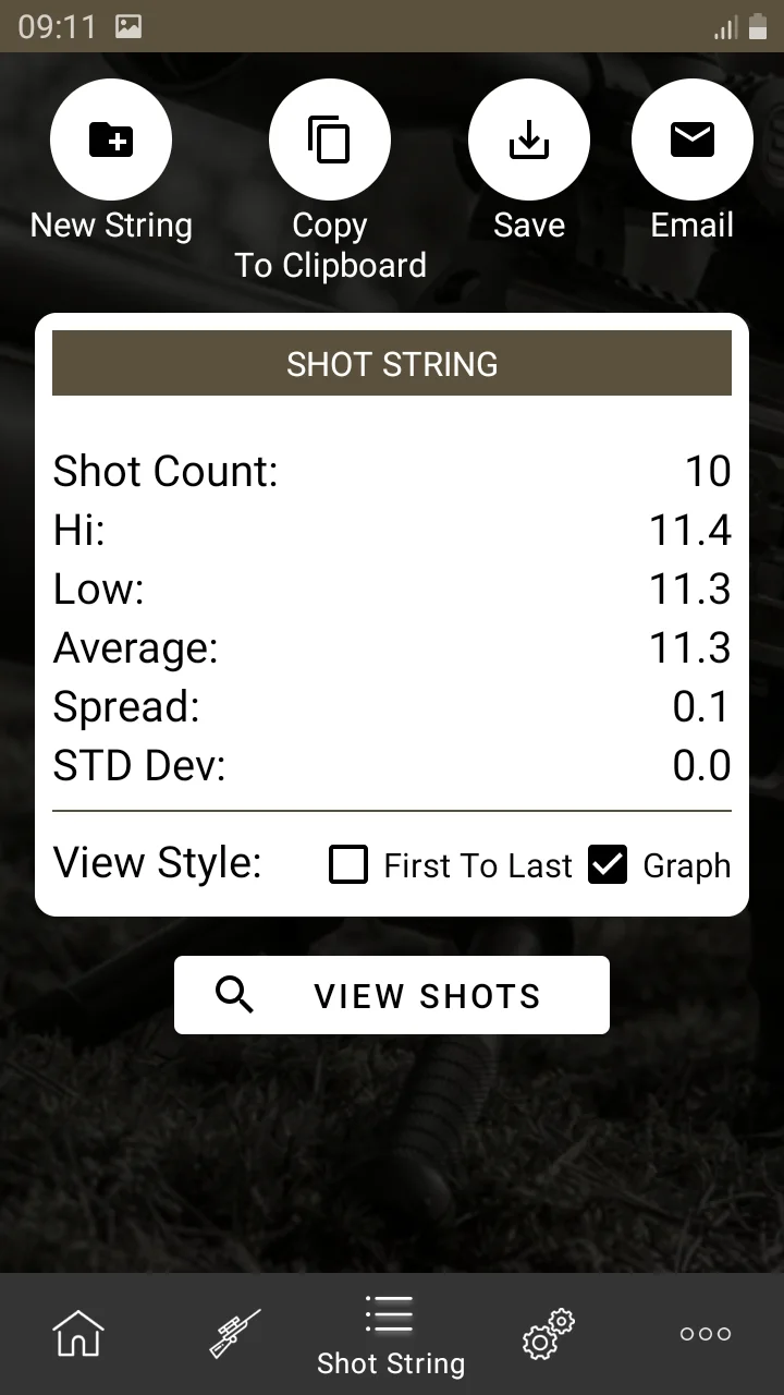

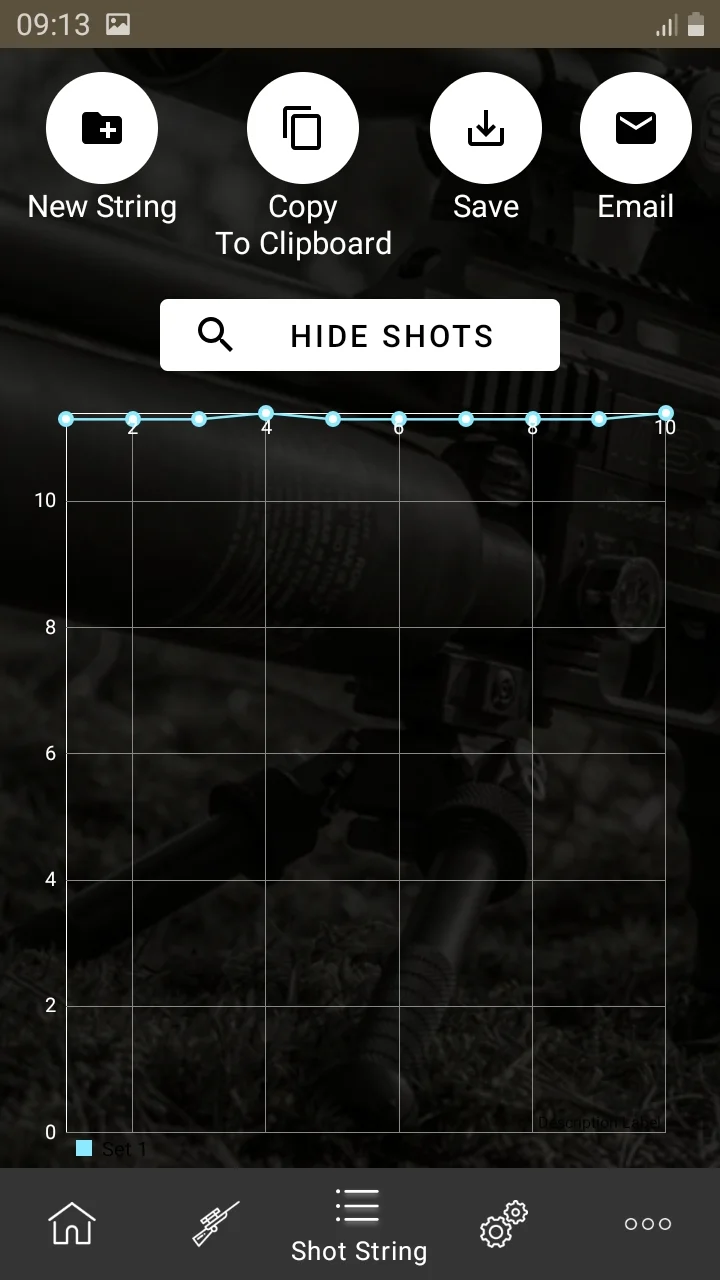

My R10se, Huma regged (was set at 95bar by Huma) bought direct from Huma with no adjustment made when fitted. I suppose I just got lucky. Shot string using AADF 8.4 grain.
