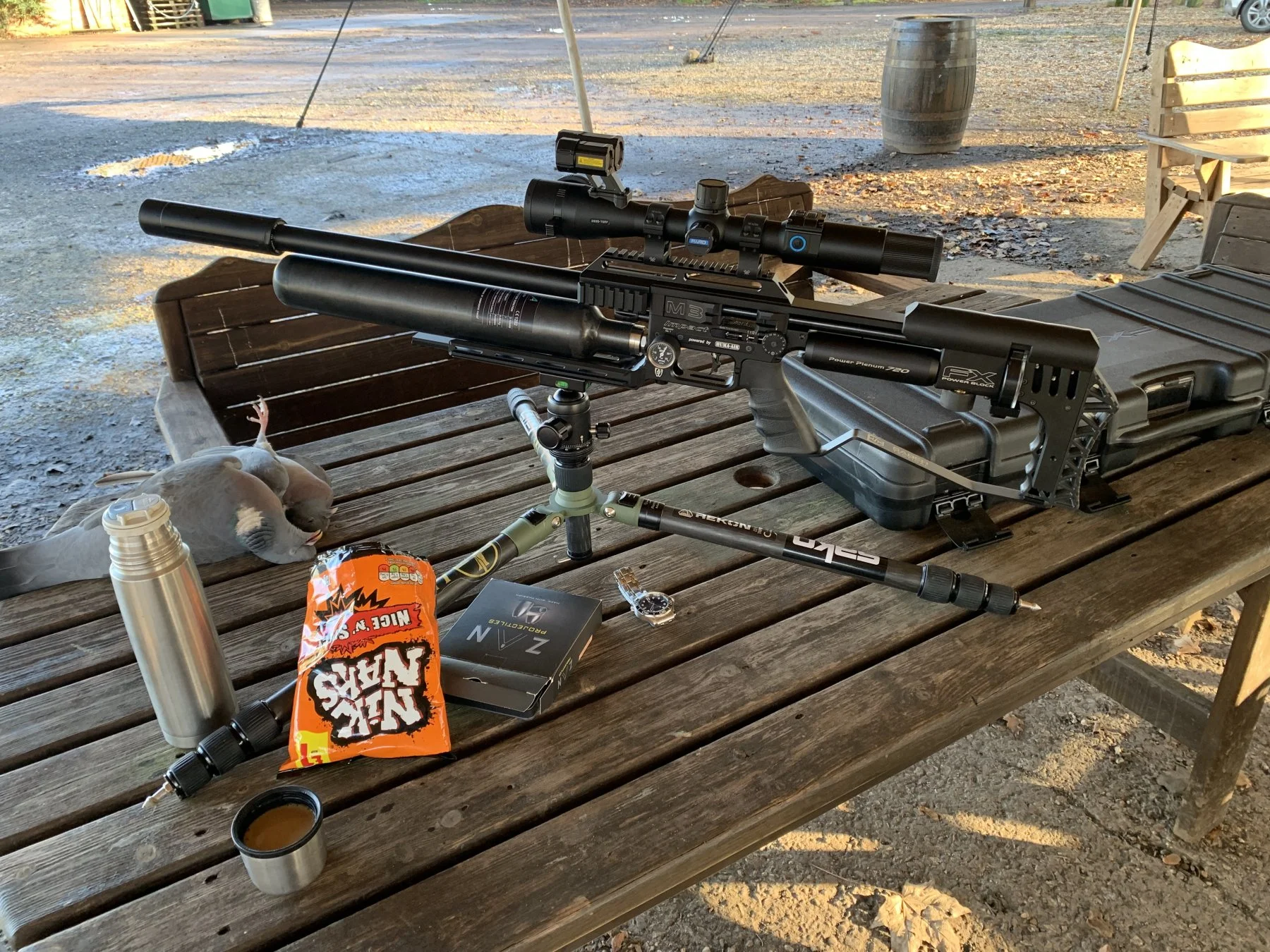

A few have asked what my setup was .
I would say the Nic-Naks and the coffee . After all there’s no need to be uncivilised . 😁
