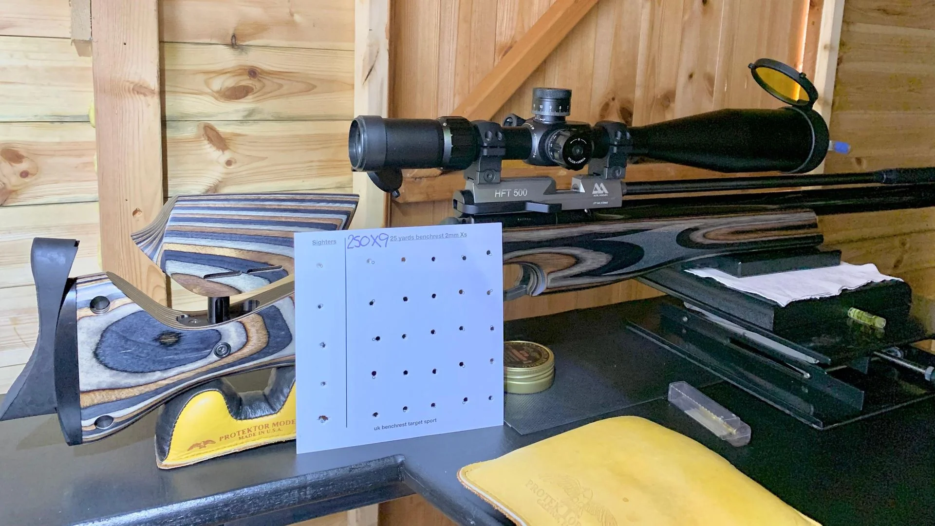

Accuracy to me is single pellet hole sized group and 30m and at the indoor 55m range I expect 7mm hole or less, I've had a few rifles that can do this and a lot that can't.
When I see people put 5p groups up at 25 yards to me that's shocking for a PCP but maybe it's just me.
So whoever this is (Airgun World pic) should find another sport. 11mm groups considering the gun, scope, rear bag and front rest is pathetic

Do you mean with a 0177 you can shoot a 5 shot 4.5mm edge to edge group at 30m consistently?
I mean with a .177 I can do it sometimes yes indoors rested but definitely not consistently although that's me not the rifle as sometimes I just can't produce groups that I'm happy with must be good and bad days.
@dac41 has watched me on a few occasions put them throught the exact same hole or near as you can get at 55m.
I've only had 4 rifles that can do that and I've had a few and I have to be on form too as sometimes I just can't but when the stars align I've done them groups a few times over on a trip to the range funnily enough I've had 2 hft 500's and one could nearly do it and the other had no chance.
Right?
No shooting a single group is way easier than a target card and that card is good, when you move there's so many variables but then again that rest should get rid of a lot of them....

Wasn't a pop at you mate, just think unless people are saying indoors and a pic of the setup it's hard to rate a group. Could be cheapy bipod and hand under the butt or full bench rest rig with SAB joystick rests
I didn't think it was mate and crazy thing is i got a fixed target bipod that was solid and shot worse than using a Coldwell front rest with a bag at rear.
