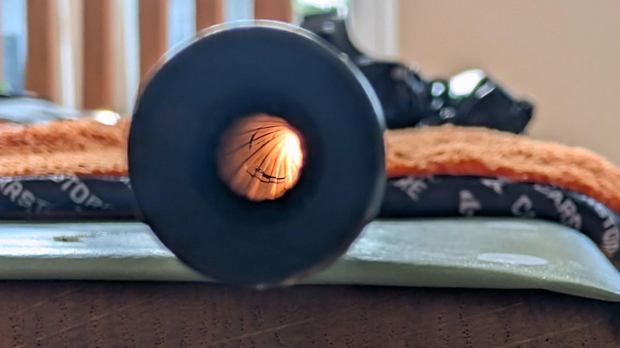

I've been sat on this for a few weeks now and frankly I've been too worked up to even talk about it. Once I found it I nearly knocked the comp shooting on the head ,it really threw me and still has a fair bit with the

Stop waffling and get to the pics man.
That is exactly what it looks like down the muzzle end of the xti50.
The crazy part about all this is it's highly likely not happened since I've owned it.
It's not actually as wildly inaccurate as you'd imagine. If it was an hft rig I'd have been hard pushed to tell apart from the occasional slightly odd report every so often when it went 'off ' the boil.
I've been chasing some very strange small poi shifts combined with some very weird chrono results when it was throwing a tantrum.

I am defo no expert on metals but looking at the picture in post 30 i would say flaw.
I look at is this way,i am fairly handy and how would i make a tool to impart that damage. it would need some lateral force,its a fair way down the barrel,if i read correct a stripper was fitted?its as if you would need gto insert then extend teeth/prongs.

The medal winning barrel has now been replaced by an unknown quantity (not all barrels can be BR barrels) and the medal wnning barrel is being cut in half just to see if it was a defect or something else.
Even if the rifle was a "pass around" rifle in Air Arms before Tommy got hold if it....its still been accurate enough to win medals. So unless its been left alone and someone has stuffed something down there to make the marks it seems unlikely to be malicious vandalism....

I would comment that if it is thought that the observed damage was caused by deliberate vandalism, then get a length of barrel and try to replicate what is seen in the pictures.
Keep in mind there wouldn't be carte blanche to use any conceivable method under the sun, restrict it to what could realistically be done if the rifle is left unattended at a range or show setting where a miscreant could be observed / caught at any time.

He , the same as you or I expected the barrel to be perfect in every respect ( we all hope that)To see damage to the rifling on inspection we all would think sabotage, after all look how well it has performed and who would believe that the manufacturer would supply a faulty barrel on a showpiece, nay centrepiece rifle.

I could be wrong 🤔 but i cannot understand how the rifle was performing accuracy wise to that standard ,with that amount of (defect / damage ) it would be leading up quickly with flyers all the time 👀🕵️‍♂️🤔
