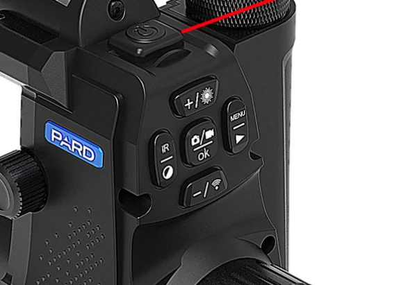

i am using built in IR not a add on switch it on with IR button and cycle through 1,2,3, setting i can see IR doing its job ok and can adjust beam by pulling forward for spot and back for flood lit what i have noticed is Blue indication light flashing when in use but battery power ok seems to flash when i am on IR mode i have also noticed red laser beam on photo of the 007s but mine doe,s not have it on for some reason
The red lasers have to be removed for the UK market, earlier versions of the 007/008 did have the laser when they were first imported to the UK but UK regulations require the laser to be removed prior to sale.

The blue flashing light is the indicator light to show it is turned on near the control buttons i have just tried it in daytime mode outside and perfect like looking through a pair of binoculars
