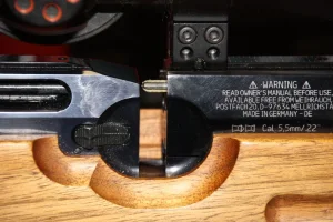

I have a drill jig for those !I noticed this too on mine. Going to be a pain in the neck if the probe/breech and barrel o-rings need replacing.![]()

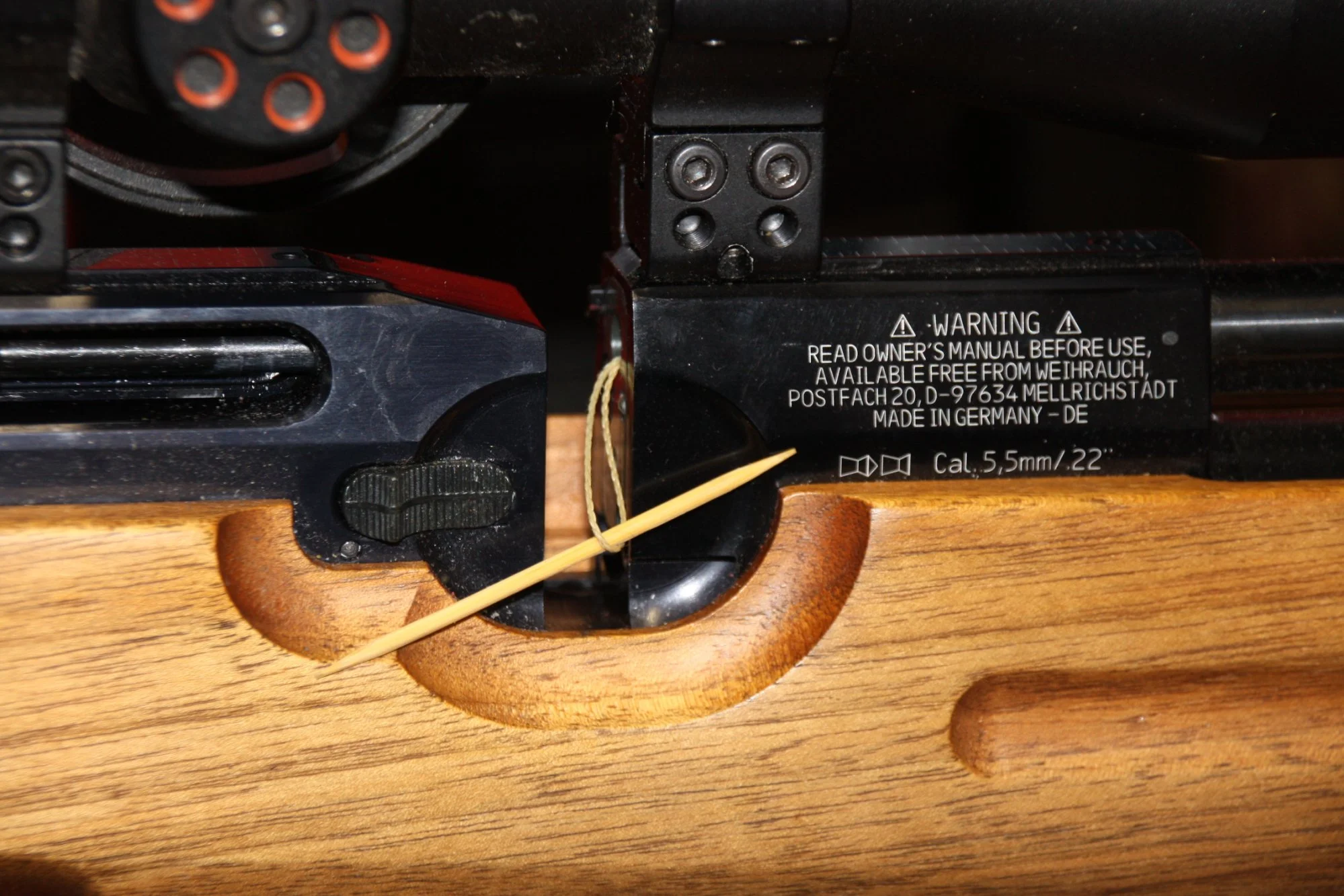

I bought some 3mm diameter carbon fibre rod and notched one end to take some 100lb breaking strain kevlar thread.John, how do you clean your barrel ?
Excellent, I am always concerned not to damage the O ring.I bought some 3mm diameter carbon fibre rod and notched one end to take some 100lb breaking strain kevlar thread.
Looped the thread over the notch, slid rod down barrel and hooked off thread from rod with wooden toothpick then remove rod.
Slip patch through thread loop and pull through.
The same method can be used on rifles, just need a longer rod and this also removes the need to use a straw as a guide.
