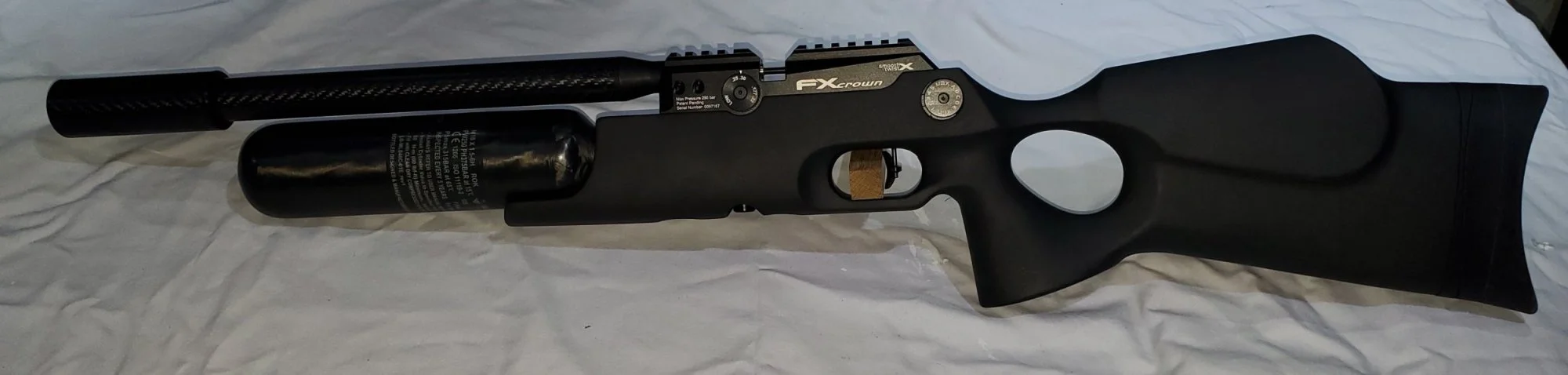

Here's my 340mm HFT 500 (pictures of my other barrels will follow as I sort through and fit).
Next job is strip this, check if I LoutWork'ed it before shoving it in the loft many months ago and set it up.

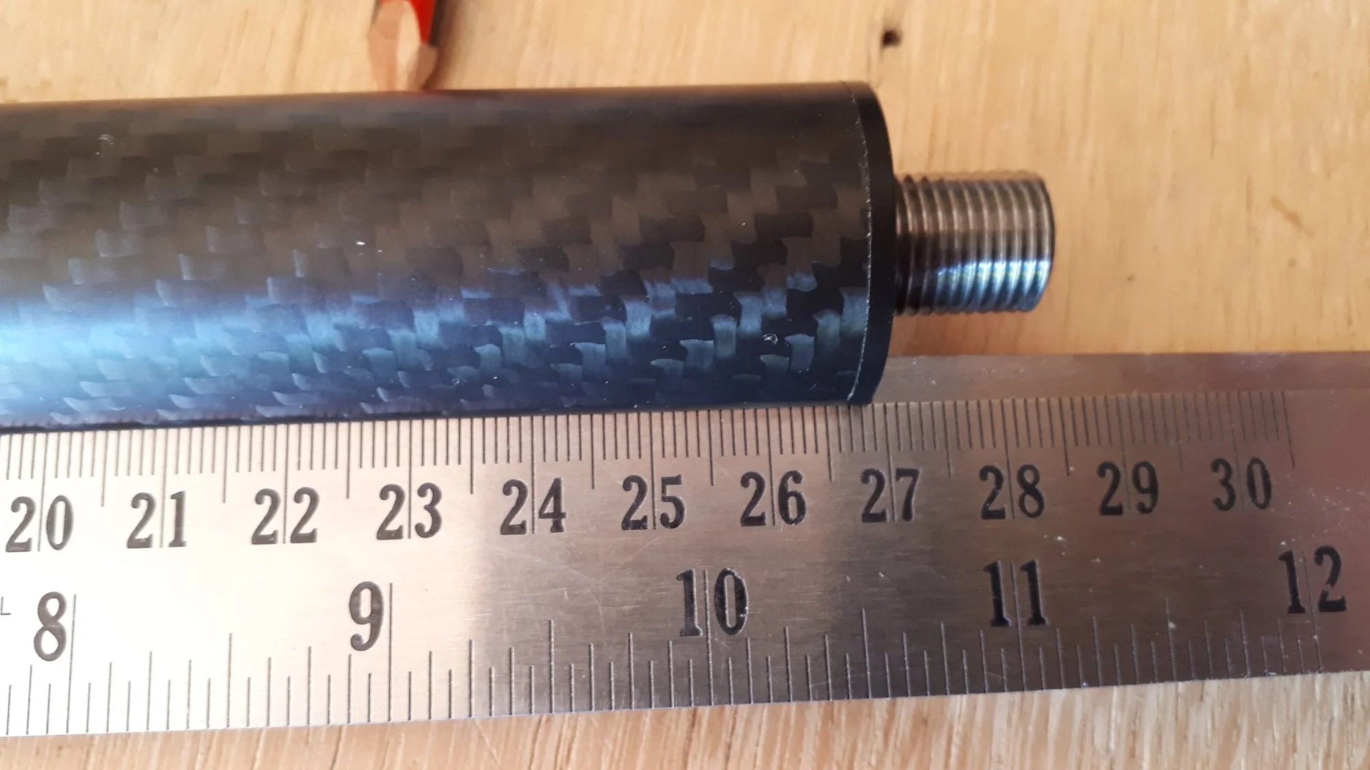

The solid barrel kits...................
Phil machines a solid barrel.
Screw cuts the mod thread. Crowns/recrowns the barrel as required.
For the FX Crown he machines the leade end to match the FX connector piece and machines a new leade. If you want he makes a new barrel inlet (the brass bit) to screw onto the solid barrel.
He makes a new cone piece to fit the Crown block and take the solid barrel with a seat for a carbon fibe tube. Machines a carrier for the other end of the CF tube to fit at the crown end.
It's a solid barrel, not sure what you mean by "floating".
A standard FX inlet will fit but normally I get Phil to make mine.
Not an active shroud, just a cosmetic part.
Anybody can place an order with Phil. Whether he has the capacity or not is another matter.
View attachment 718969View attachment 718970

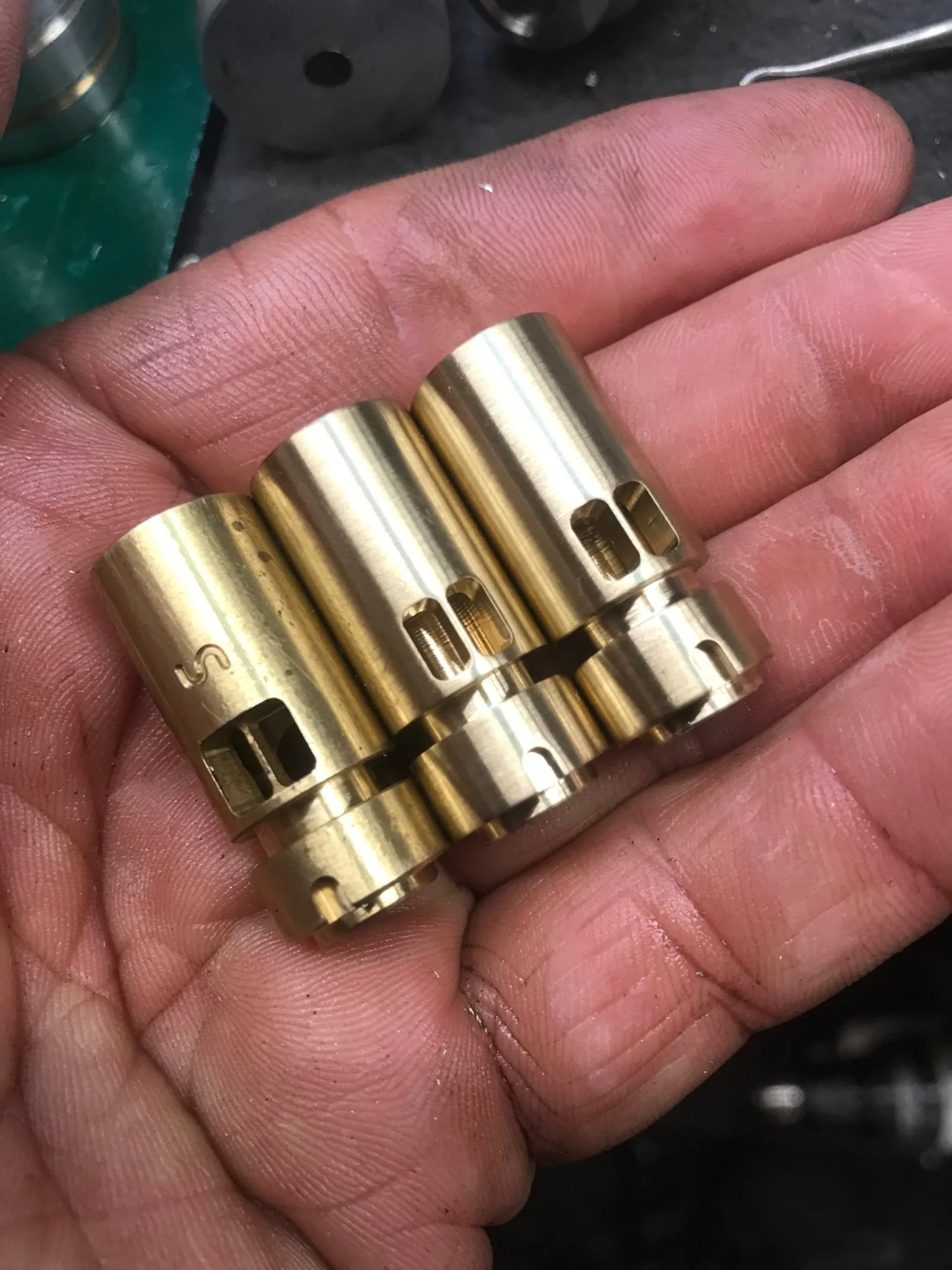

A few component parts for you here
I’ll do a build thread at some point for anyone interested

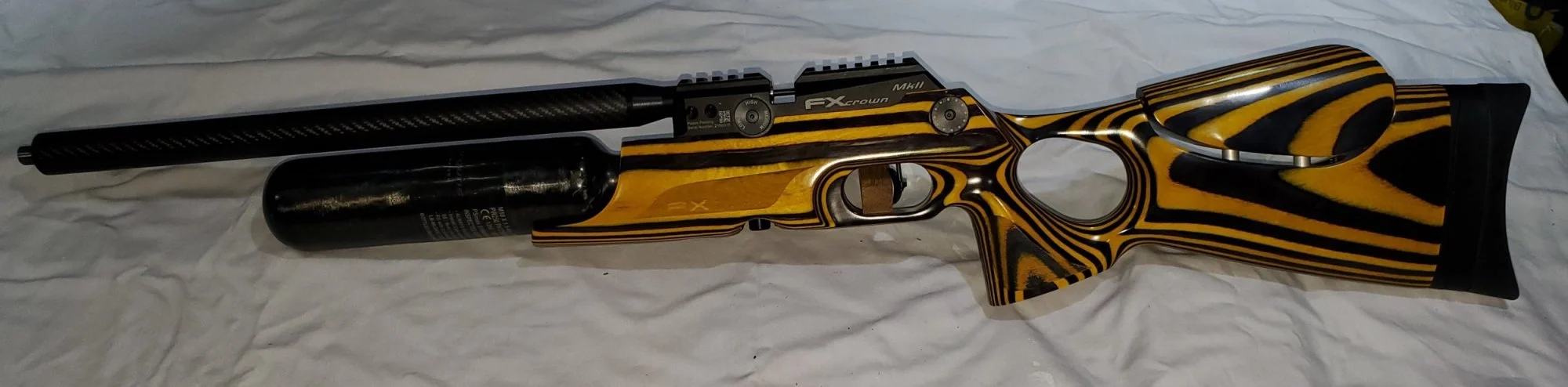

Here's the 500mm HFT 500 on it's new home.
View attachment 718979View attachment 718980
I’m not sure that looks long enough!!! 😆
I understand ‘floating barrel’ as only connected by the action’s grub screws (which it is and normal FX barrels are too - the difference being Phil’s are more rigidly held by the shoud). Non-floating would have a clamp around the barrel and end of the bottle like my Daystate…
Yep, thinking that Phil needs to add another 300mm to that barrel! 😆
