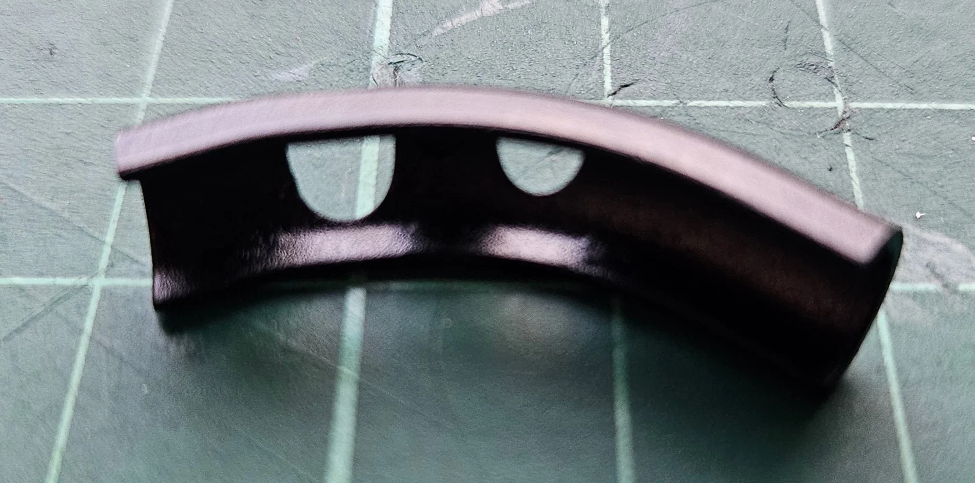

Right, well, done my magazine, what a fiddly, decking, ball ache, lol, that's a couple of hours of my life I'm not going to get back. Think it's worth doing though, should definitely minimise any feed issues or risk of jams with FS rounds.

As per the first video, my follower certainly had a rough, proud spot from the injection moulding manufacturing process. And as per the second vid mine wasn't exactly tight, but wasn't free and easy either, and if you played around with it, it would occasionally stick before it reached the end of the feed nozzle, which would certainly potentially jam the last round in the mag.
Dremeled, sanded and polished.

I didn't take any pics of it, but as per second video, where the round transitions from the mag body to the nozzle body there is a very noticeable lip, which could potentially tip the nose of a FS round down, and assist in creating a jam. So as per video this was dremeled, sanded and polished.
Seems to feed perfectly now, so I think well with doing for our purpose, which is purely feeding hard reusable FS rounds, it is probably to much spring pressure for frangible paintballs.
