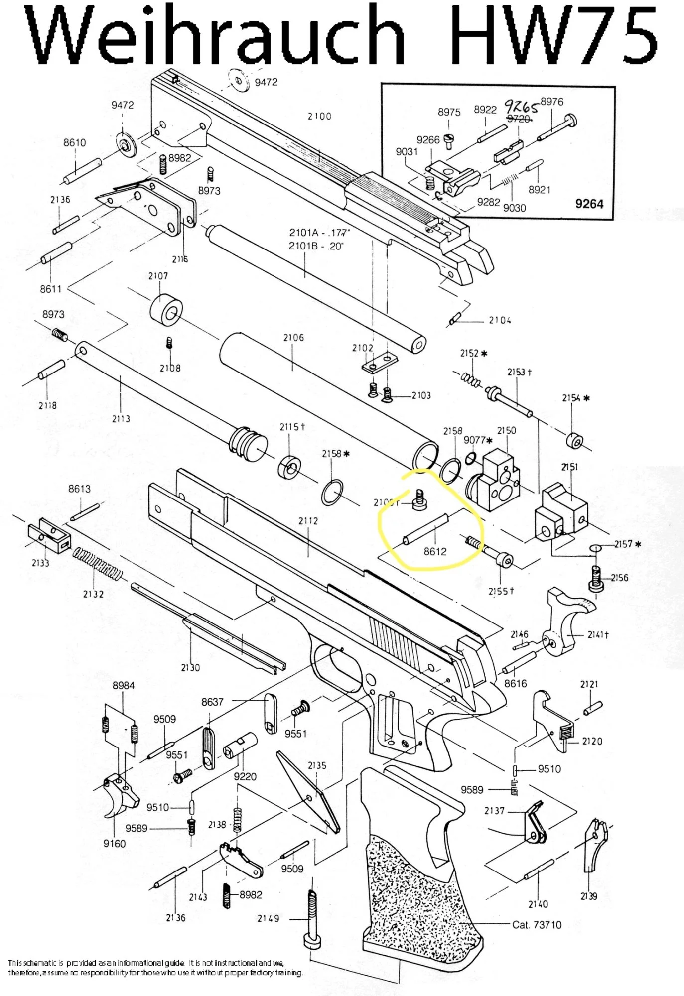

On the 75 you don’t need to touch the trigger - 2 pins takes the whole compression unit and rear chamber out
You could probably get away servicing all the seals just by removing the one pin highlighted - I did when I cleaned out my valve of old gunk

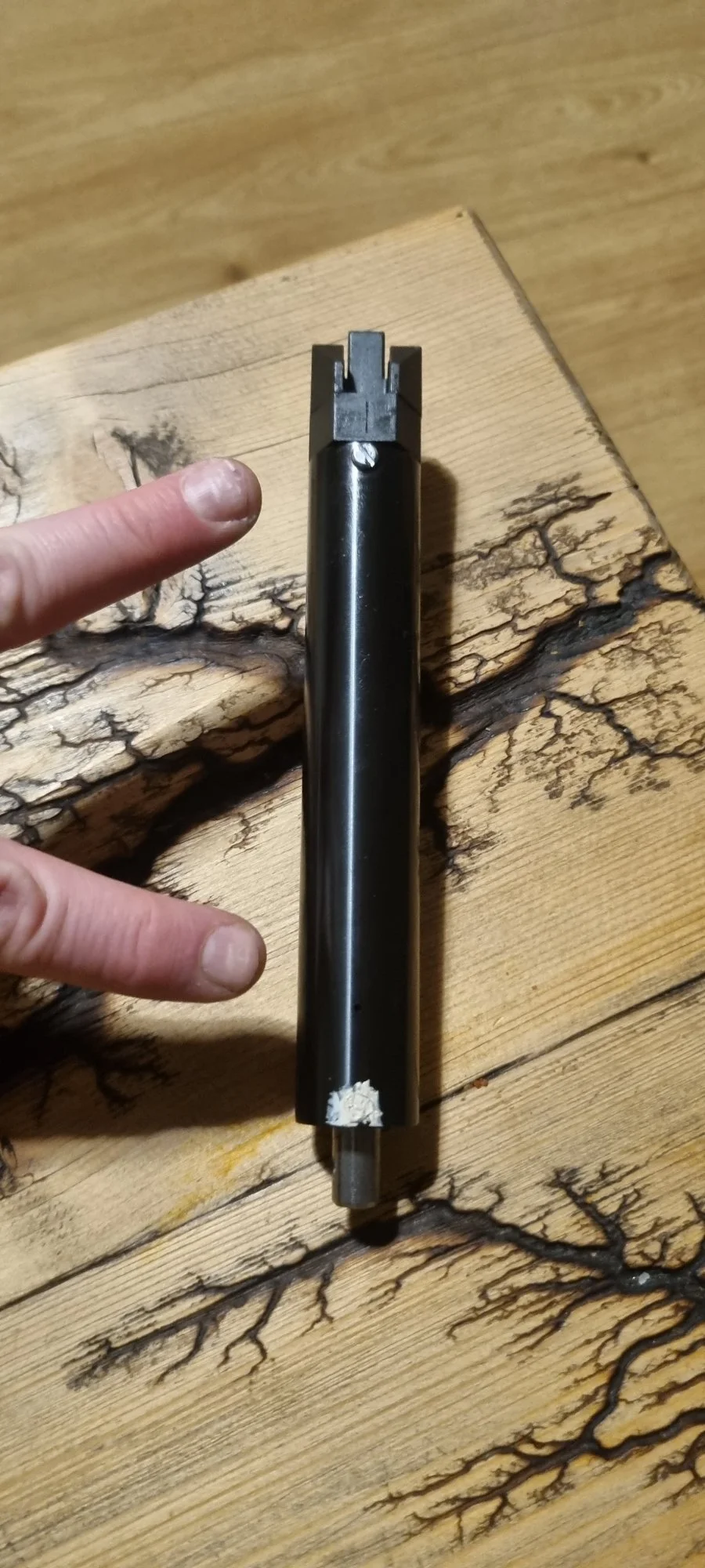

I've just removed the cylinder and valve assembly and I've been greeted by two areas which both look non original? I'm thinking someone must of had an attempt at working on this pistol before me?
The pistol is second hand purchased a few years back so I'm wondering what's going on here? One galv flat head that looks potentially non original and some kind of sealant/silicone applied at other end?

Make sure that felt washer is oiled
Check for any nicks or caught areas
Does anyone know if the white stuff on outside of cylinder is something applied at factory or possibly a bodge repair of something by previous owner?
