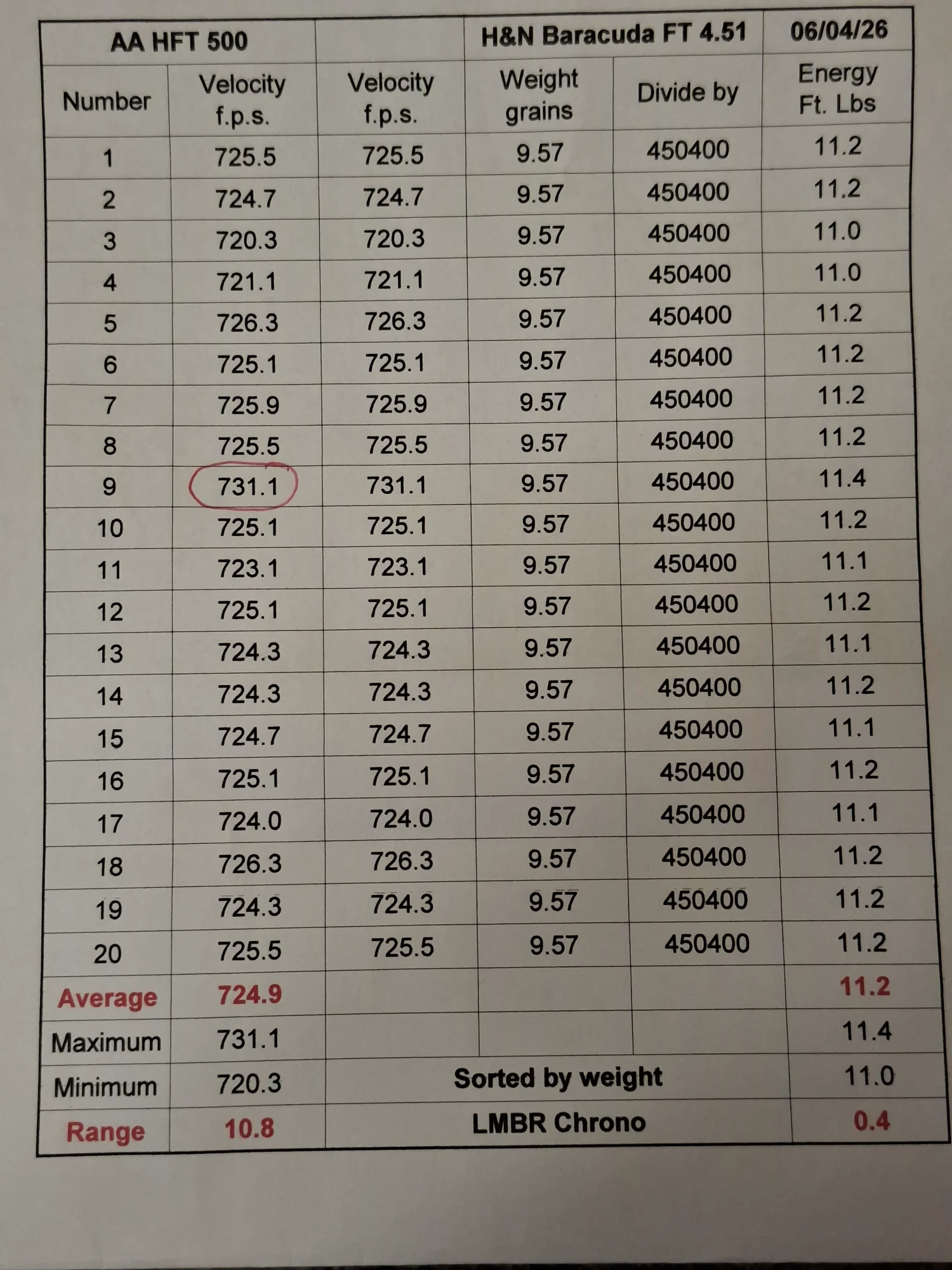

I regged one of my HFT500's myself.
Used a Lane reg.
Lightened hammer, ports opened up to 3.6mm.
The hardest part is the balance between Hammer and EV Springs.
I spent many, many hours to eventually get the balance right.
It takes a long time to run a full chrono string every time you make an adjustment.
Did it about 18 months ago, and it's been faultless ever since.
A mate of mine is now using it for NSRA benchrest competitions, as he was having trouble with his Walther, and he's more than happy with it.
Here's some chrono figures he did a few weeks ago.
If you take out the one high shot, the spread is just over 6.
Used a Lane reg.
Wonder what that was? Lovely string otherwise.
