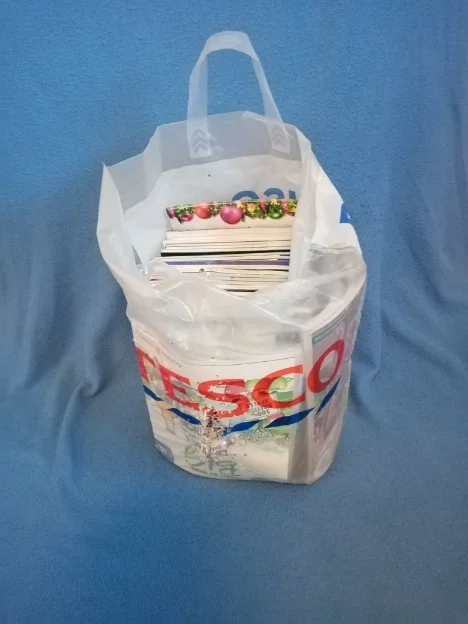

I use a carrier bag which is completely stuffed with junk paper.
Supermarket sales magazines are superb for this.
They give them away for free. . Fill yer trolley. :ROFLMAO:

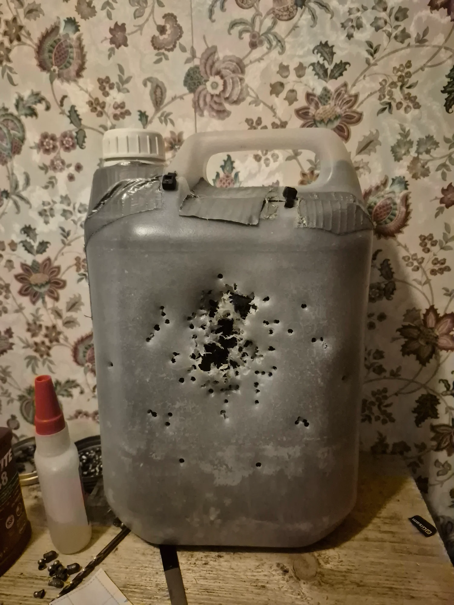

I use a stand metal funnel pellet catcher, but stuff it with old cut up t shirt bits, then old washing up sponges and also use a thick cardboard in the target holder slot with a few bits of cardboard behind that.
