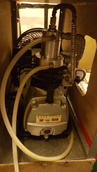

I went the Yongy way.
I added a water trap with home made water cooling,plus b 20241012_080600.webp20241012_080542.webp
locks of ice in the water,then a long silica gel filter.Molecular sieve would probably be better.
All in a 'wind tunnel'.
I use it for filling a 7L bottle-too much faff for filling straight to rifle
Touch wood it's working well (y)
Note to self-get the !2£$6 hoover out:D
I like the wind tunnel! Good idea. I just use a big fan on hot days and always stop my Hill at 65C.

I added a water trap with home made water cooling,plus bView attachment 585038View attachment 585040
I guess you have water cooled the pipe that joins the second stage to the water separator? I've recently been trying to cool that with a damp piece of wick material. It seems to make a difference. If I've guessed right, what material is the cooling tube- size, material where to buy it - any of that appreciated.
@colinb The 'hard pipe"between the second stage and the 'bleed block' has been wrapped with ally wire.I wanted to do it in copper(the top bit is) but it was work hardening too much while wrapping it.
I've wracked my brains to figure out how to make a water cooled 'wet' manifold/heat exchanger for the pipe,but have not come up with an idea I like yet.
I 've seen the'Hot Rod' vid on YT.
Water cooling the first stage is also in my head.Removing the carry handle has improved the airflow around it.
The 'whip' between the block and the water separater has the return pipe loosely cable tied to it.More to use as a good 'lead' than for any cooling.
I can't remember what temp it gets up to but I go from 200 to 300 bar in one go with no problem whatsoever.

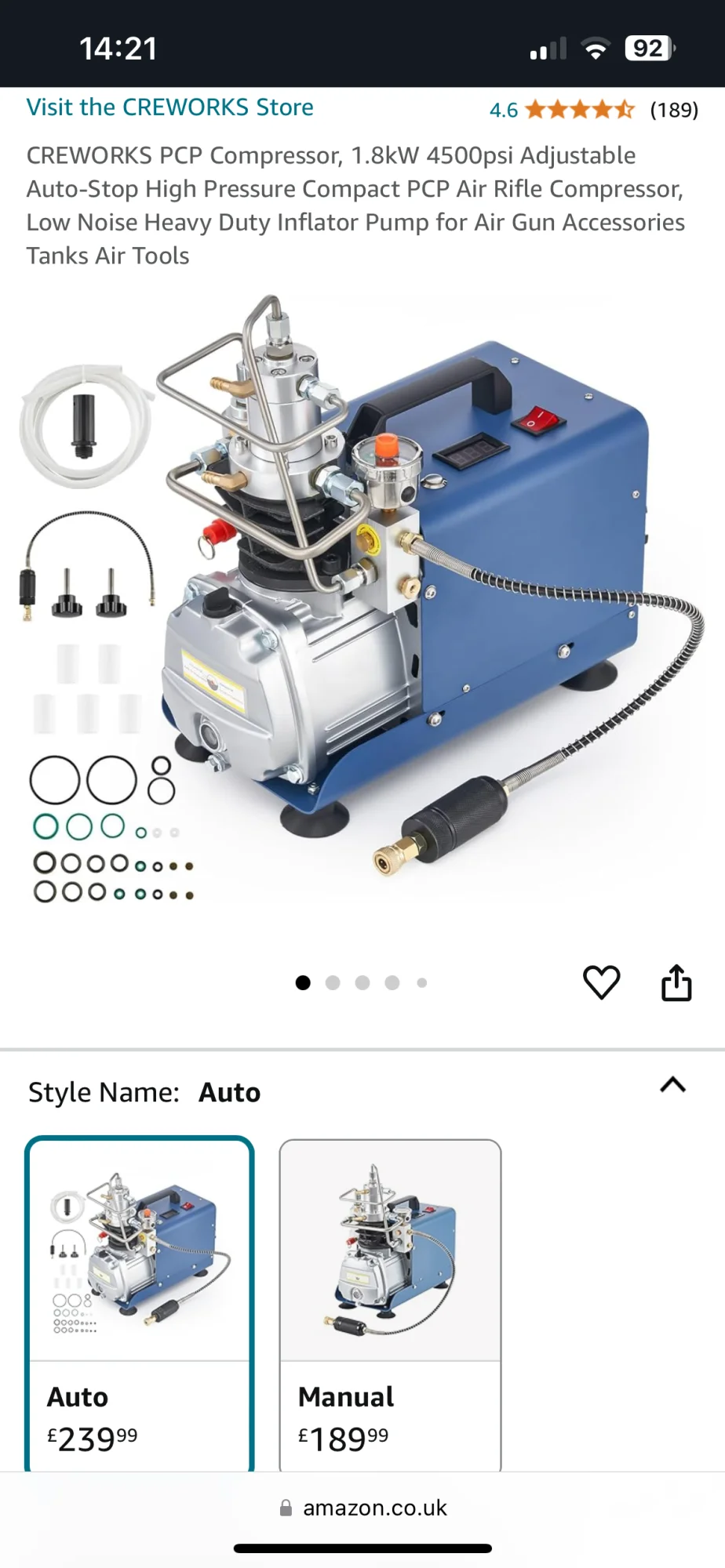

I was thinking of getting something like this but would it be ok to fit direct to my rifle to top it up to around 280-300 bar? It’s the auto stop model and looks similar to @Pegasus version. Or would I be better paying extra and getting something like the Wulf model? Sorry for the inexperienced questions but I’m new to the compressor world:unsure:

IMHO,the version of the Yong Heng in the pic,is better than the one I have.
I believe that there are two water drains on the one you show.Mine only has one.
More pipework so you can add more cooling wire/fins if you wanted to.
The disadvantage of the Yongy is that it's a faff to set up,requiring a tub of water,preferably with some ice in it.

If you go for the Yongy,again IMHO,more filtration than the supplied 'after filter' is desirable.
The consensus of opinion is that you don't restart the comp while it's under pressure.My opinion is that it's not a good thing to stop them under pressure as well.
Warm up-warm down.
I have no experience with the Wulf so cannot comment.
Good luck with your research,and your new purchase when you decide(y)
I got a Yong heng and after having a small tuxing this is unreal for filling rifles it tops up a 480cc bottle from 100 bar to 200 bar in under 1 minute.
I got it off eBay as a creworks but I thought it looked exactly the same as a genuine Yong heng so took a gamble and it turned up with a sticker on the side saying manufactured by Yong heng.
It also turned up in 3 days and the price was okay it was £200 for the auto shut off I got but I think £160 for manual and to be fair I don’t use the auto shut off.
The Wulf is a Tuxing silicon jobbie in Wulf's clothing I believe.
Either will do gun only. The Ying Tong produces a lot of air very quickly so you will need to be double dog dare careful if filling direct to gun without an auto cut off.
The Ying Tong will fill dive cylinders, I would not use a Tuing silicon type for dive cylinders.
Using a Ying Tong for gun only fills would not need a large cooling water supply, because it would not be running for very long.
