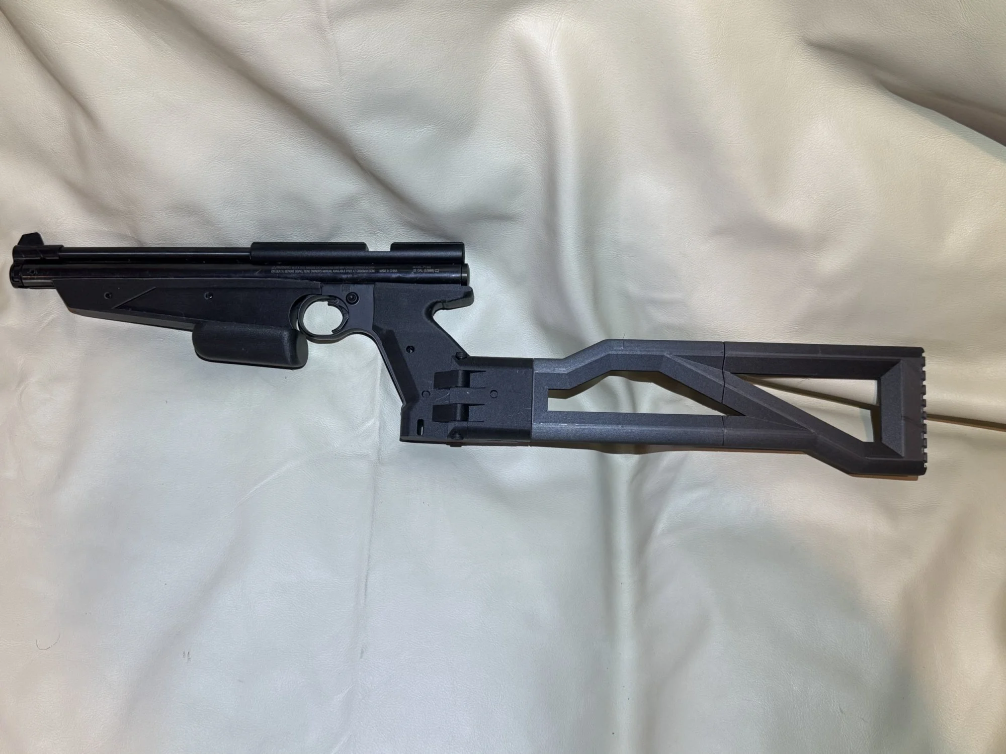

3d printing pistol grips.
Got it.
Printed a second set.
Came out good.
Printed grip from Cults, just testing if it will fit properly. First attempt was PLA-CF but filament jammed mid print. That filament is abrasive like sandpaper and does not flow very fluent through my long filament path. Also Dragon HF with stealthburner is not best possible combination. I was too lazy to remove top cover and load filament straight to extruder. Printed then second copy with plain ABS, the one installed on GK, it worked out better. Carbon version is better on esthetics and also it is grippy, not at all slippery, like ABS handle being shiny smooth surface.
I like stock wooden grip too much to switch, but maybe I'll take only gun body fitment measures out of the stl model and draw something of my own later...

Shinier one, ABS is Creality brand, matte one, PLA-CF is Copymaster, Ash-grey. Brown effect is from lighting, surface is kind of shimmering matte. I like how fibers hide layerlines almost completely. Print layerheight is 0.2mm.

I had a spool of graduated silk pla, so decided to just use it up and did these grips for fun.. and the matching pump handle is printing as I write this. Not to everyone’s taste, or even mine, but why not, and all in the spirit of testing!
