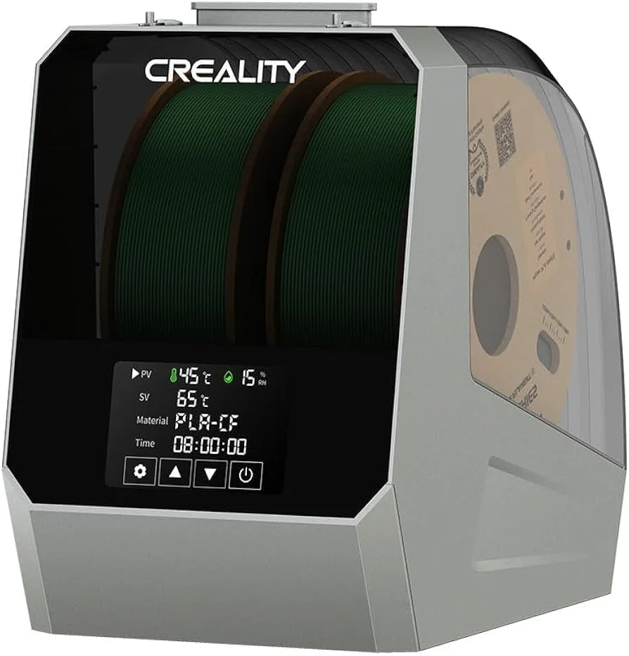

I have this creality drier and you can feed from it into the printer as an external spool. Holds two reels.
That's exactly what I do.
The filament doesn't even see the atmosphere from roll to tool head/hot end.
