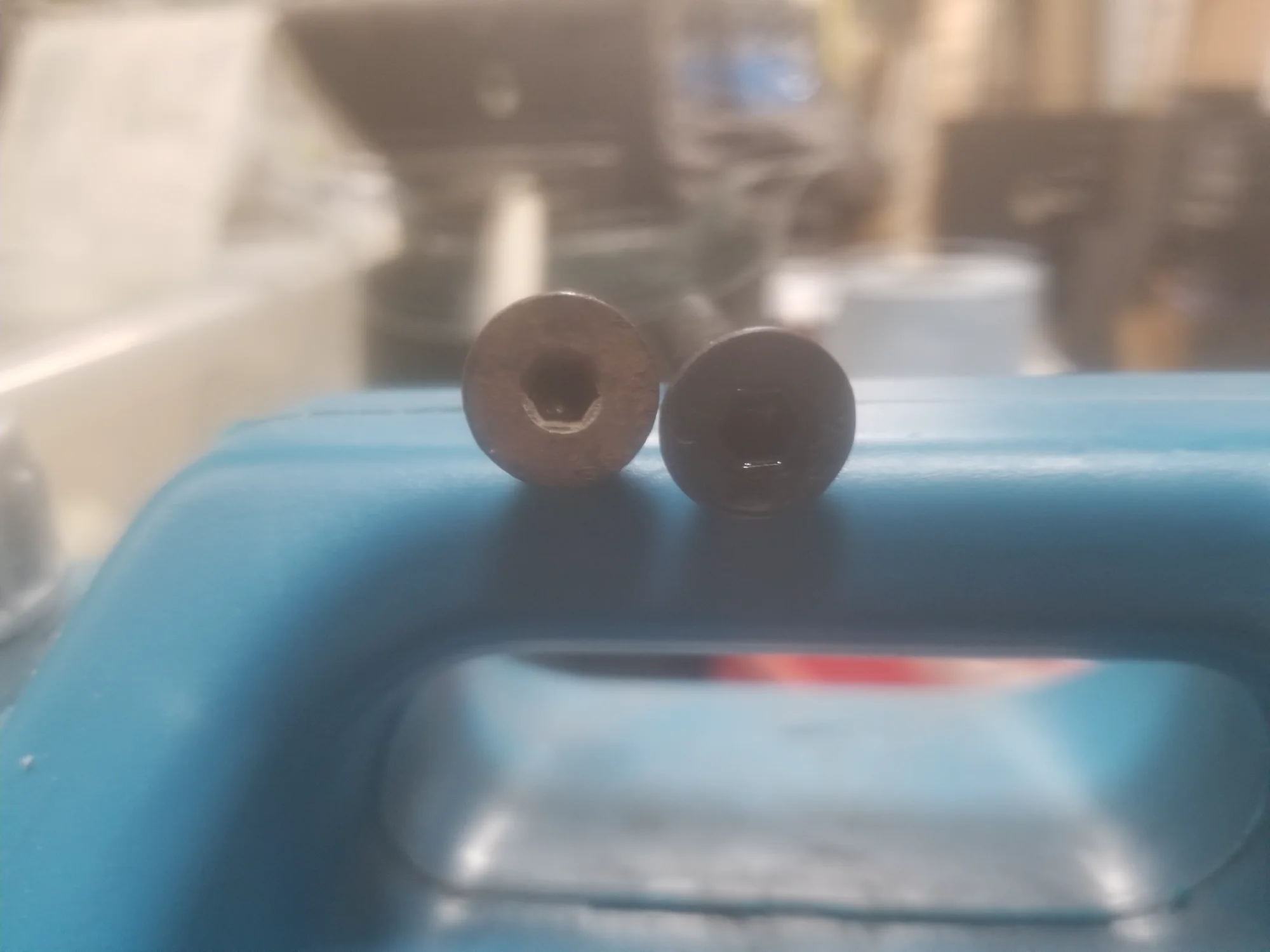

Not made, but after explaining to a colleague who has moved to Norfolk 🤷🏼‍♂️, how I restore the various blacked bolts on our Pro PA Speakers, he asked if I could do some for him as he wasnt confident in tackling it! I agreed, expecting 20 or so bolts, he sent this!
A bit more than my bench wire wheel is normally used for 😳
A quick soak in Hydrochloric acid solution
And we get this
Rinsed in clean water
, then straight into the Koldblak tank
Then another rinse in water
before going into an overnight oil soak
Heres a before and after side by side, the rest are soaking in a half gallon of mineral 2 stroke oil for the night

I tend to use a hot ultrasonic cleaner with various standard chemicals to clean rust and crap off of things like that. Finished by a oil bath. Works for most things but not everything.

I dont have an ultrasonic bath, I dont usually use acid, it was only because of the volume that I tried it, very quick, probably took less than half an hour to de rust all the bolts and get them in the Blacking solution, must be over a kilo of bolts, it took over 2 litres of oil to cover them in a bucket!
