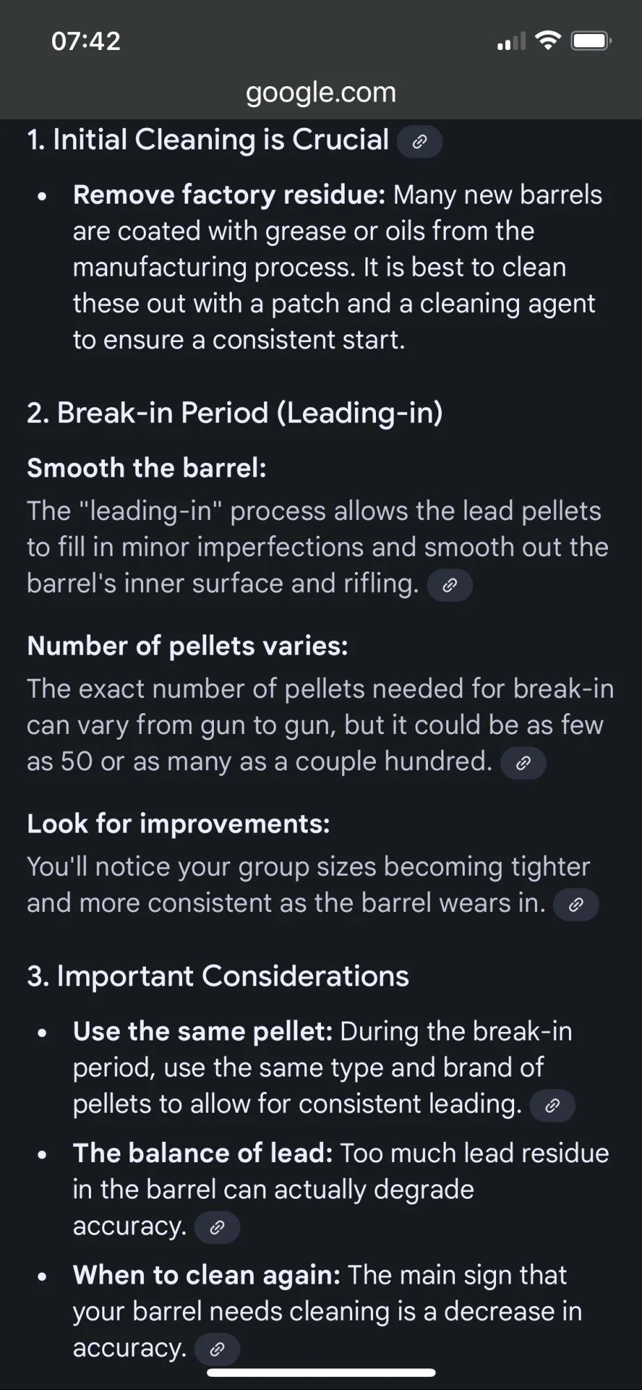

I don’t know if I’ve actually given this much thought before as it’s so infrequently I actually buy a brand new gun.
I thought I’d ask Google AI and this is what came back. I’ve not screen shot the first part which basically said that yeah, barrels need leading in. I’d have thought we all knew about point one but what do you make of points 2 and 3? Are there loads of imperfections that need to be filled and what about using the same pellet?
What you reckon?

I’m on the fence Karl, cleaning a new barrel is essential but the bit that got me was using the same pellet. I’ve owned my Taipan less than a week and must have put 10 different pellets through it…
Not sure I get the minor imperfections thing either. Wouldn’t that just be dragged out every time the barrel was cleaned? Should a quality barrel have these pits?

It mentions leading in and smoothing the barrel, interesting, maybe a barrel polish is the way to go?
