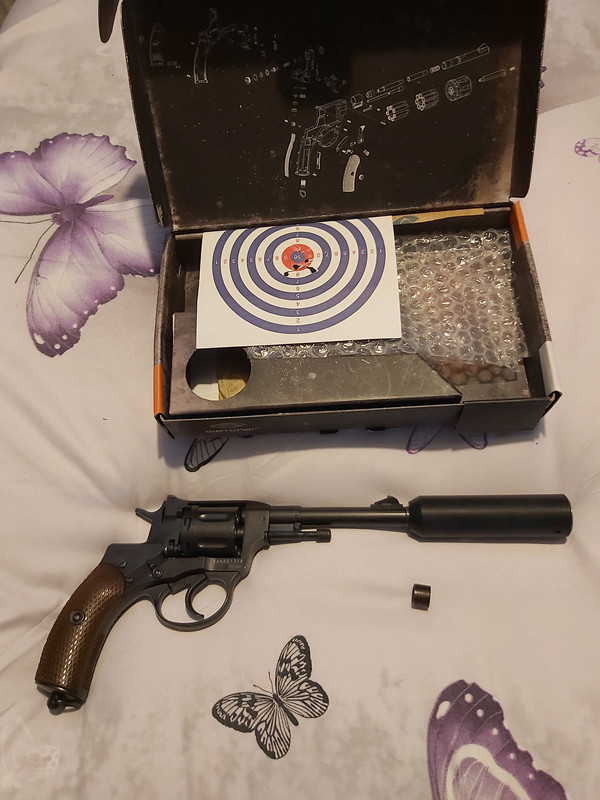

I've made a silencer for a Nagant revolver but it uses a steel liner loctited inside the barrel which in turn supports a 1/2 unf adapter that incorporates the barrel stop.
Complicated but it was important to me that it was strong enough and aligned perfectly.
The problem with threading the original barrel is that the pot metal is relatively weak. A better option maybe is to make a steel threaded insert that could be glued into the barrel recess with Loctite, and aligned with a silver steel rod while the loctite dries.
The insert could either be threaded internally and a 1/2 unf adapter made or a simpler externally threaded 1/2 unf insert
