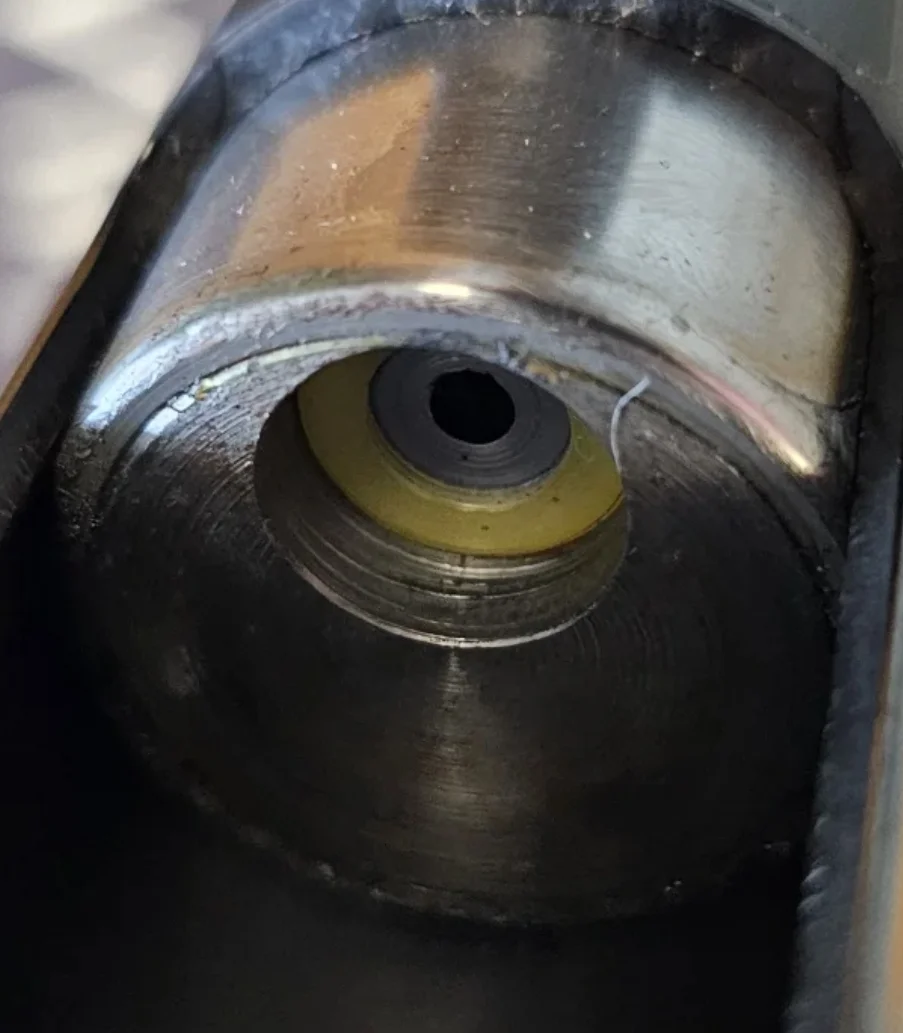

At that time, Venom weren't making their own green seals, so the seal should be a standard HW thin lipped seal, or a factory seal reprofiled by Venom (if the original internals are still as they were)

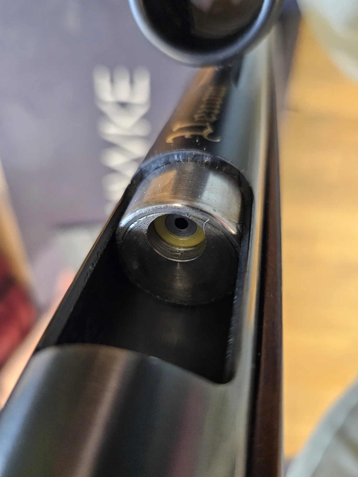

Defo looks to have an original spec breach seal and not an aftermarket one.

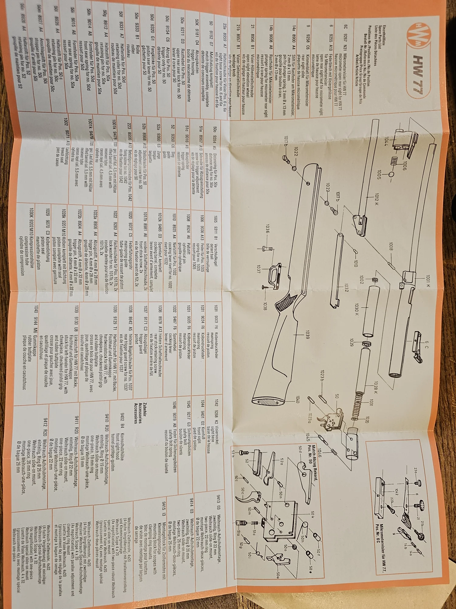

But generally just nice to get one with some paperwork tracing its originality. Oh and original Weihrauch manual ta boot....
View attachment 960108View attachment 960109

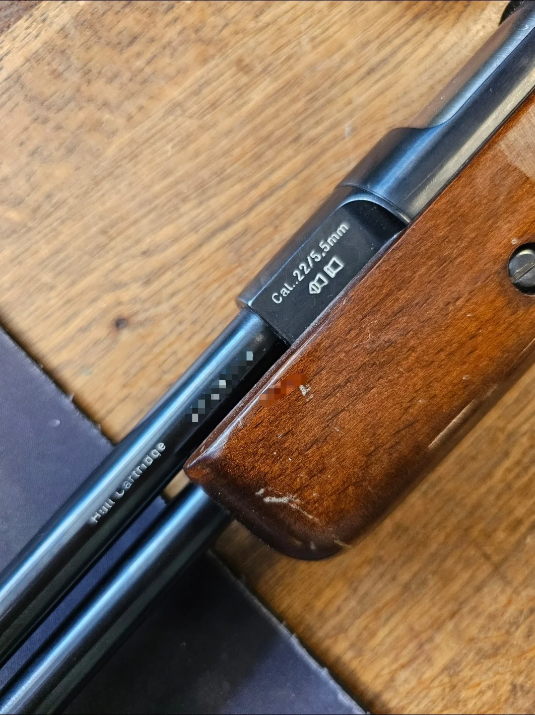

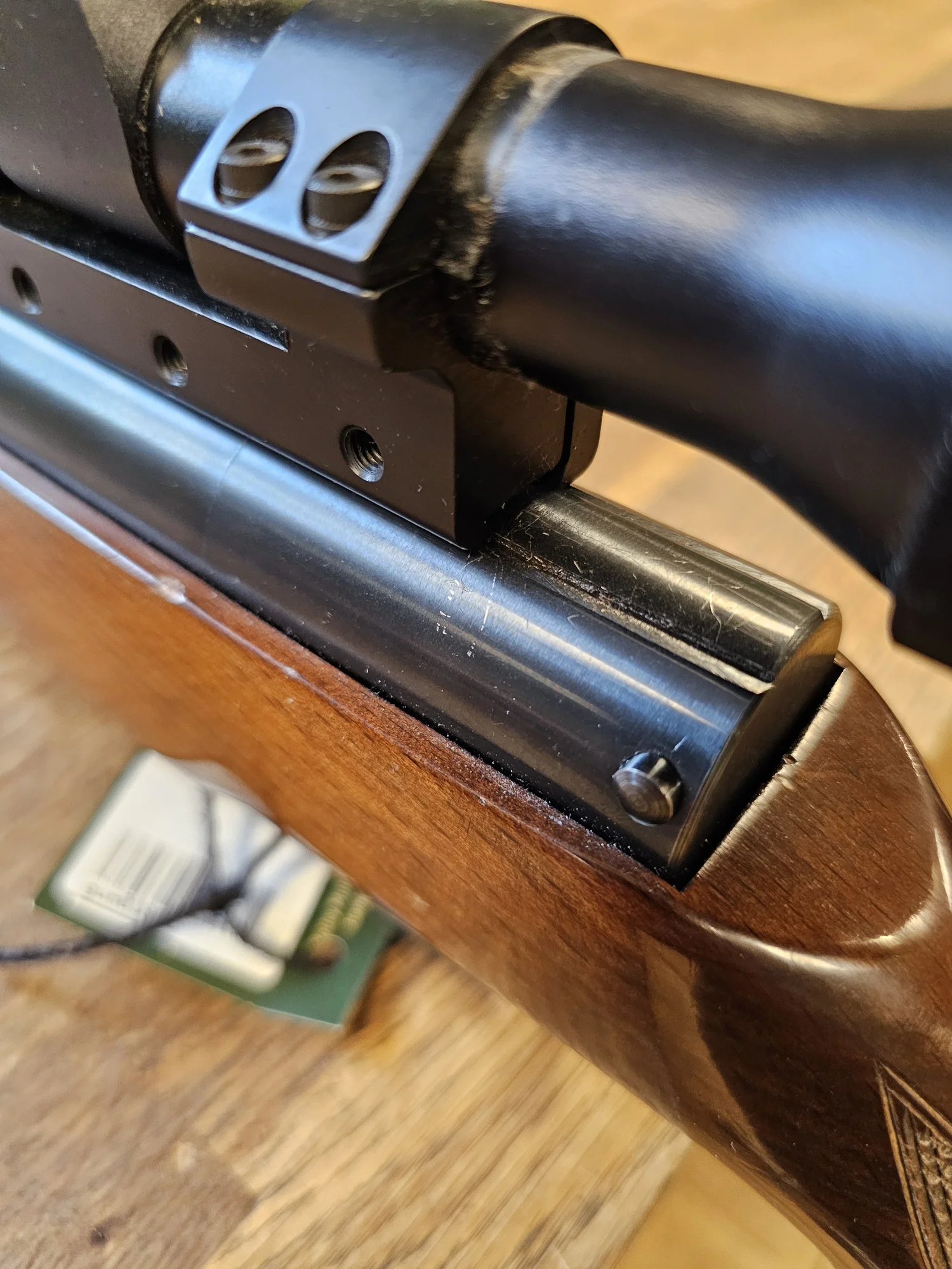

Worth measuring the TP diameter as from the pics, it looks bigger than standard. Something that had been done on mine so very in keeping

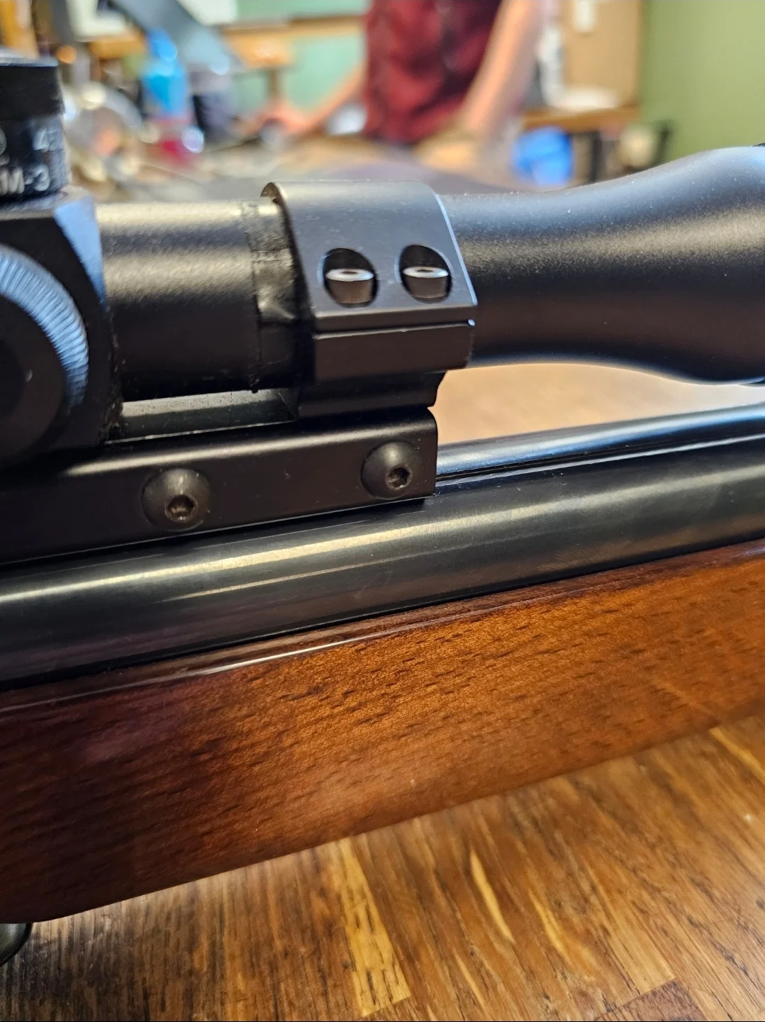

And if I were you, I'd get that tape off from under the scope rings, clean the scope tube and mounts up, and refit securely. Looks like the scope's been moving

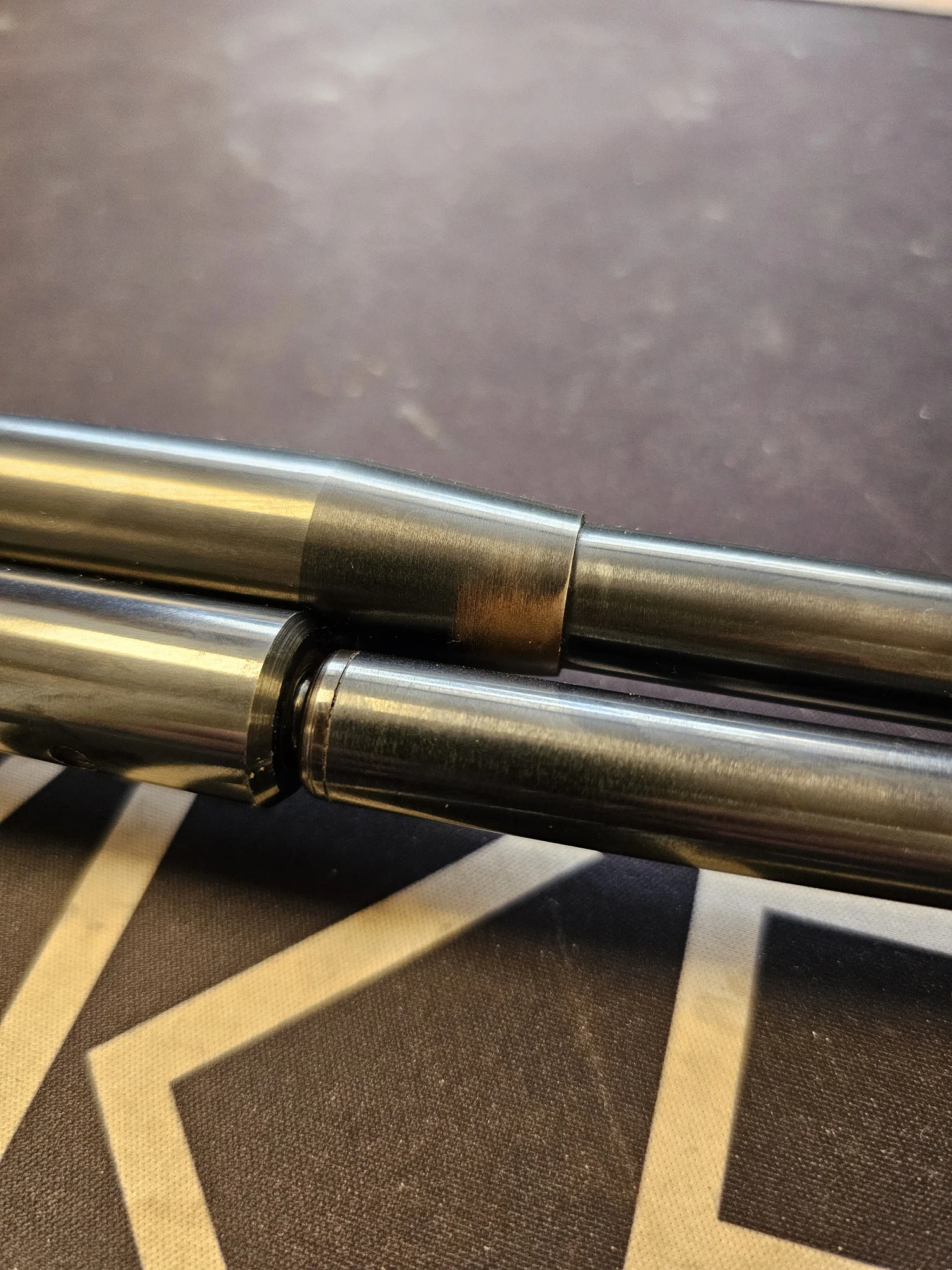

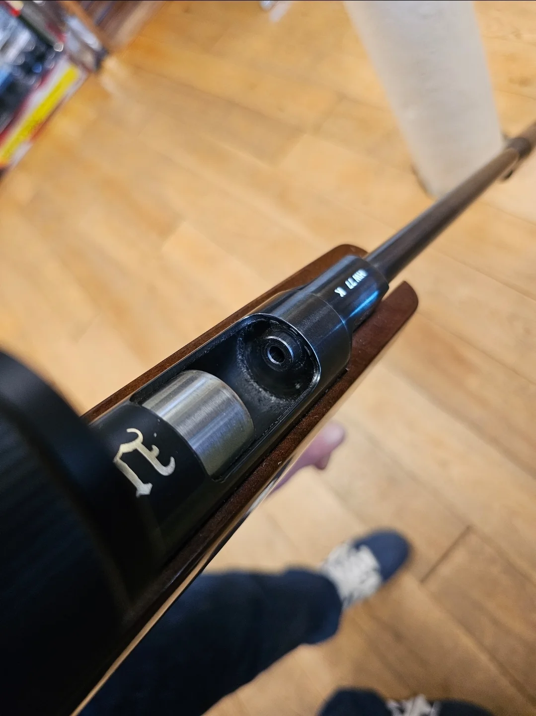

Do you realise thats a newer 26mm piston?
Not until, now, hence the need to post the pics for help... I get what you mean about the groove, yeh indicates a 26mm...
Im joking 😂
The groove does look different to a 26mm tbh... but like Isay, hopefully more info from current owner before collection from RFD.... and a great RFD at that...

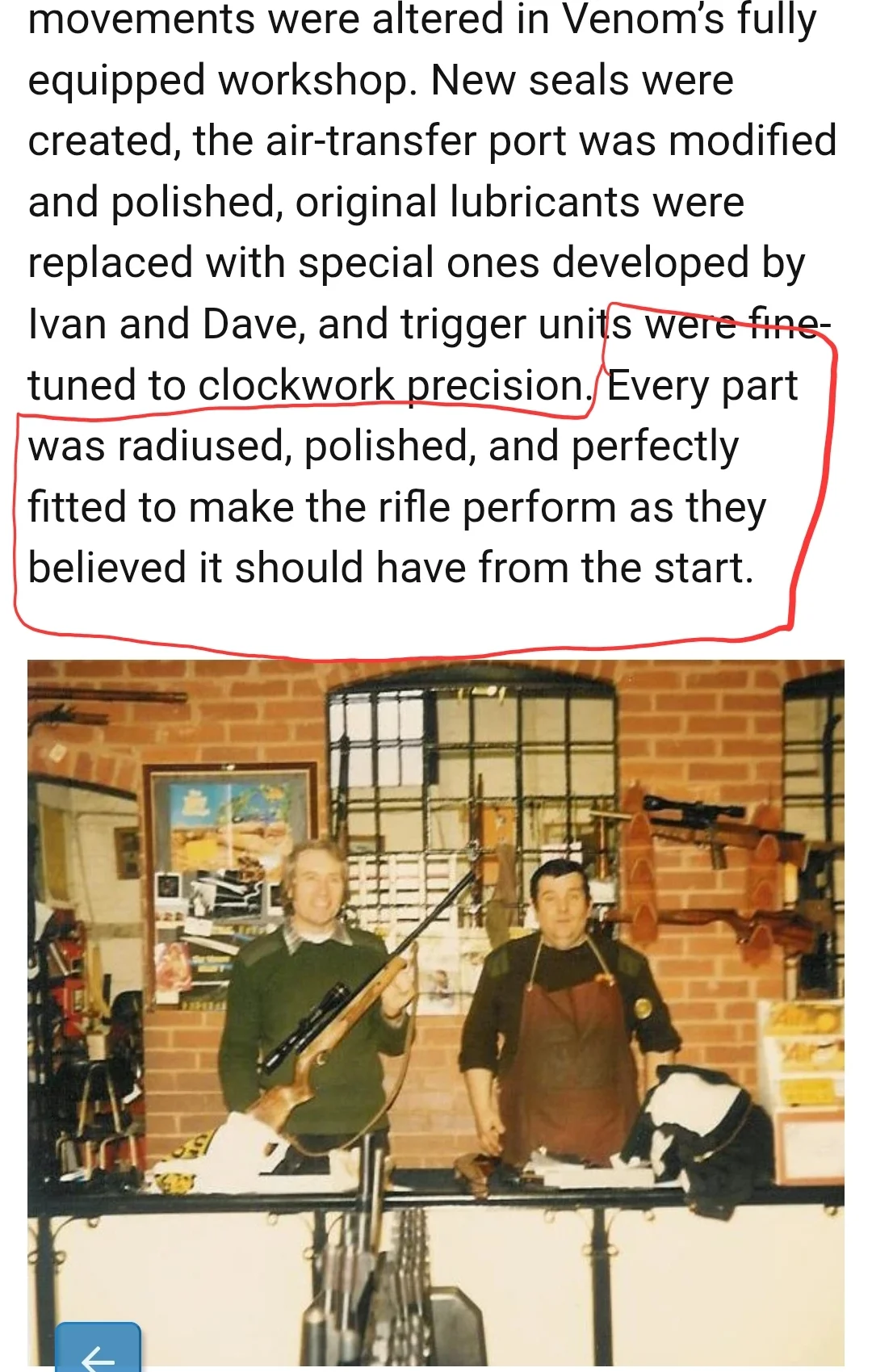

Obviously buying this is like a surprise Easter Egg, not knowing everything till it's cracked open...
But the Slueth in me sees...above..
If just a spring and guide conversation surely a standard piston & comp will still fit?
Add the, "NO Internal lubrication of any type, must be used"... surely points to their glided piston or special piston seal?

A worthwhile debate on the 25 or 26 mm piston too
It looks 26mm to me from the pics provided above.
Not wishing to pee on your chips but here is a side by side comparison where the 25mm comp tube with the thicker wall shows that the TP inletting almost bisects the front face of the tube whereas the 26mm has an obvious area where the TP does not.
It may be worth a double check prior to paying up for something that is not as anticipated.
I’ll caveat this with it’s my view of the images shown above and happy and hopefully to be proven incorrect. 👍🏼
Edit: a pic of my Mk1 77 25mm comp tube fit further reference.

Tbh my V pic might be deceiving as original pic shows edges of comp tube more 'rounded' giving the illusion of a 26mm tube.
At present, work done on this by Venom is unconfirmed based on my post above...regarding standard parts not fitting etc..
But now begs the question, what if any work has been carried out on the comp tube to validate the edges being rounded from standard?
Getting more n more interesting 🤣
Looking at the correct orientation of the pic, shows it more like a 25 with rounded edge..

There was some lube evident at bottom of chamber, clean as if recently applied/serviced ?

just found from the Recent Venom Post...
Venom Arms Company Story, currently running on here too.
That now explains why the Comp tube may look 26mm 🐼👍🏻

If it has a fixed guide factory or other springs won't fit
The lube thing. They used their own lube, which will be evident when you open it up
Easy way to check if its glided, drop the stock off and you'll be able to see a wider rear bearing on the piston, with a bush / bolt fixed in it, that runs in the cocking slot to stop the piston rotating.
If it has that wider rear bearing, the comp tube will also be shortened to accommodate that

Yeh im aware of that bud, just cant take the stock off yet, until I get permission from RFD/owner whilst in there, on collection. But hopefully current owner/seller will pass full info on details etc, as other stuff with it too... but nice it comes with the correct Venom branded scope.
Obviously it has signs the Comp has been Venom'd.. so its just a case of where in Venom technical conversion history does this one sit...
But as stated above, I'll be happy either way, as long as all parts are correct as done by Venom, glided or not...as this appears to just be pre official Lazaglide roll out with the stickers...
