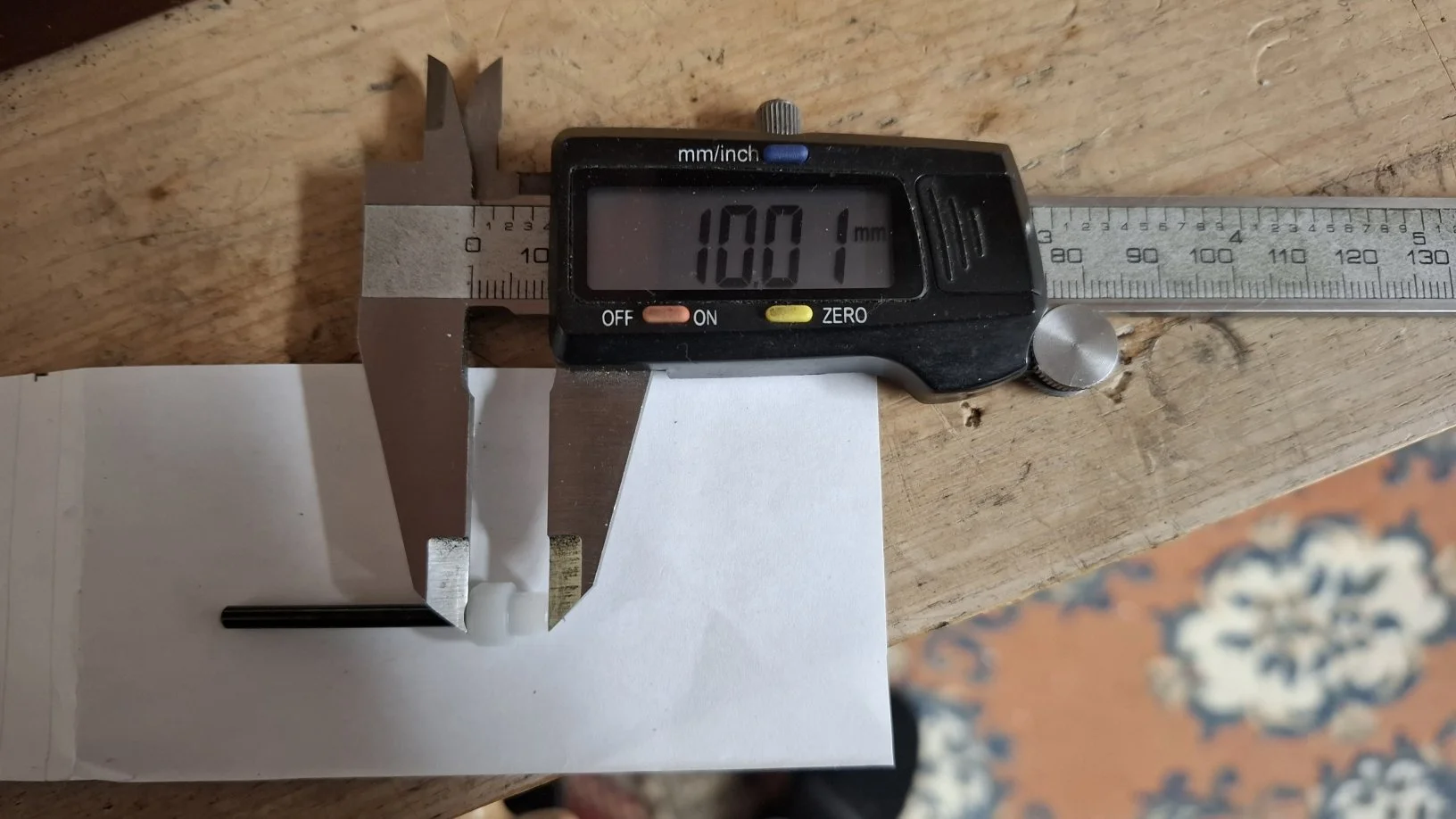

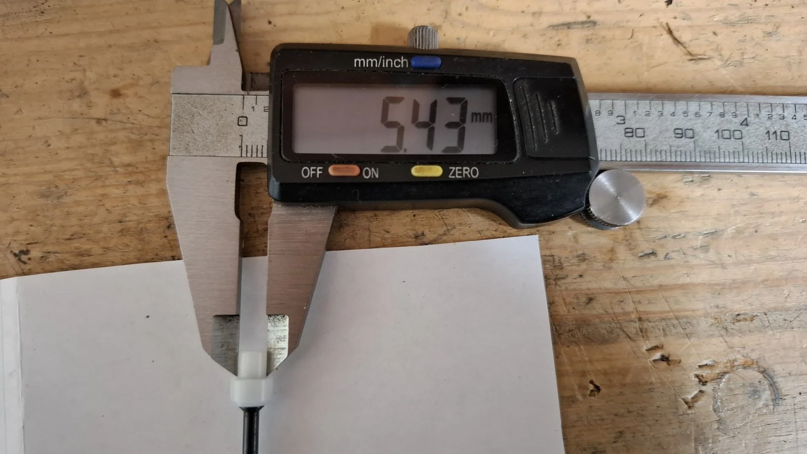

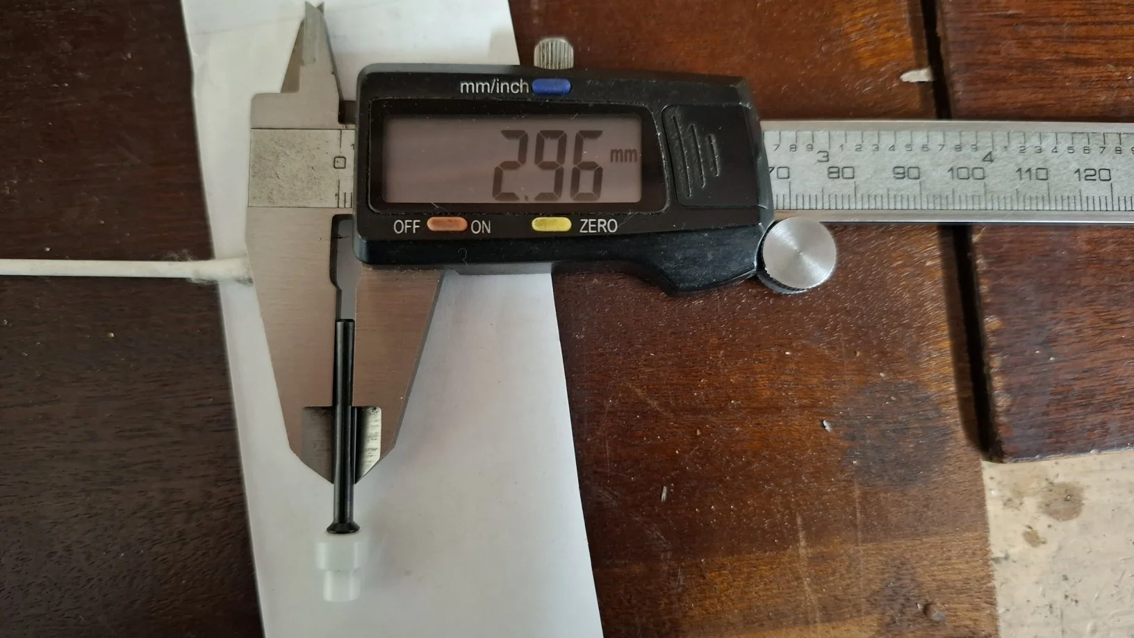

I've got one here that I've been saving for a rainy day.
20241116_190930.webp20241116_191244.webp20241116_191429.webp20241116_191731.webp20241116_191939.webp20241116_193719.webp
Difficult to measure the angle of the seat, but about six months ago I turned up a spare brass transfer port, and I'm pretty sure that I remember setting the compound at 30 degrees to cut the seat.
One day I might even get round to making some myself, but I've got quite a lot on at the moment. Hope that helps.

No worries, tried B&K bit been out for ages and not seen to going to replenish. Thank you for letting me know ow anyway and at least I got measurements now should I find someone that can fabricate one. Thanks again
