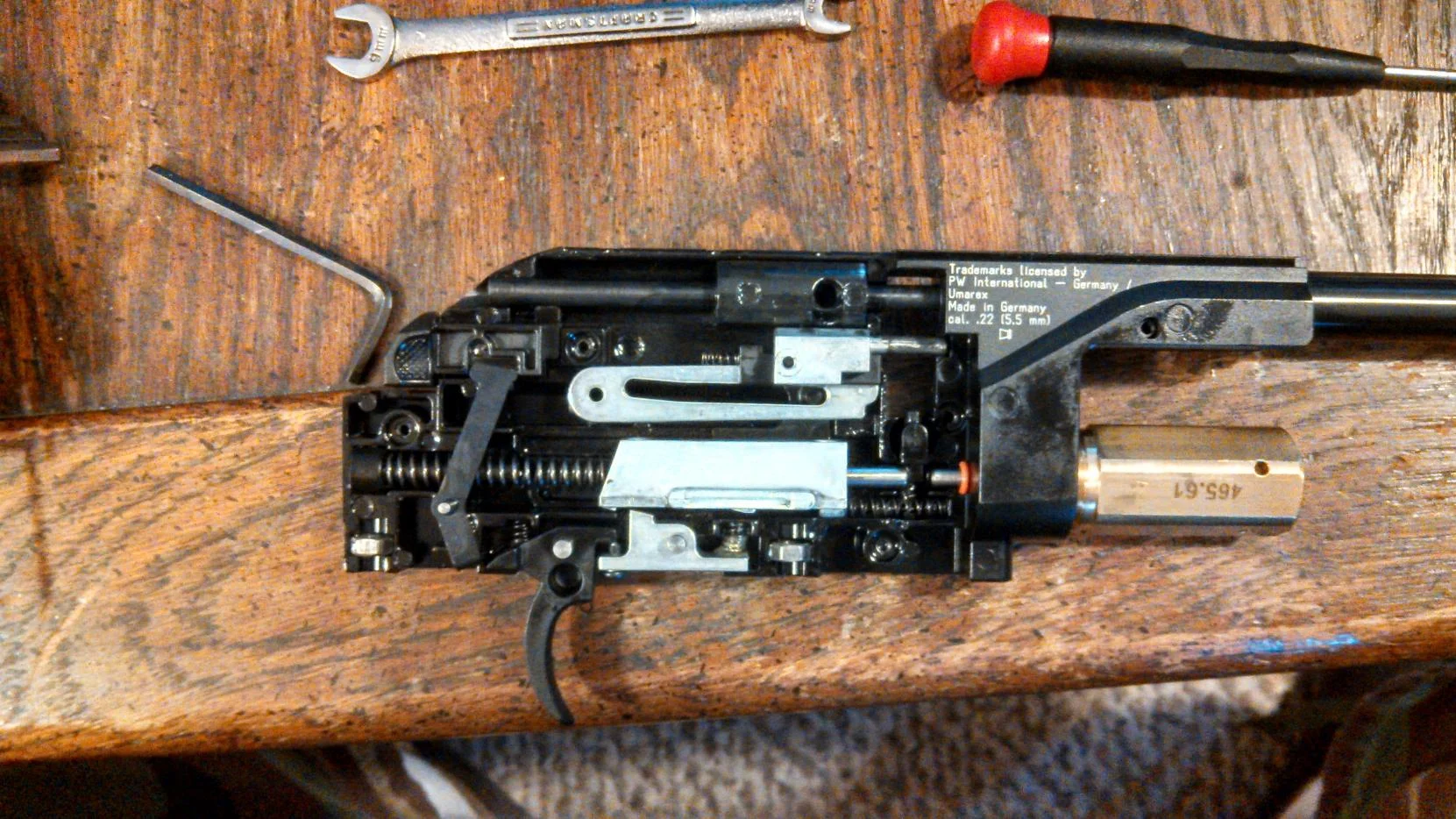

just some picture i have save from others
you will notice in the bottom picture the owner added a roll pin for a better trigger fell on the front of the trigger
once the cover is off the parts stay put and the long spring in the middle back is the hammer spring as you would think
