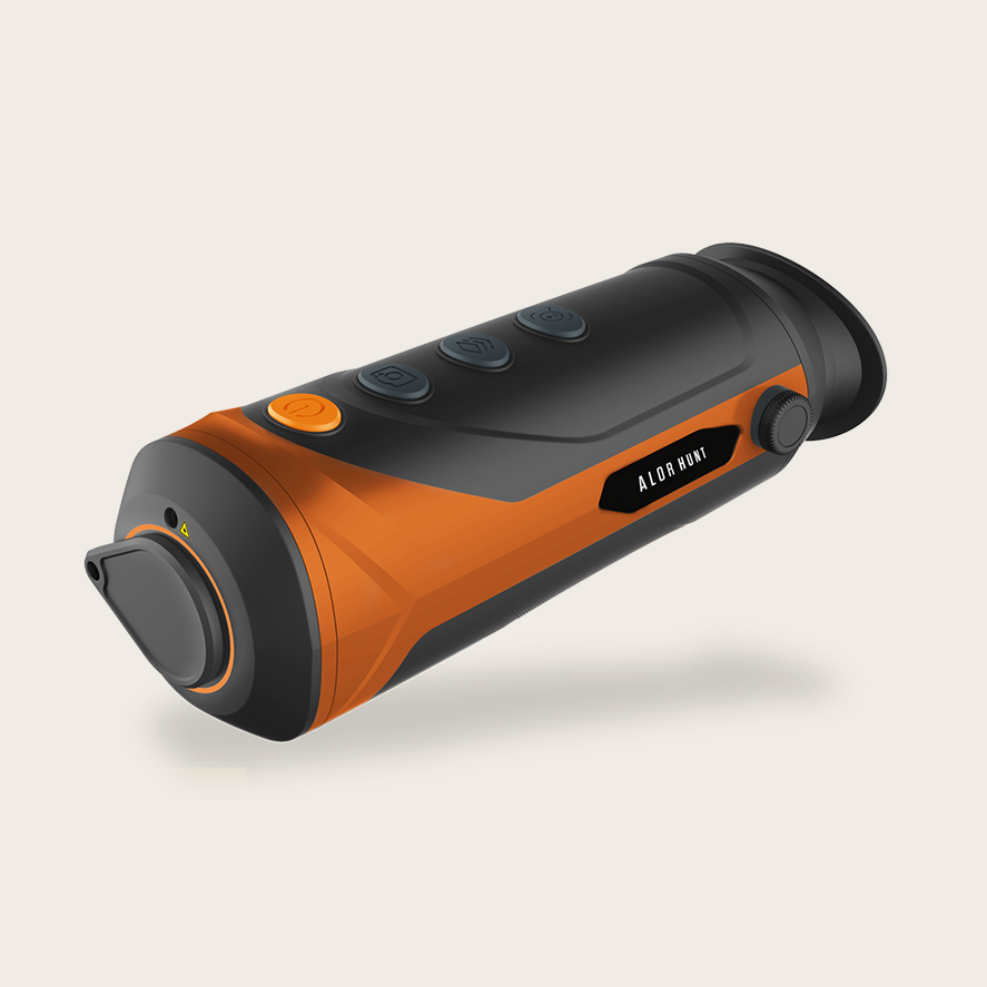

So in my hunt for a reasonable spotter I’ve come across a brand called night pearl. On there website they have a 15mm lens version on sale for 360 quid which seems too good to be true. Anyone had a good or dealings with the brand ? Model in mention is a ln alor hunt 15
I’ve seen this mate didn’t know if anyone had hands on experience with one
Your best getting hands on with thermal units / brands before committing
find a decent retailer who has demo units available to try
the good thing about thermal it can be used both day and night so you can always get a good idea of what a particular unit is capable of detecting is and image clarity
Bright sunlight and moisture in the air are thermals biggest issue in regards to performance some brands at lower end prices deal with this better than others granted some of the higher end stuff can cope with dire conditions also
Warranty, Service & Backup also needs to be considered they are electronic devices after all 👍🏻
Try before you buy 👍🏻 don’t rely on YouTube reviews to give you all the answers 🤣🤣😉
