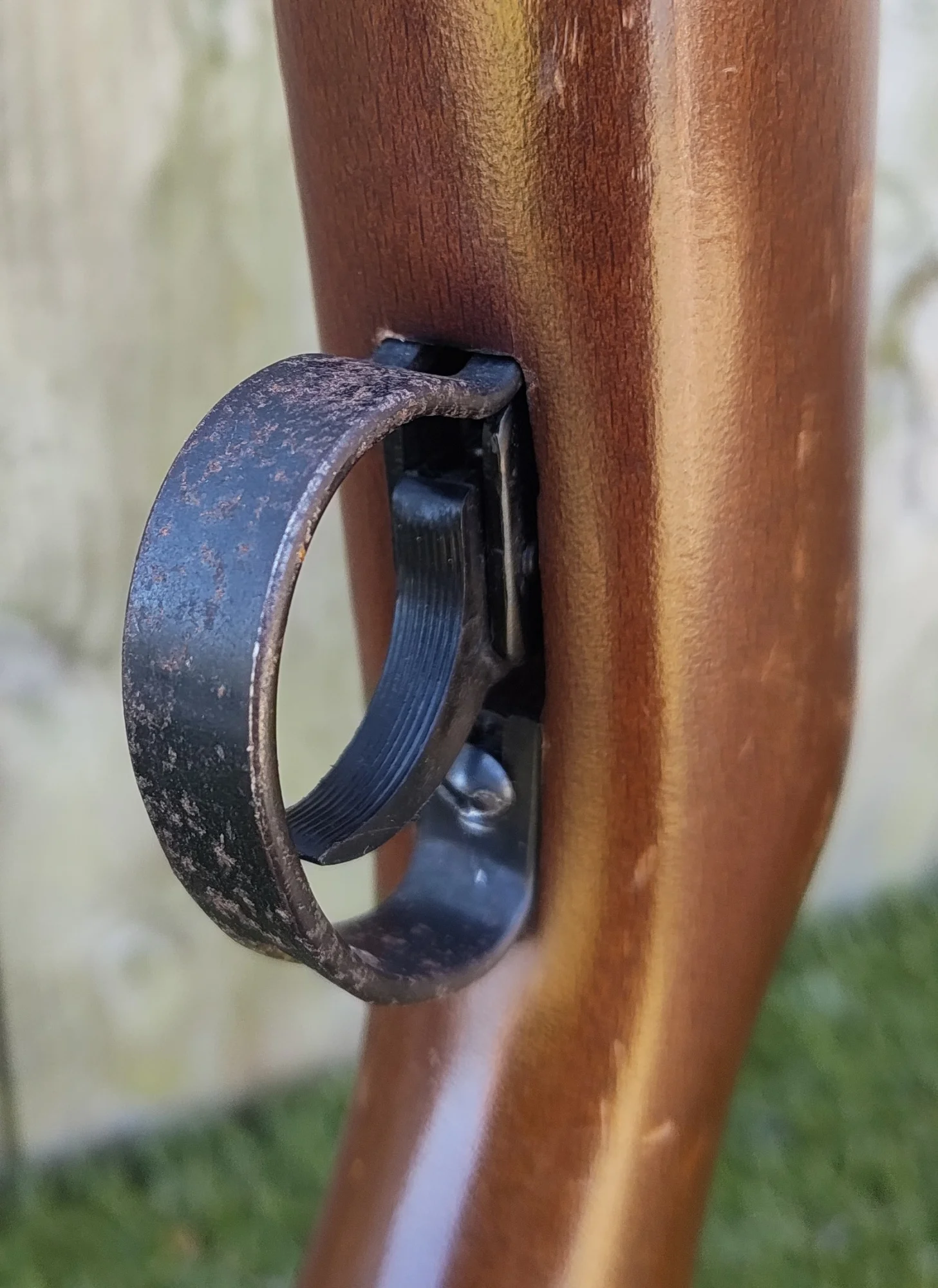

I bought this from here last year with good intentions of it being a winter project but that didn't happen so it is now my Summer .
A BSA Meteor mk5 .22 with a TH serial number which dates it between 1979-1993. Not shot it yet but will do that sometime over the weekend and chrono it.
My plan is vague as to how I want her to look but for now I will strip her and see what if anything is required internally.
The stock is a bit bruised and battered with a few scuffs scrapes and dents. Should have plenty of hours of fun with stripper and sandpaper 😄.
Will put updates on as and when things get done, enough if me waffling as I am sure you all want to see photos
Thanks for looking .
