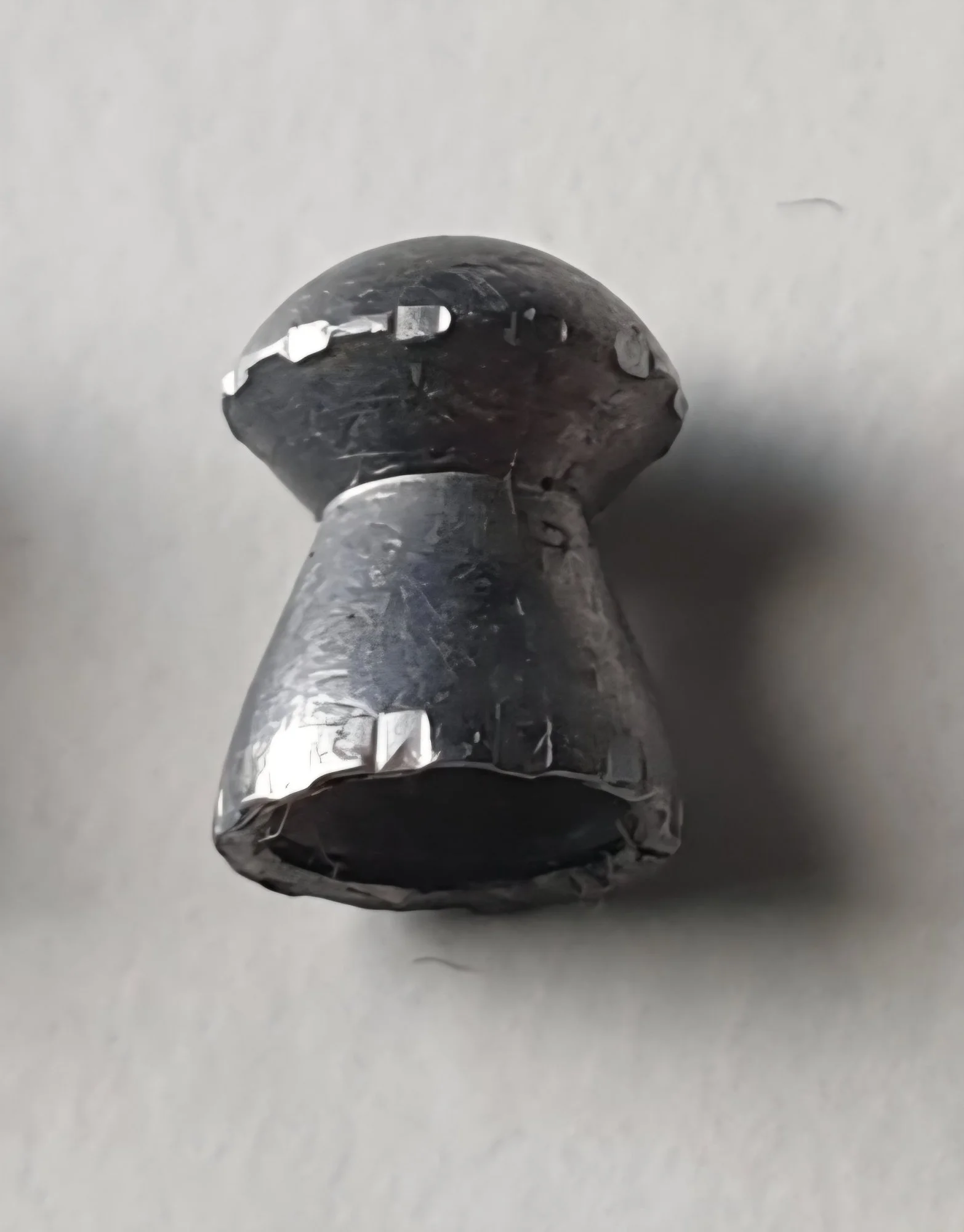

Personally I never polish my barrels i like deep cut sharp edge rifling marks. So I look for pellets that come out on a push through looking like this or deeper . on my conventional rifled barrels.
Rifling markes on both the head and skirt . the cutting seems to act like a defuser around the head of the pellet . this also means the pellets is square in the bore ( parallel) this also means the pellet is leaving straight .
Rifling marks and the shape of the skirt can tell you so much about your barrel and the way your rifle delivers the charge to the rear of the pellet .
Just take the skirt .
1 . see the slight roundness to the body . this means the charge is sharp enough to expand the skirt properly.
2 . is the depth in the rifling groove. means you have a good seal .
if you look back at the pellet above you will see it seals around the head too.
