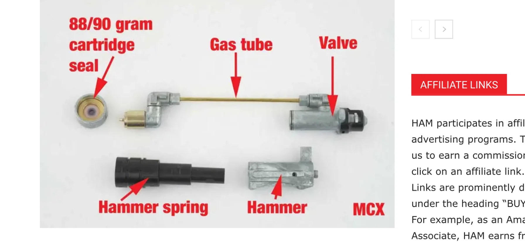

Sounds like it may be the common firing pin problem. Loads of repair videos on YouTube. They're actually not too bad to get into if you're handy with a screwdriver

It does sound like the common firing pin falling out of the hammer assembly that Ade C mentioned.
When unloaded but cocked, can you hear what sounds like a loose bolt rattling around if you shake the rifle?

Well, after many months I have finally got the rifle back! Took it back to the supplying dealer (local gun shop) a couple of months ago and they struggled to get spares from Sig, so the helpful chap there engineered the broken piece and its now working fine :)
What a nightmare from start to finish, but glad its sorted now, thanks all for the help and info!
