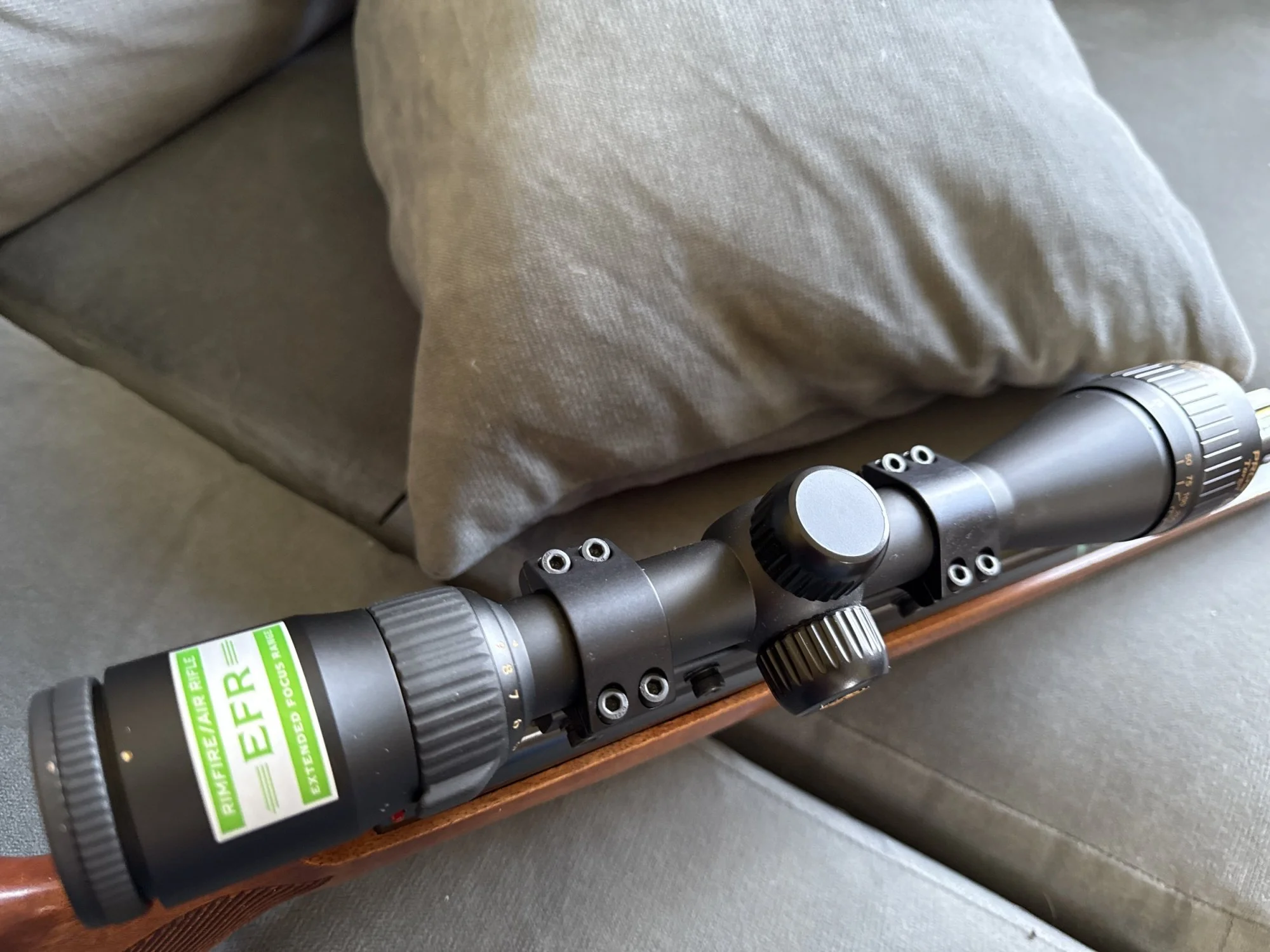

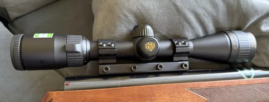

ive a mix of vintage and new, but i prefer the vintage, especially the plain thin crosshairs, the newer scopes i own have much fatter crosshairs and tend to cover a bigger portion of the target at distance, or is that just my perception. my groups look bigger with the newer scopes.
