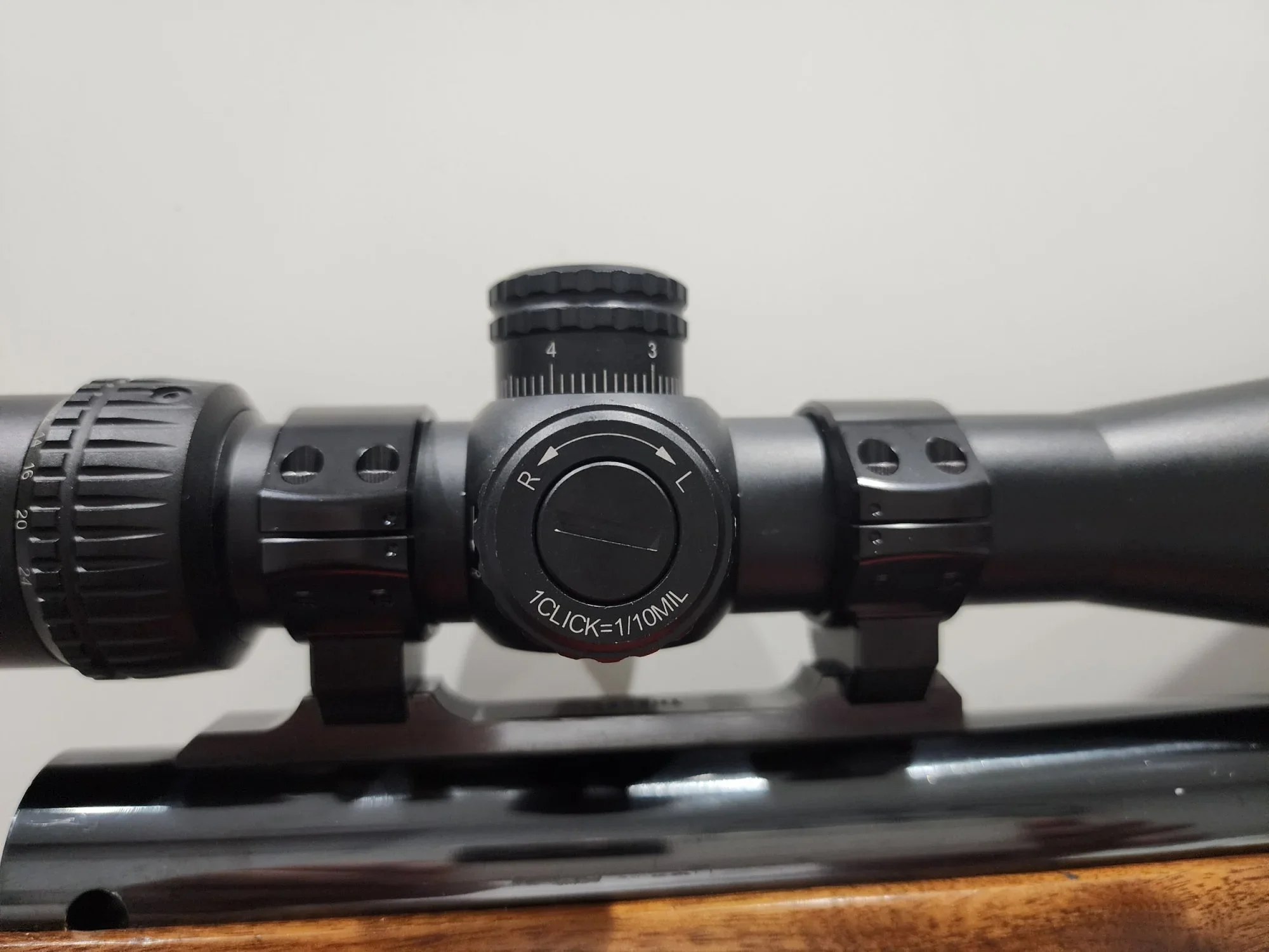

Recently sold a mint bought new iliminator in .22 of course it came with the 1” damper mount as standard. Years ago I wanted to put on a 30mm tube scope and from memory was told 2 piece rapid mounts would fit. Was intresting removing the 2 countersunk screws that hold the dampa mount as theoben must have used a decent load of stud lock on them. The sportsmatch rapid mounts did fit but they are 2 piece and have no damper to them. I could be wrong but there was something about the threads into the receiver being 2 BA ??
Ok I’ve got Slr88 and Rapid mounts side by side..
Slr ones are slimmer but a machinist could trim rapid ones to fit as the screw and holes that hold mounts appear to be the same.
Hope this helps!

@maxtich thank you very much for taking the time to do this. A few people are searching through dusty attic drawers to see if they can find any old sets but at least I know a set of Rapid ones can be used.

Good point Bighit and great to have the pictures
