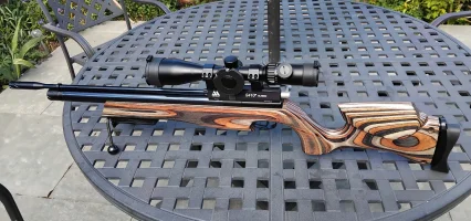

Regarding upgrades @Air Gun Strutt, I don’t think they need any. Perfect as they are. You could change the bolt handle if you want something more comfortable or the stock if you want something that fits better. Here is mine.

Great rifles, they work very well without regulators and at relatively low cylinder pressures. I dont fill mine above 160bar and it easily lasts a club session. Its .177 and originally a 10 shot version, and it was easy to convert it to single shot for competitions. The best thing I've done to mine is fit it into a s510 laminate stock and add a Bob Patendon ssl. For bench rest shooting I added a fore end pad, and a removeable short bipod to put it all down the right way up on.
