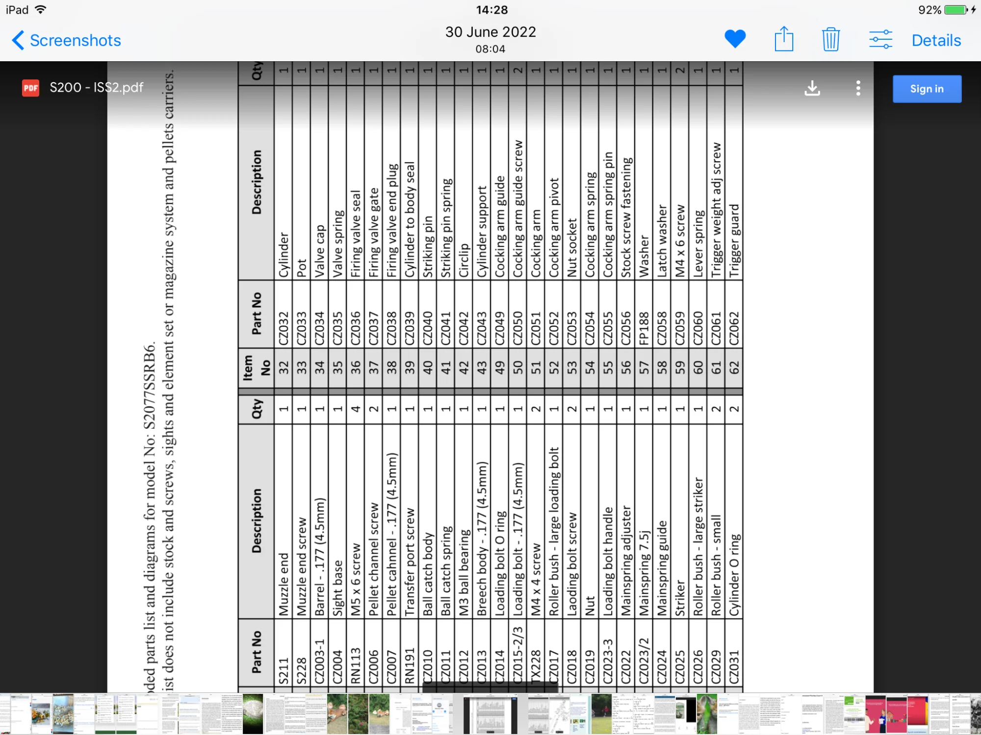

CZ034 cap 🤔 Not unknown for it to move, causing power to either increase or lower depending on which way it's turned, somebody wrote about this on here awhile ago, same as power adjusting screw which can also do it

Sounds like something moving over a spring as others have said. While tuning mine with the hammer spring locking grub off it moved shot to shot. Well worth a look.
