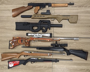

Just been down to the club today with my 10 22... Put a silencer on it.... Shoots like a totally different rifle now.. So much fun on turning targets....

Putting a moderator/silencer/can/whatever on the end of a barrel alters the vibration characteristics/harmonics of the barrel due to the mass of the attachment and the moment (leverage) of the mass. If it is a reflex type in contact with the barrel back from the muzzle then there can be an additional effect which in combination with the mass of the attachment can be positive or negative in respect to the accuracy of the firearm. In your case it was positive, good result, use it from now on!

As an off the shelf rifle extremely poor, that's why you will generally see them as a heavily tweaked unit with a plethora of aftermarket gizmos added to bring them up to scratch.
Stock trigger is incredibly heavy, barrels have loose chambers and tightest spot may not be at the muzzle. Action fit to stock is usually poor. The only aftermarket parts in my gun are the chassis, and extractor - the rest is modified stock parts.

To be frank I was rather surprised at how accurate the barrel turned out. Shortened the chamber and cut at the tightest point. I've spent hours with the trigger group to get it down to 700 grams while it still resets. It would have been much easier to just buy parts but where's the fun in it?
