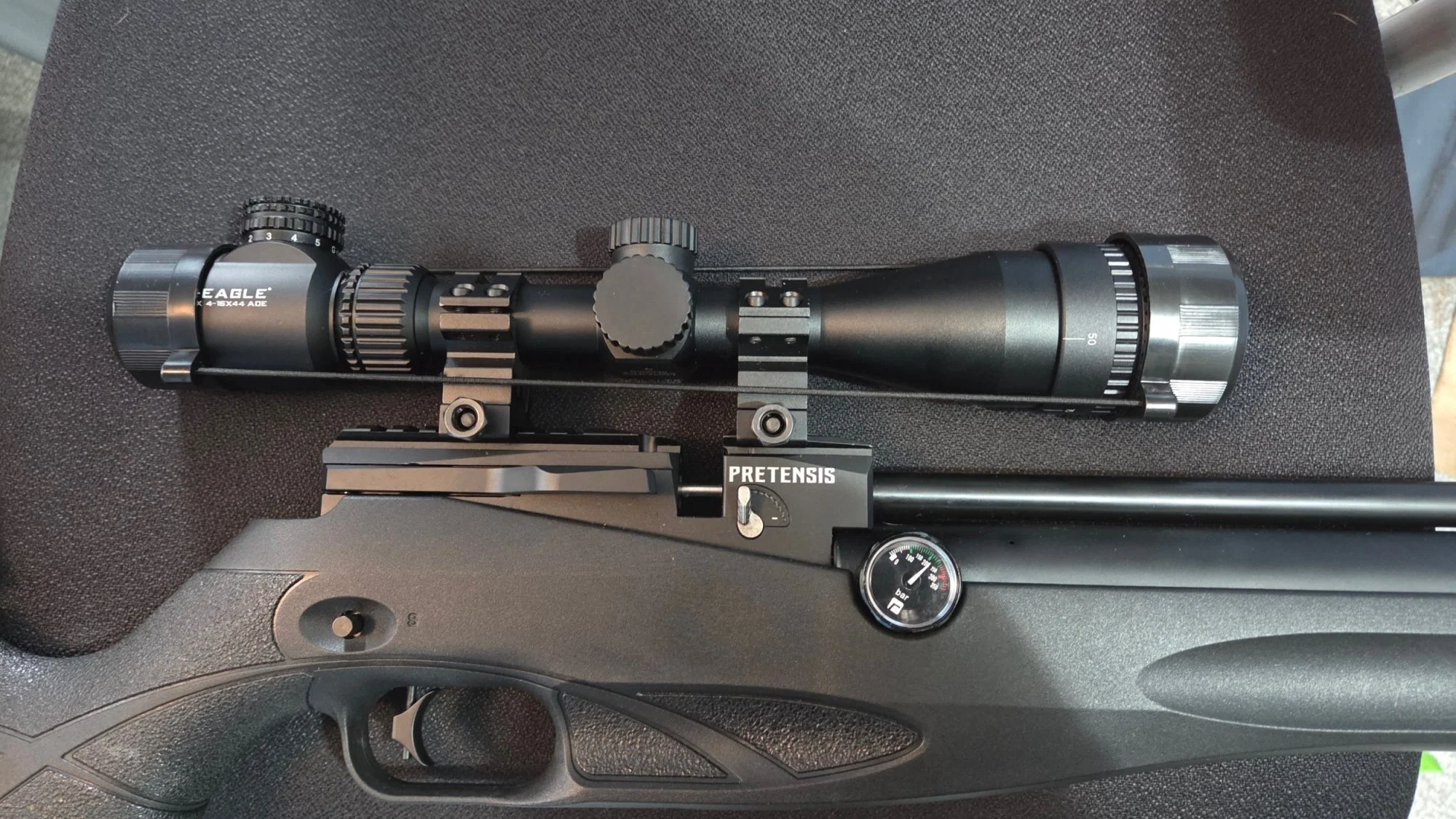

Anyway, the pellets were off to the left and on trying to move the windage right found it was already wound over as far as it would go. Carried on playing swapped mounts around made sure that the scope rail was clean, centred the elevation and windage and was shooting bloody good groups just about 4 inches to the left of POI. Thought to start with issue with scope. Ummm 🤔

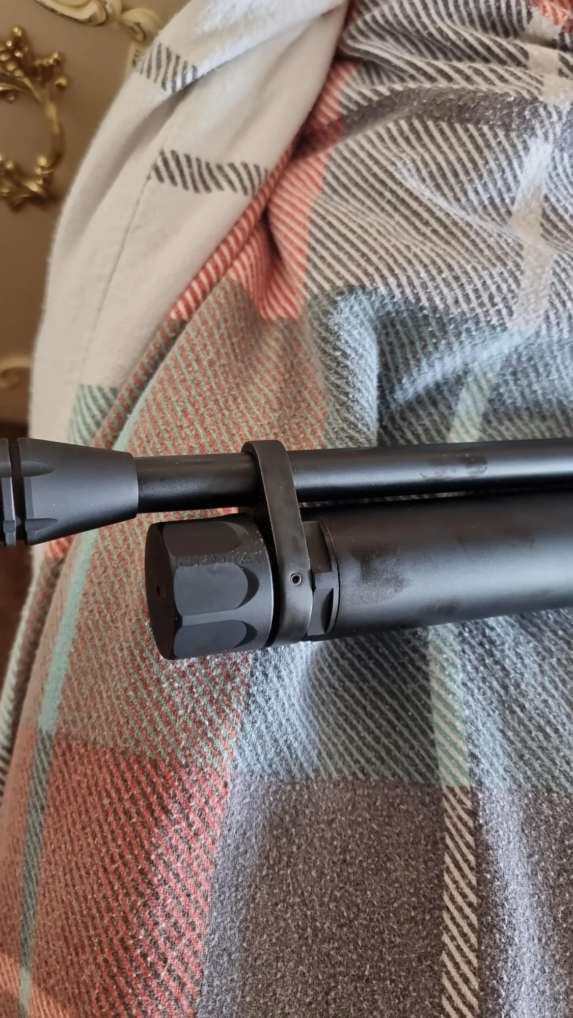

I took scope off and run a straight edge each side of the weaver rail to find that the barrel was over to the left by about 3mm which at 20 or so metres equates to the 4 inch issue I had on the range.
Following the advice found on here I released the grub screws on the barrel band the barrel sprung over and hey presto it was pretty much central. Tightened everything thing up refitted scope and put a target at about 15m in the garden and sighted it in, all rather straightforward to do.

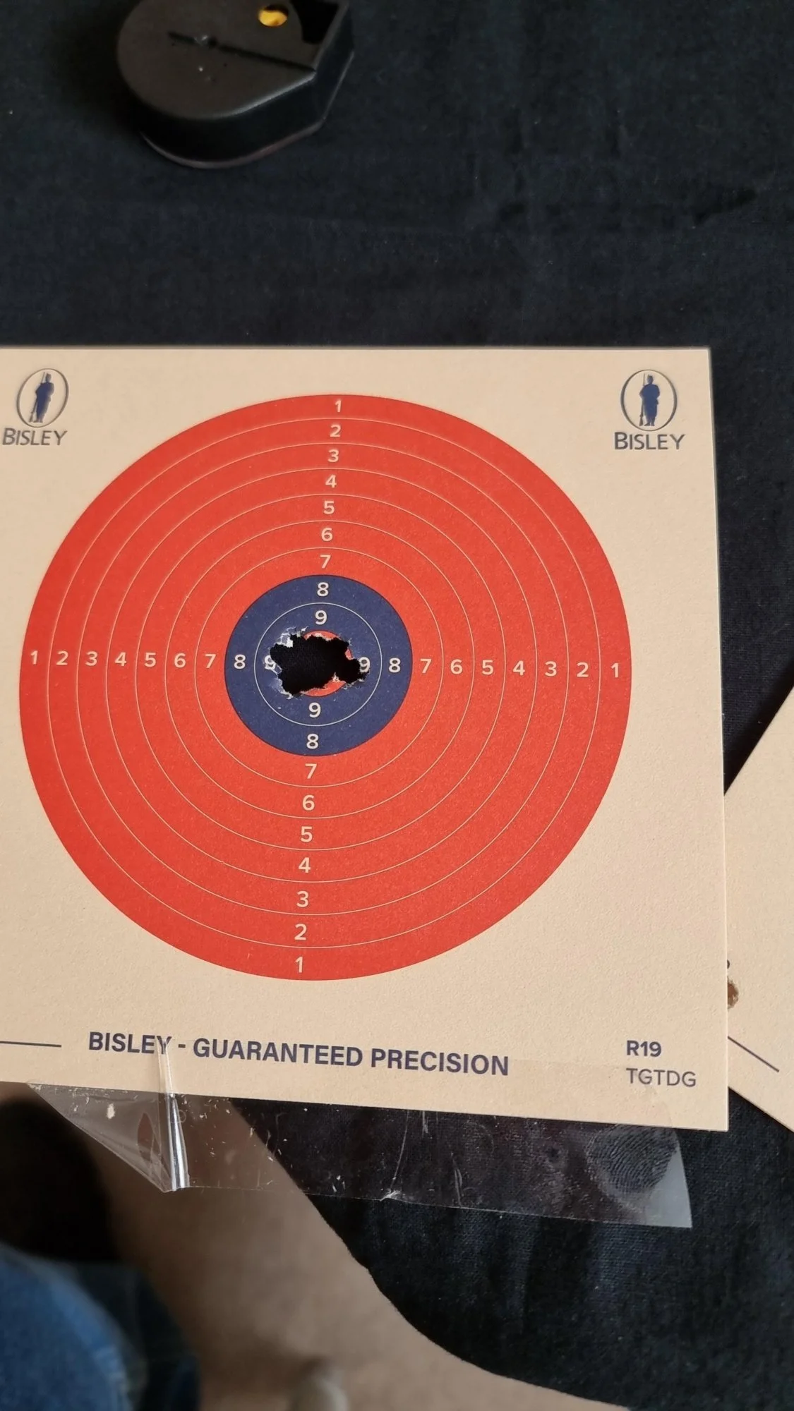

Put up another target and the put 12 shots down all in the 9 and 10!

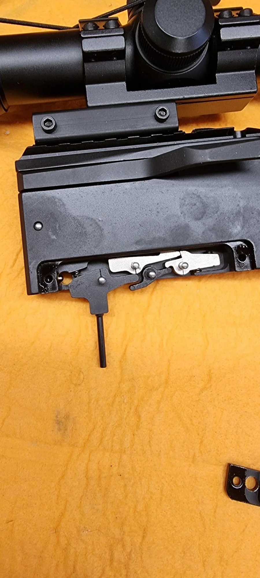

This morning removed the trigger sears and polished them as the trigger operation wasn't as smooth as it could have been, once the paint that had been liberally applied when the gun was assembled had been cleaned off and a thin layer of grease had been applied, I put it all back together and now can't wait to get to the range with it once more.
I don't know the Pretensis, but first up I would have thought your groups should be much tighter than that at 15 m.
Probably down to that scope mount, not ideal and would think it would give inconsistent poi.
A couple of scope mounts directly to the rail and dumping the block would help.
Then see how the Edgar Bros scope performs.

I have been at the range again today and due to the conditions underfoot the max range I had was about 32m. I was getting10p groups at that distance using the 12 shots in a mag. Pretty happy with that tbh.

The scope mount is not the best I do have some separate mounts that I have put somewhere safe! In fairness while the scope is OK but it isn't the best. I have a Hawke 4-16 x 50 on my Lyra and will get the same to go on this one in the fullness of time.

The grouping at about 32m is good enough for me at the minute with 22 Shots of 24 inside the area of a 50p.

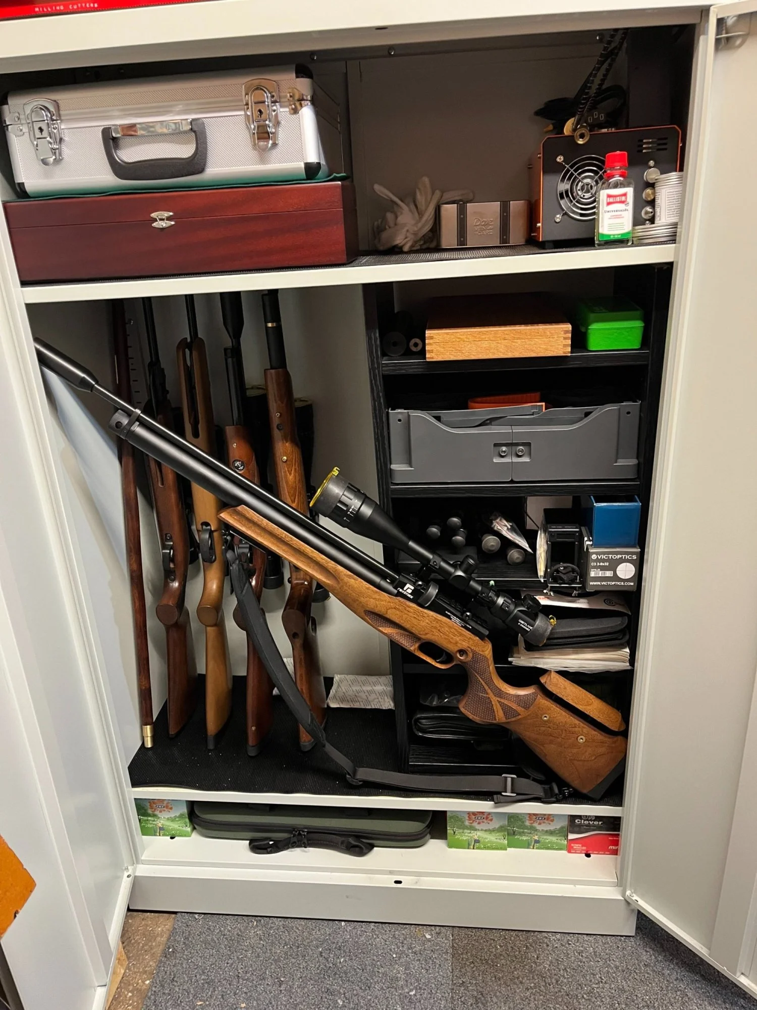

Mine below, i have 4-16 x 44 on mine and its a dream TBH

I got mine from a really nice dude on here.
.22 in walnut stock, for the money they are great IMHO and a really nice looking rifle.
Well balanced and not heavy as well even considering the length
Thankfully I've haven't had the barrel issue, also scope mounts direct
But I do need to modify my cabinet to get it to fit 😄
Or a new bigger cabinet 🤣🤣🤣
