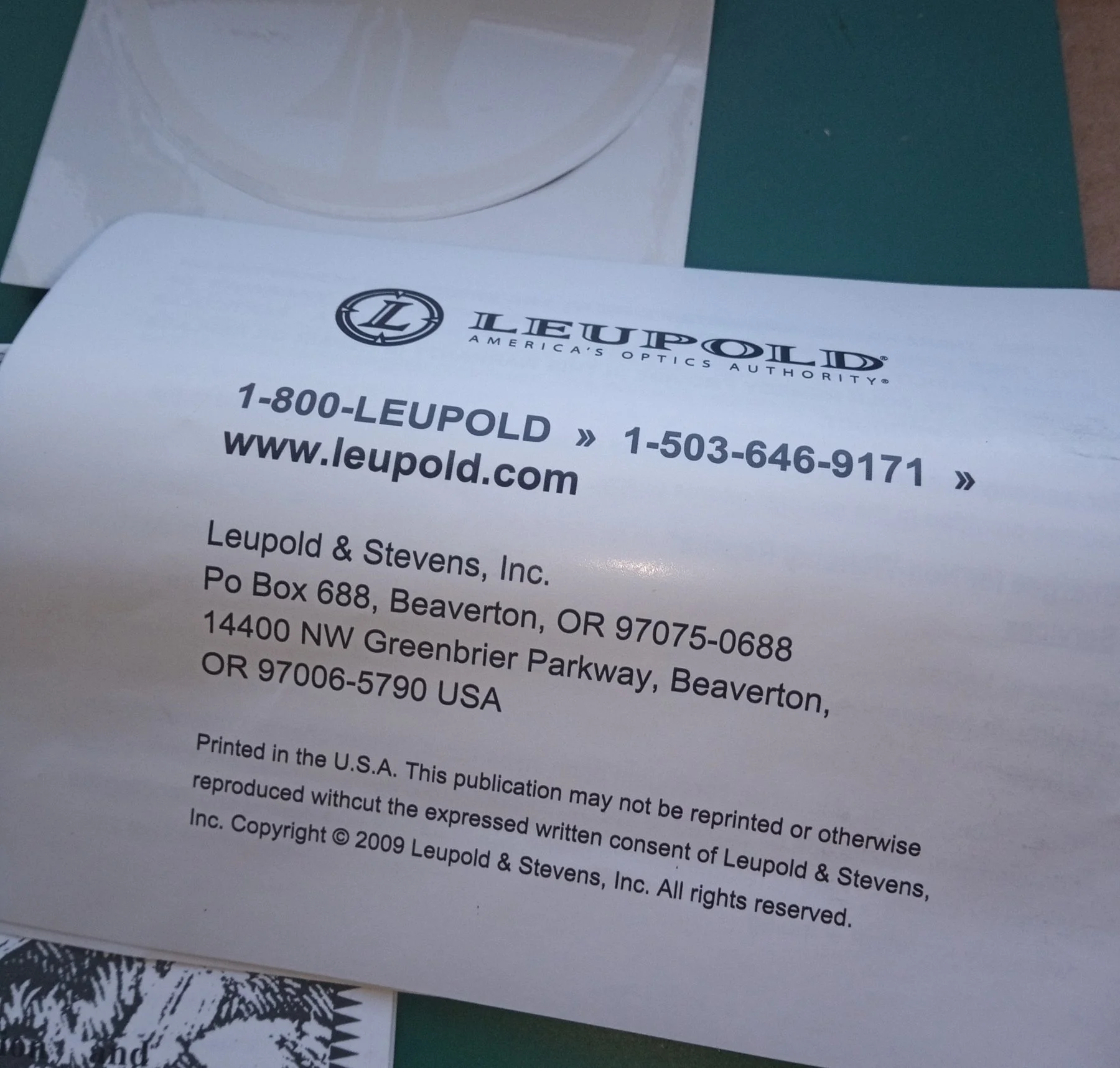

Warranty card and lifetime guarantee, owners handbook and car window sticker....View attachment 120713View attachment 120714

100% fake , for one it’s coming from China. Two price is obvious give away. If it’s too good to be true…..
Thing is it wasn't even advertised as a Leupold, just a generic no brand 1-5x20.
So crafty way of dumping stock they wouldn't be able to sell
This serial number is definitely printed (see pic below) not etched unfortunately.
I don't know how much a real one would cost but guess a lot more than £40
Technically that photo shows laser engraving - you can clearly see the horizontal lines where the carriage has run horizontally to engrave the serial, this is generally going to produce a very different result to mechanical engraving as shown in the photo of a genuine scope as it’s generally a single tool path. Most modern serial numbers are now laser engraved, as are things like QR codes because it’s quick, accurate and easy to advance numbers/letters.
Either way, the scope is clearly a fake, while it’s not an awful copy and some small amount of effort has been put into dressing it up so it’s less obvious, it’s still pretty obvious. Sadly China makes a lot of good quality scopes for many brands, but it also makes some real dross and they are happy to stick whatever you want on it as long as they are paid up front.
