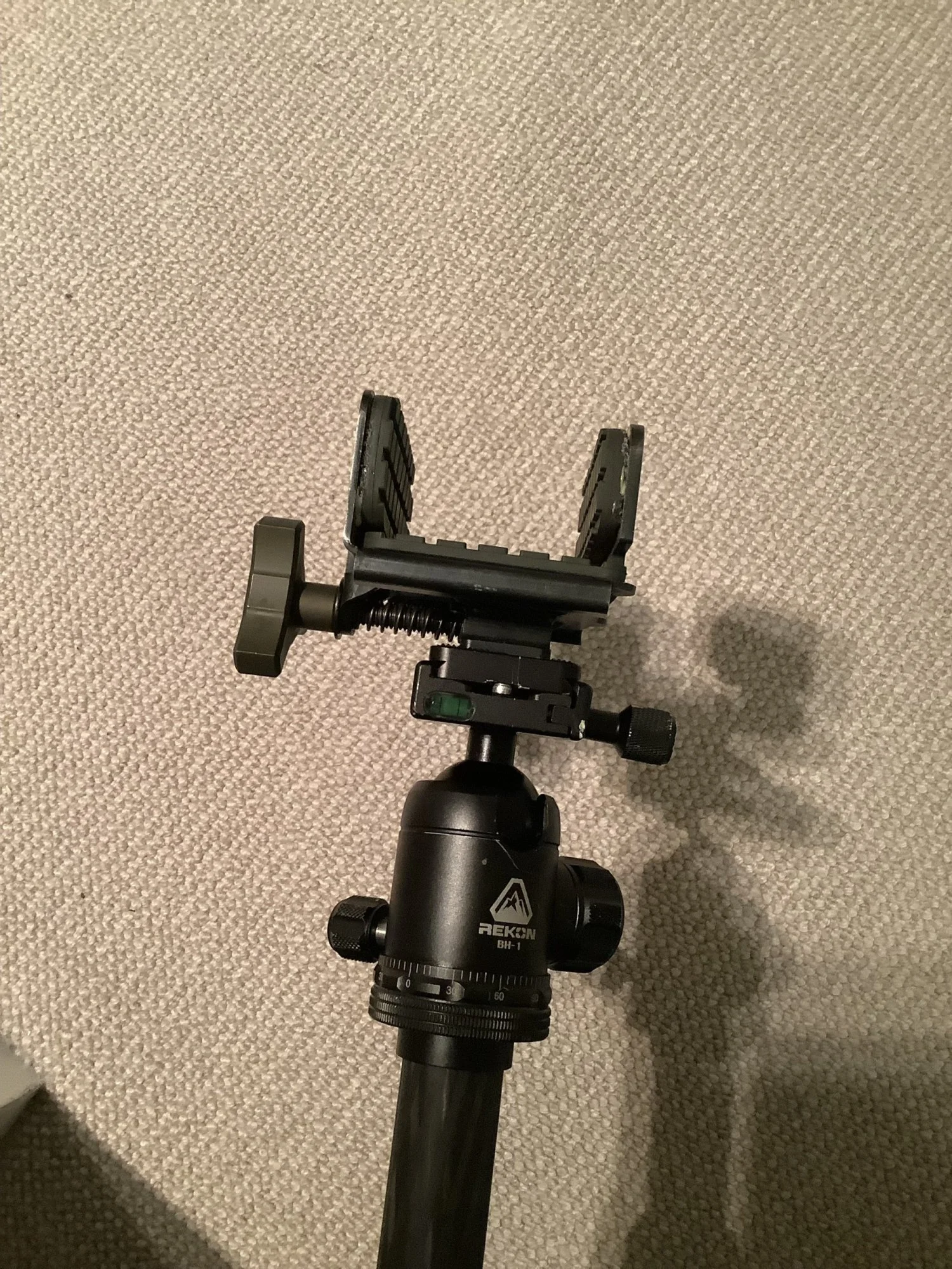

Has anyone using a Rekon Tripod experienced an issue with the pig saddle gents. The jaws of the saddle have started to rattle a bit, particularly annoying when walking with them before deploying. Any experience or clues as to why. Cheers

Ah I see what you mean now matey, nipped up tight. No it’s fine and doesn’t rattle when holding the rifle it’s whilst walking with the tripod to say a shooting position the jaws move slightly back and forth and rattle, there is no adjustment that you can make to tighten them until fastening to a rifle.

Is this the same as the Hog Saddle? The only thing I can see as a possible fault is the spring losing tension. Can you post a couple of photos of the rattle position and non rattle?

Hi mate it rattles in both holding positions/ carrying but…..it’s less of a problem carrying it like this below
When looking down at the jaws whilst carrying if it’s in this position it’s awful…
The momentum of walking makes the jaws move more so in the position above.
The jaw that moves in and out is the culprit….it wobbles in all axis.

It has to be spring tension or wear on the screw thread, male or female. How far Up North are you from Crewe?

I removed the spring and stretched it a bit but it’s still the same….im 40 mile north of you buddy. It’s not just the jaw moving backwards and forwards a few mm which causes the noise it’s an up and down movement too….mm’s of course but metal on metal at 3am is a kicker.

Try taking the slide out and putting insulation tape on the edge of the rail, then put it back together. If that works, it's simply a case of having a couple of blobs of mig weld on each end, then filing down to a snug fit. In fact, I'd bet there were plastic shims in there that have worn out.
