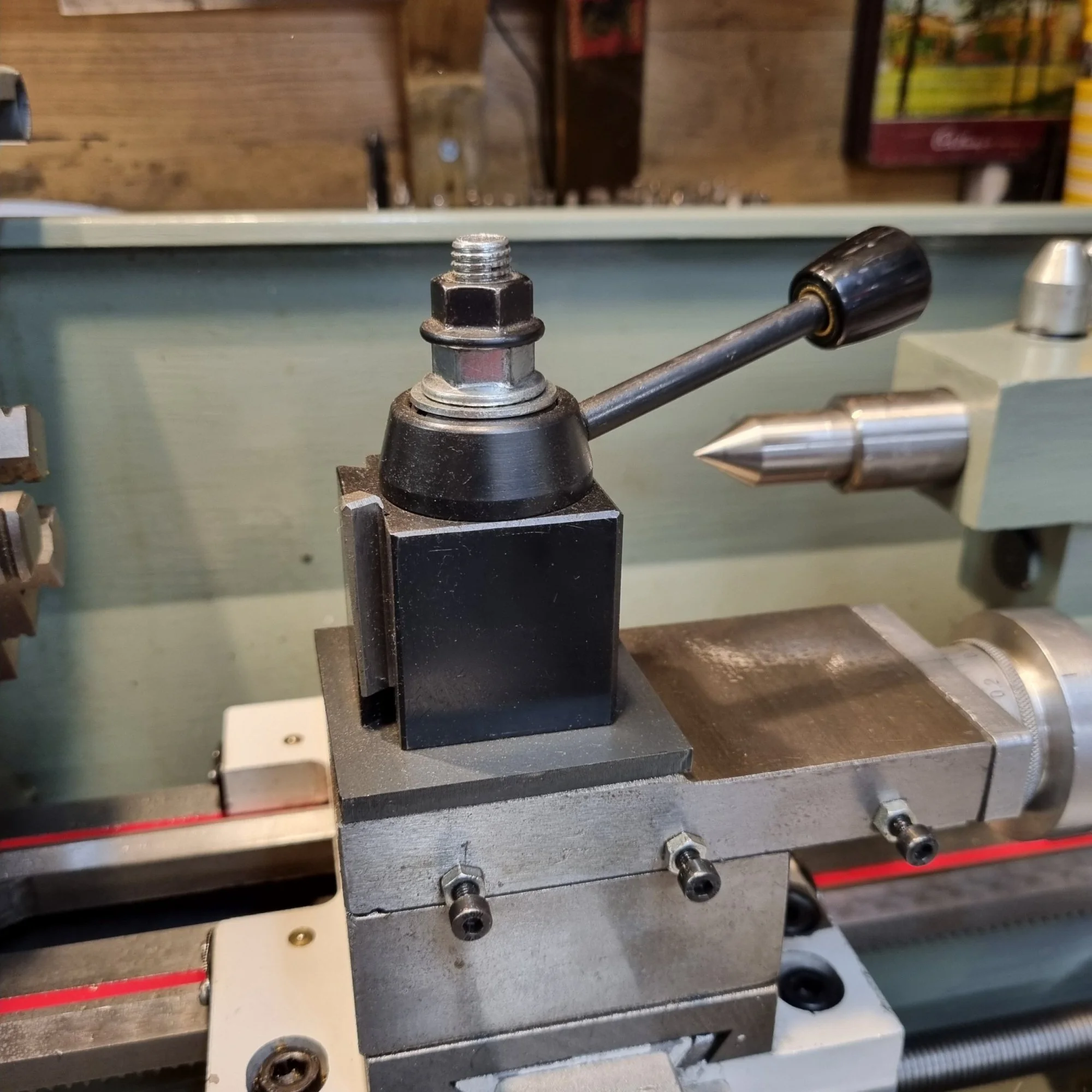

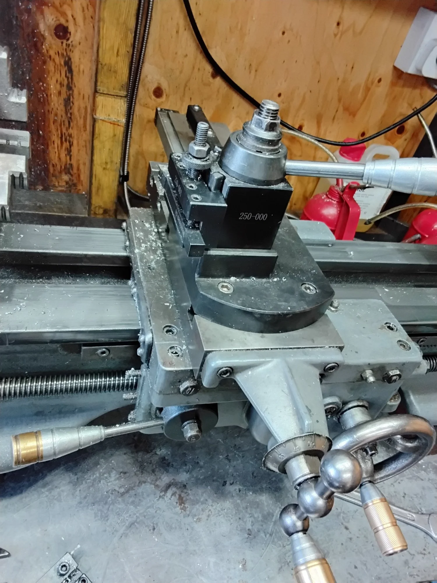

Mine is one of the generic qctp from Ebay albeit a couple of years ago and for about 40 quid with four tool holders and it is made of steel throughout. They are all much of a muchness . I got the 250 000 and 001 ect holders for my mx210v 8"x16" lathe , the lock up on it has behaved flawlessly. Not much to go wrong on them really but I've found it to be well worth the money changing from the 4 way tp that i needed to shim to this.

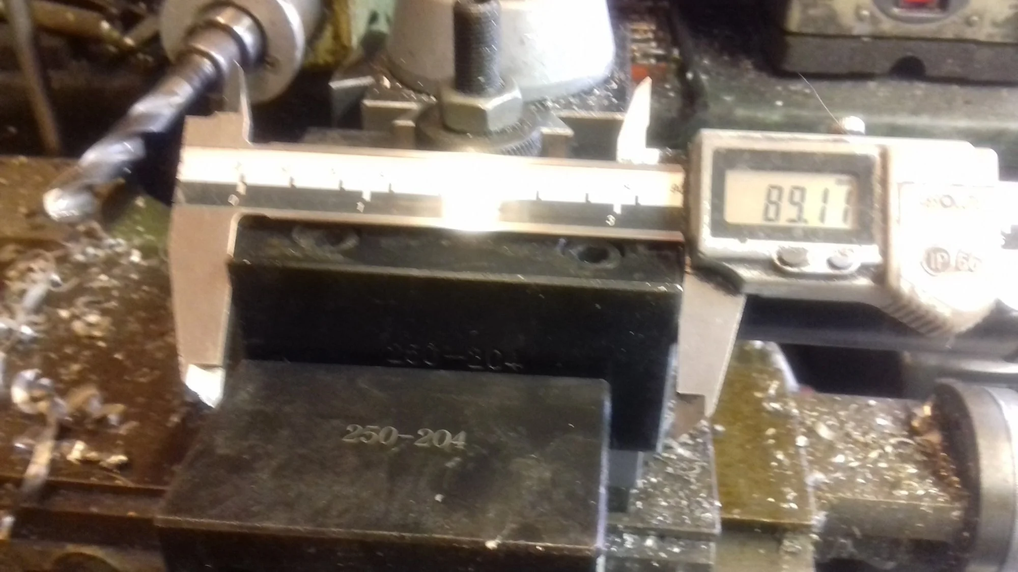

A chinese 250/200 series but get the tool holders from same place. As have bought labelled 250/202 etc several times over and way too small.

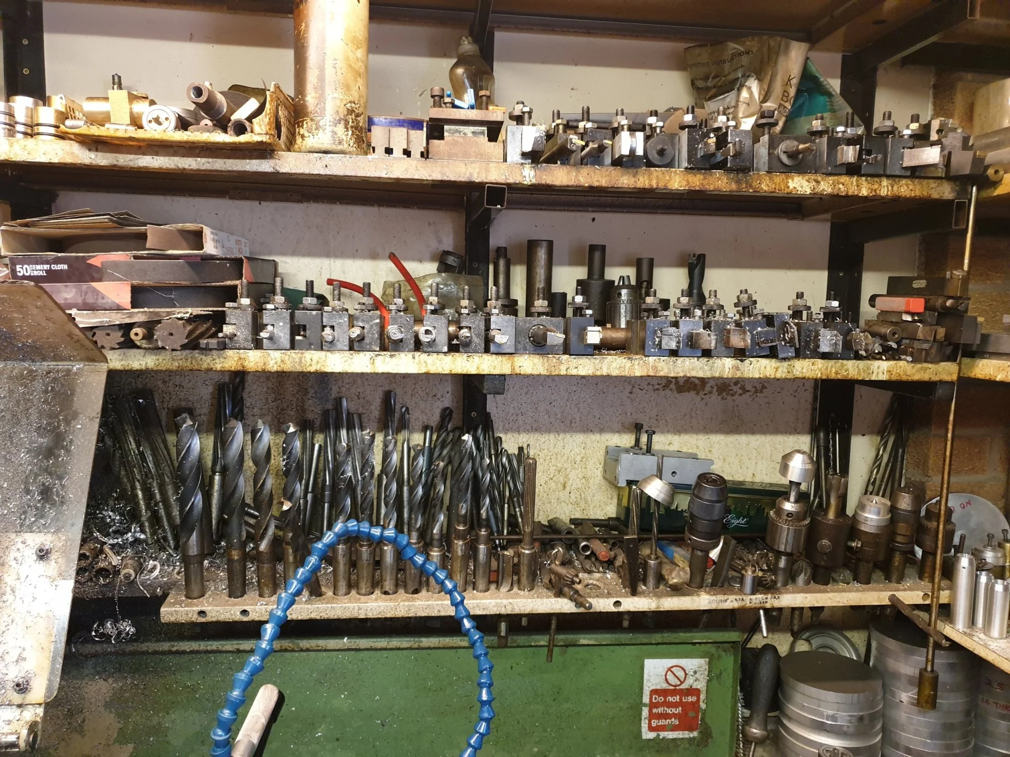

Only got 51 tool posts all ready to use.

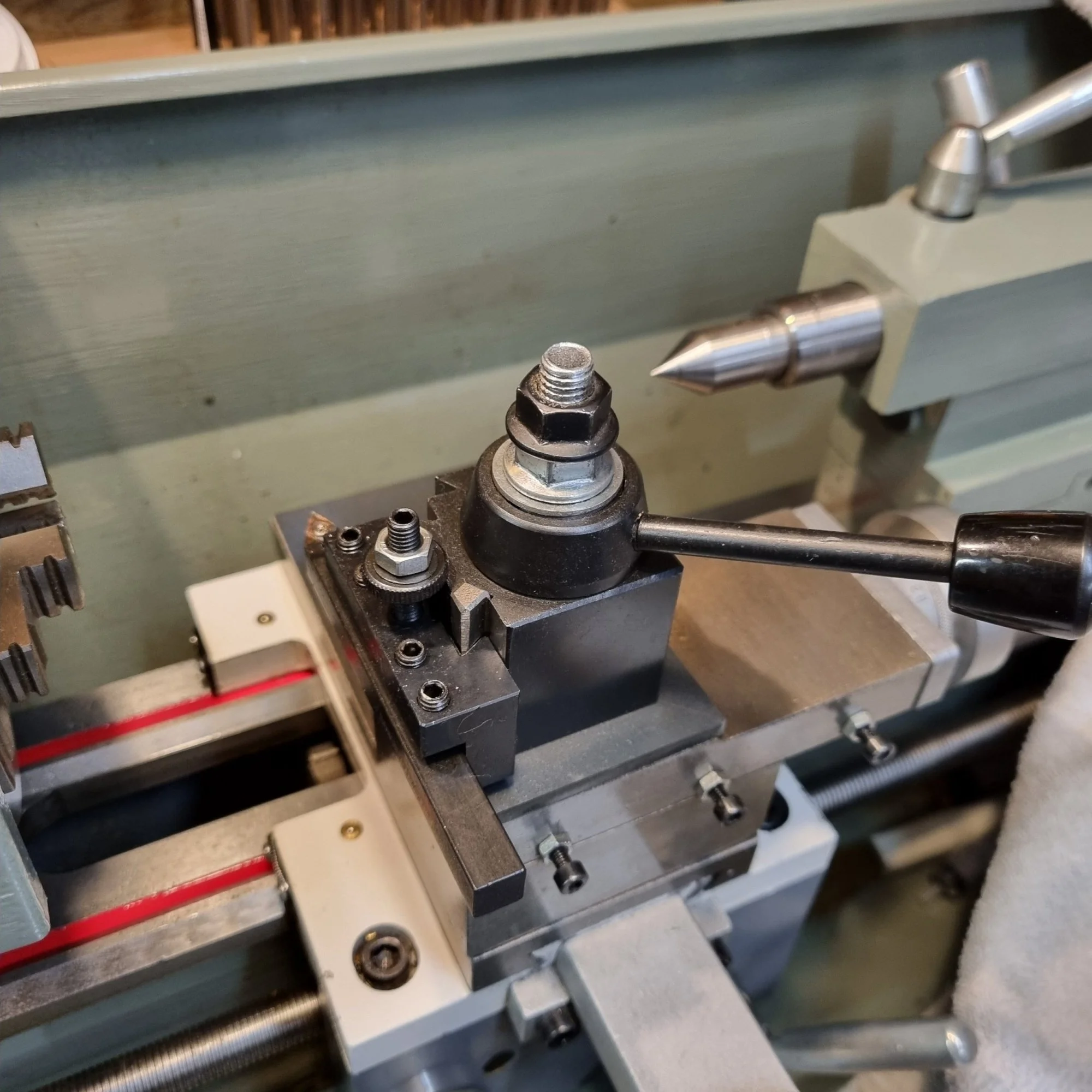

Got a cheap one from eBay on my old Myford, been using it for four or five years now, works a treat.
It's all Steel.
When the British had a machine tool industry, the Myford / Boxford etc, great to see them still going!
Note the picture above does not show a top slide so the QC block is mounted on the cross slide plate, special adaptor plate?

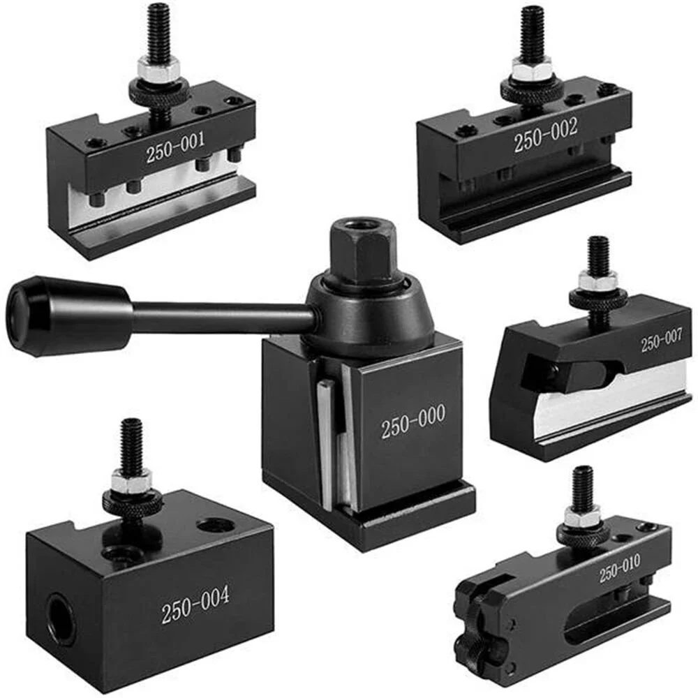

The oxa 250-101 is what i had in my basket but searching around...seems this is for the 210 lathe.
Ive found the bigger brother axa 250-111 with 5 holders for £137 so think im gonna just grab that and use some 12mm tooling.
Yes mate, the adapter plate was chopped out of a chunk of cast iron, I've got the top slide, but I only Mount it when I need it👍
