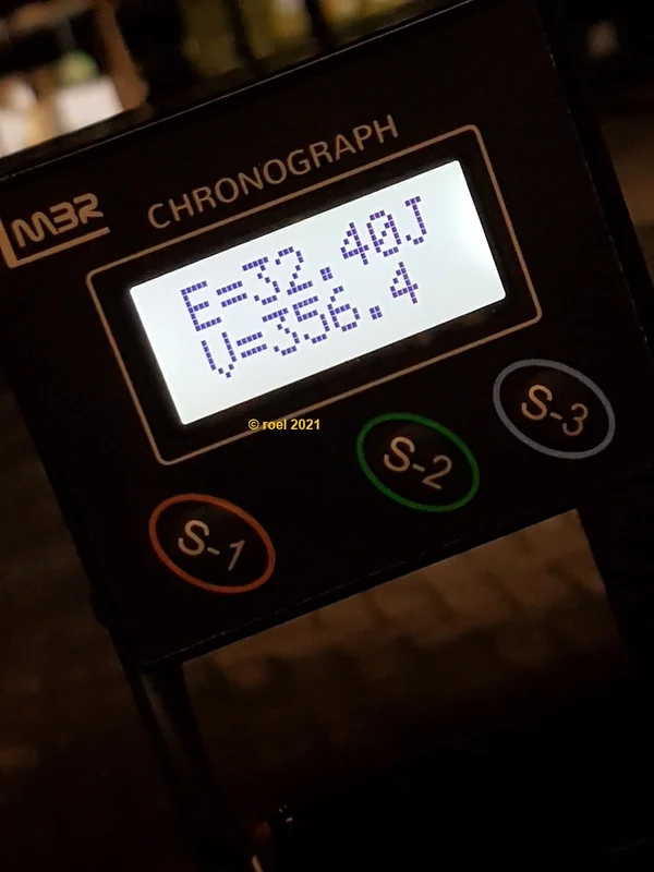

i have two QB 78`s, both are converted to PCP. I have a .22 wich i bought from a Spanish bloke. I have no clue where the conversion comes from. I`ve been looking all over the internet but couldn`t find it. This gun is shooting very well with its original barrel. I`m Dutch so the muzzle velocity exceeds 12 fpe.

The conversion comes from Poland. A tube and a new valve is all i got.
It was a hell of a job to get the transfer port airtight. When it was airtight i discovered that i had created a monster. With 10 grain JSB these are the V0 values:
1196,3 fps
1154,8 fps
1153,8
The 6th and last one i measured was 344,5 m/s or 1130,2 fps.
Best regards, R
