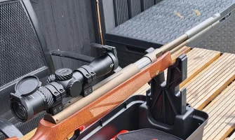

I have BKL double straps on mine seem fine look good imo.
