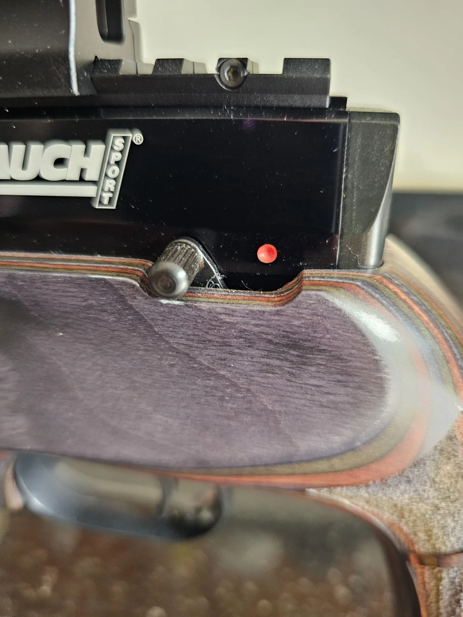

I was expecting a Happy New Gun Day last Friday. A new HW100X was sent to a via a local RFD. When I got home I opened the box it was a sporter stock and not a thumbhole.
Otherwise all seemed ok and after a phone call they promised to send another stock. I thought as I had the action I would clean the barrel check the ft/lbs so that it was ready. I noticed the safety catch was not working. It works fine out of the stock but does not work in the stock. It looks as though an HW100 stock has been used because the safety catch cut out is only on one side of the gun they say they have sold 'hundreds' of the 100x walnut stocks that don't have cut out on both sides and they have been fine. I wonder? Anyway once in the stock the safety does not work. During a further phone call it transpires that I have been sent the wrong rifle. The number on the rifle does not match the documentation so they tell me someone else has my rifle and documentation that does not match. I will not name and shame yet as they are trying to sort it.

With cut out
Without cut out

Yours clearly has had the wrong trigger unit put on it @Old Lobby, for some reason. The reason it isn’t working is because there the safety leaver on the left hand side is jammed against the stock. The stock will probably have damage to it as well.

With cut out
Without cut out
That's a shame. Pop some full pictures of the gun up?
Thats a HW100X Release Sporter action !! Need a cut out on left side also, for safety to operate correctly in the stock !

It’s back in the box! It was the action from an HW100x laminate adjustable with double safety (launch edition) in a standard sporter stock. That is why the safety didn’t work in the stock. I had asked for a thumbhole stock.
