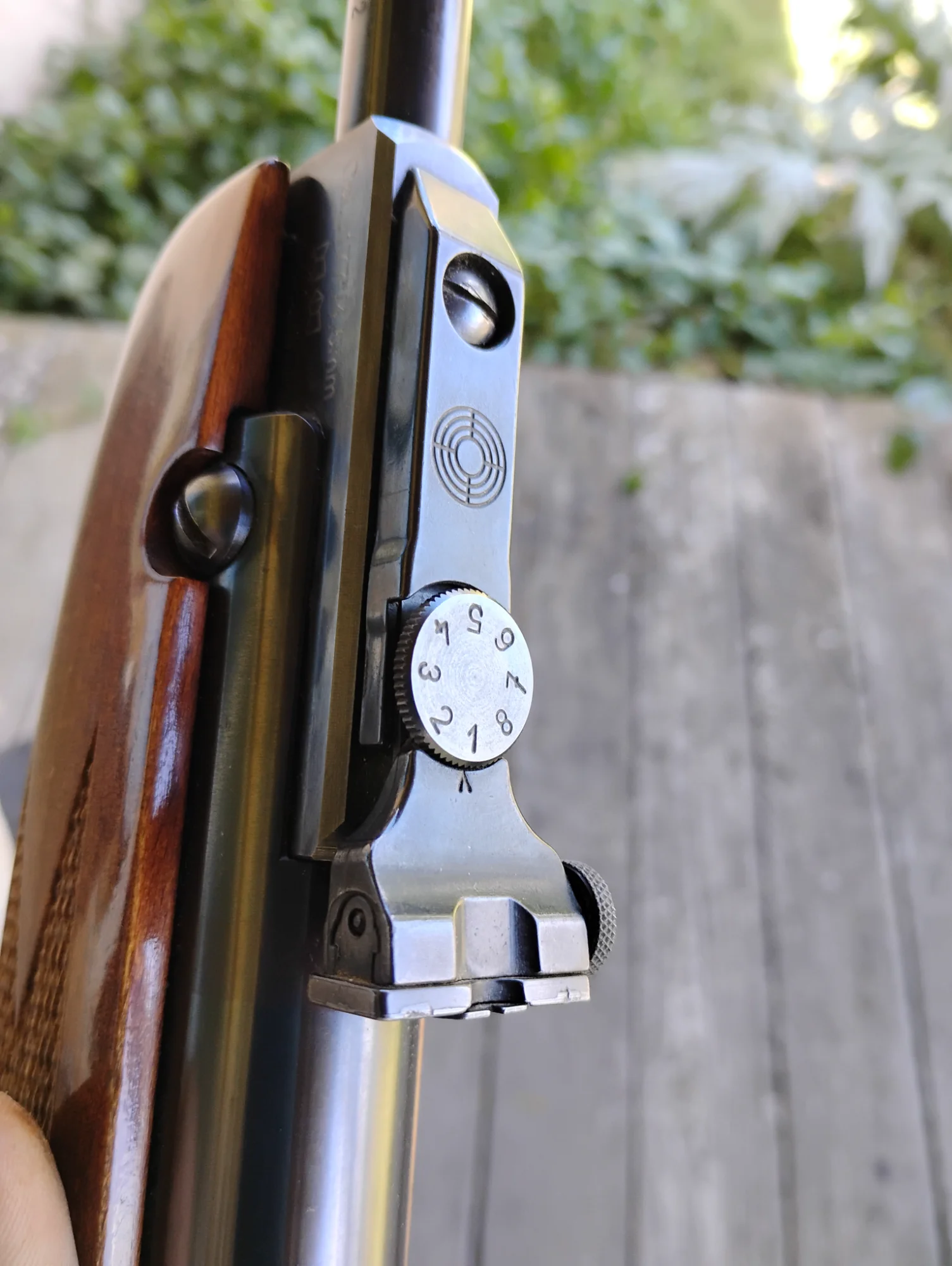

Does the rear sight blade unscrew for further adjustment.
As in this picture:

Aside a power issue, unless your barrel's been somehow bent, I'm at a loss. Does your rear sight look exactly like this ? If not, & running an old style sight, an old style may not be synched in with front sight ? View attachment 965732View attachment 965733
Yes, mine looks exactly the same. I’ll check the barrel and try the 10m distance to start and see what happens.

Ah. New at this. I thought the same model would be roughly similar. From your photo, it looks like your rear sight is quite high too. At least closer to the end of the sight range than the start. That’s helpful info in and of itself.
The picture I posted is a bit misleading & just an example of sight type ( new)...that sight pictured is atop an HW 30 which is a lower powered rifle @ at around 8 ft lbs. The ' 30 is however using the standard new style Weihrauch rear sight unit & coincidentally, zeroed at ~ 25 yards.
