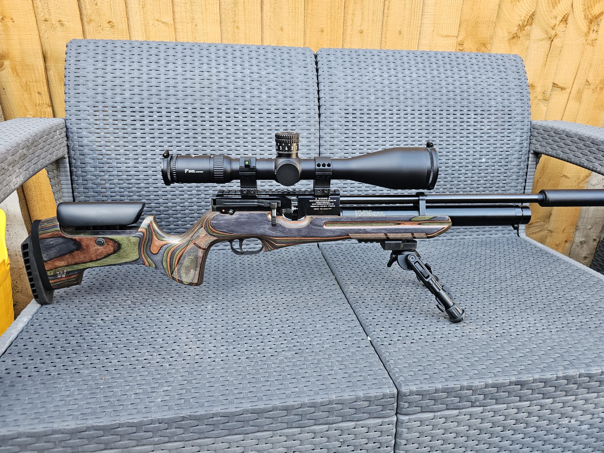

Mine stills balances nicely with a Whopping Falcon T50i + on it 😂 I noticed a couple of high outputs after it had been sat for a week or two but settled well and almost adjusts to the weight of pellet that comes out of it 🤔

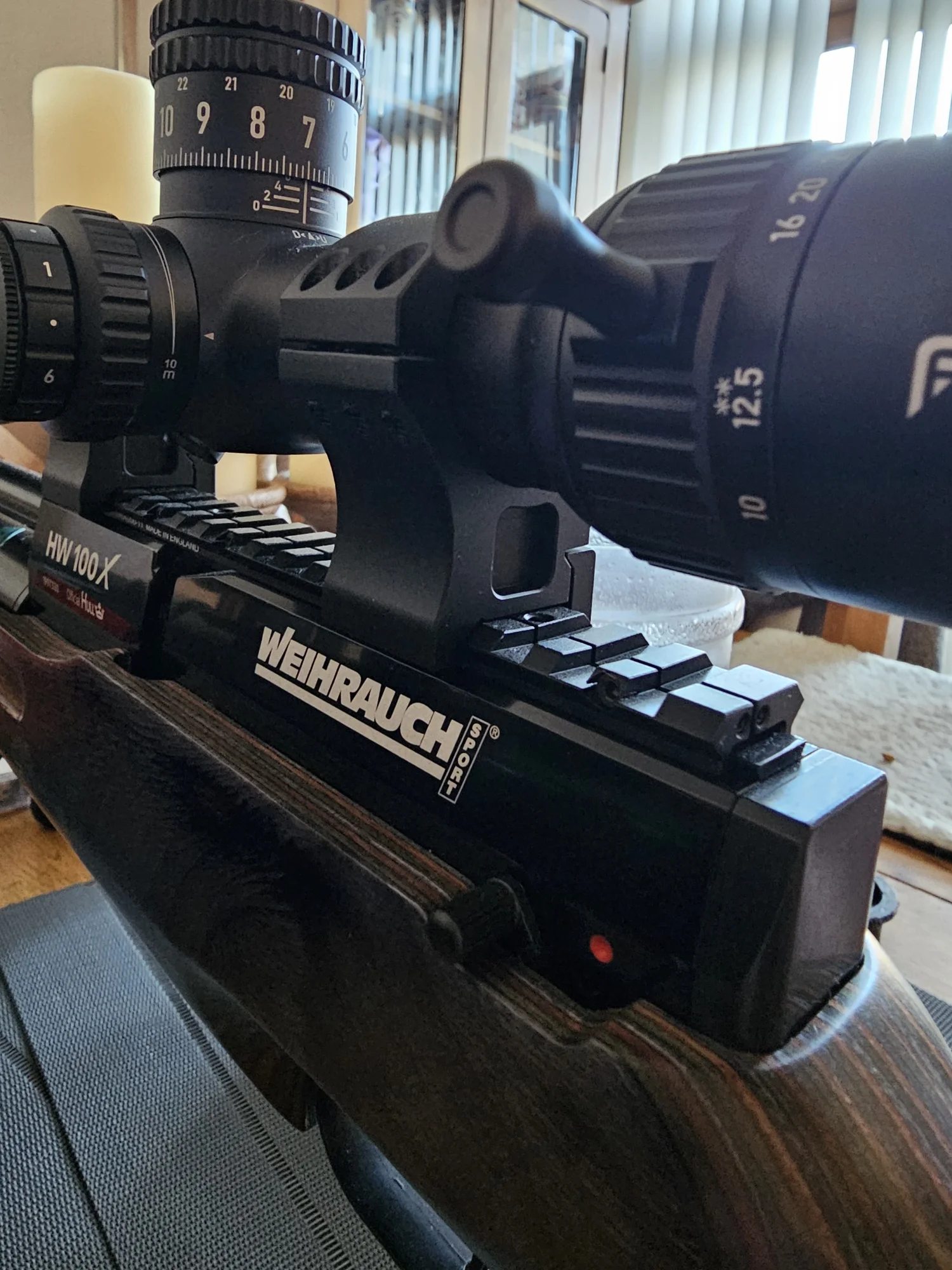

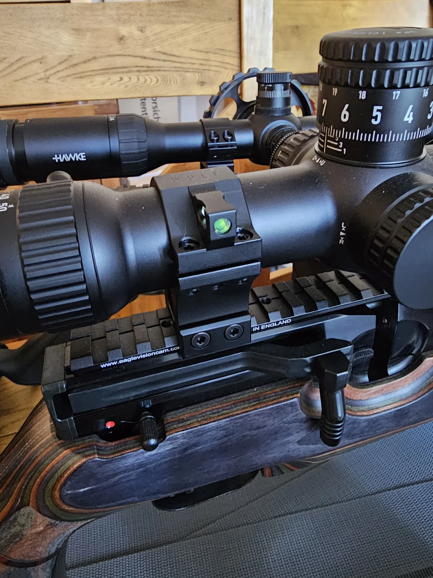

What mounts did you go for with the Falcon? I'm thinking of getting one to go with the rifle...... When it appears
WULF Tactical 34mm Rifle Scope Mount Rings w Bubble Level Weaver/Picatinny HIGH. From Tactical Scope £35.99 a pair, sitting on a Eaglevisioncam 200mm Picatinny rail (The Future 😉). And that good of a rail, ive put one on my 97k too for when rhe next Falcon comes for it instead of the gash AIRMAX 6-24x50 FFP🐼🫵🏻the T50i+ wipes the floor with a Hawke!
PS think mounts available as Dovetail too...tbc
