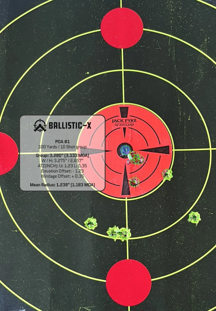

Have been shooting the No4 mk2 a lot lately in a bid to improve with it and because it’s turning that makes me smile most!
Couple of 10 shot groups from the weekend below - benches at 100 yards with a fair wind. I think part of my problem is lifting my head a bit at times thus making shots drop lower, need to learn to stop looking at the screen between shots and just stay in the gun.

Your shooting an actual period lee enfield 😯?
100 yrds on opens that looks good to me!
