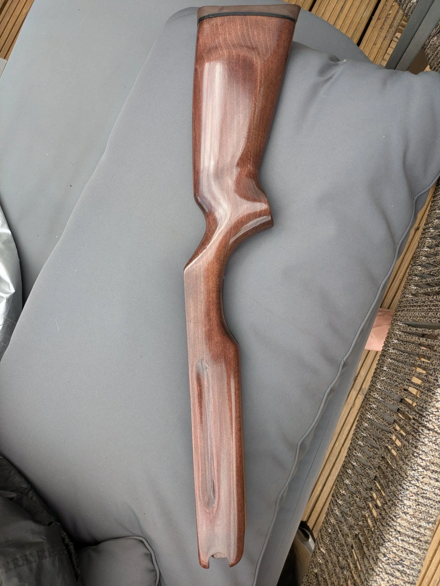

I've had great success with walnut, but the grain ends on the pistol grip/cheek swell with beech always end up darker and in my daft head I add more coats thinking it will help the rest of the stock match in, but it just makes the grain ends even darker 😂
It's strictly a pro job on beech/stains for me.

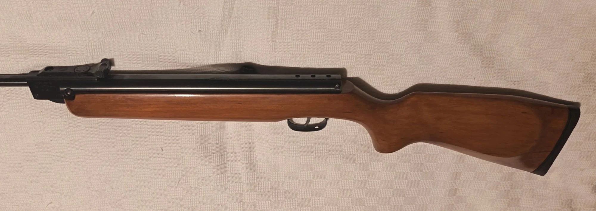

Beech stocks stained with alkanet oil do not, in my experience, send end grain darker. Alkanet chips fully steeped in raw linseed will stain beech after many coats to the colour shown on the two guns below. The more coats applied, the darker the wood will go. To achieve a gloss finish I use artists grade linseed that has had the fats filtered out. This grade of oil dries much quicker than ordinary raw linseed without the use of driers as in boiled linseed. Using this grade of oil allows it to be applied in flood coats that eventually soak into the wood without drying on the surface as can happen with the boiled variery.
