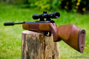

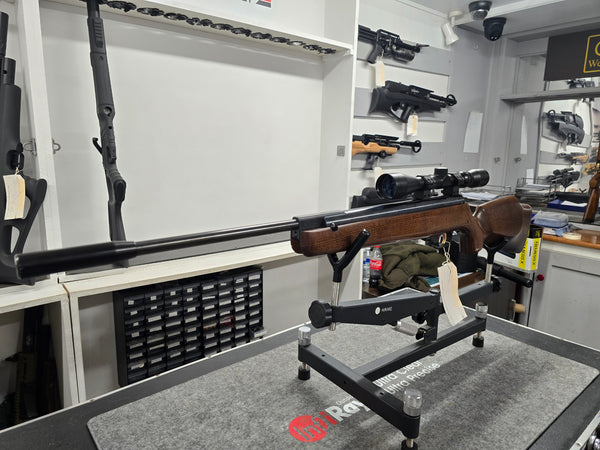

There is a screw on the back of the cylinder that is removed,then an adapter is screwed in to the valve position and a pump like a pcp pump can be used to add pressure to the gas ram. My own HW90k is from 1999 and shoots around 10.8ft lbs.
