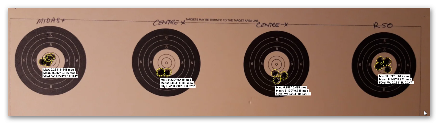

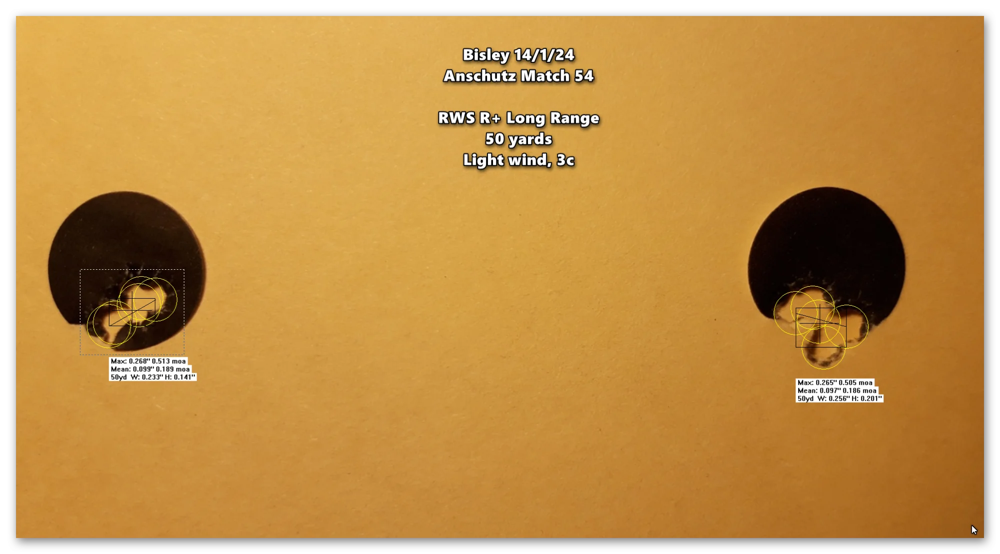

These are typical 50yd groups with my Anschutz Match 54 rifle :
And I would say that is about the same size I would get with my 6mmbr at 100yds, so about twice as accurate.
