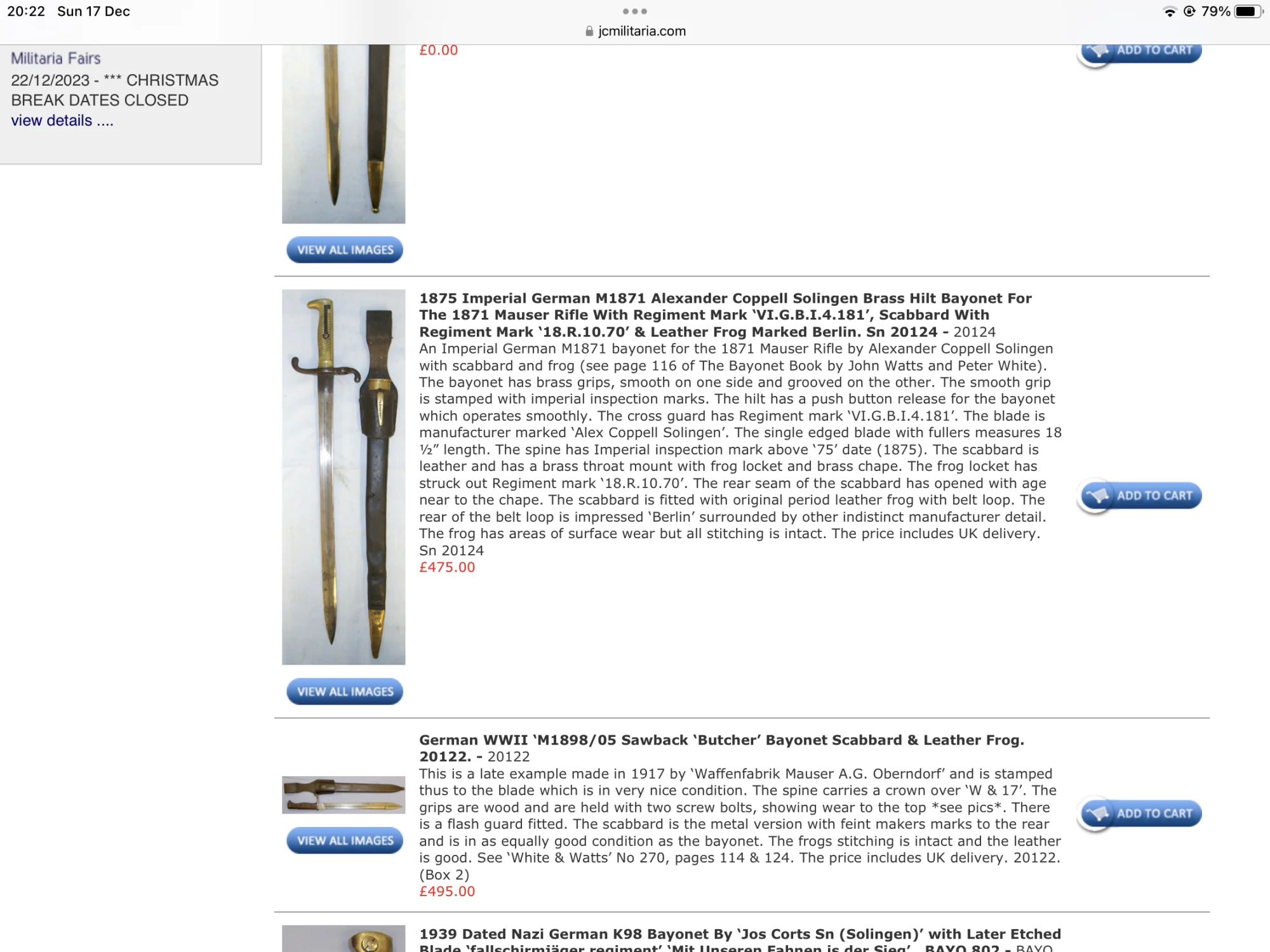

A friends father died this year at 101years old. Whilst clearing his house he found this in the attic. A quick google of the photo shows it to be a German m1871 bayonet. Whether original or reproduction I don't know yet, maybe someone here can shed some light. Specifically on the Regimental markings and perhaps any value.
I've only got the photos at the moment, I'm hoping to handle it in the next couple of days.
Thanks.
This may help once you get your hands on it, and its not a repro 👍
The regimental stamps are often difficult to pin down so i wouldnt bother too much with that beoynd checking that both blade and scabbard match, the makers stamp is more important as rarer makers are more valuable than common ones
If you intend to keep it then a mild clean and preservation is the way to go with it, dont be tempted to polish the hell out of it , happy to advise on that if needed, if it is to be sold on just leave it as is and let the new owner sort it
If it does come up for sale i would be interested for my collection or can point you in the right direction to sell if needs be
I hope that little lot helps 🙂
