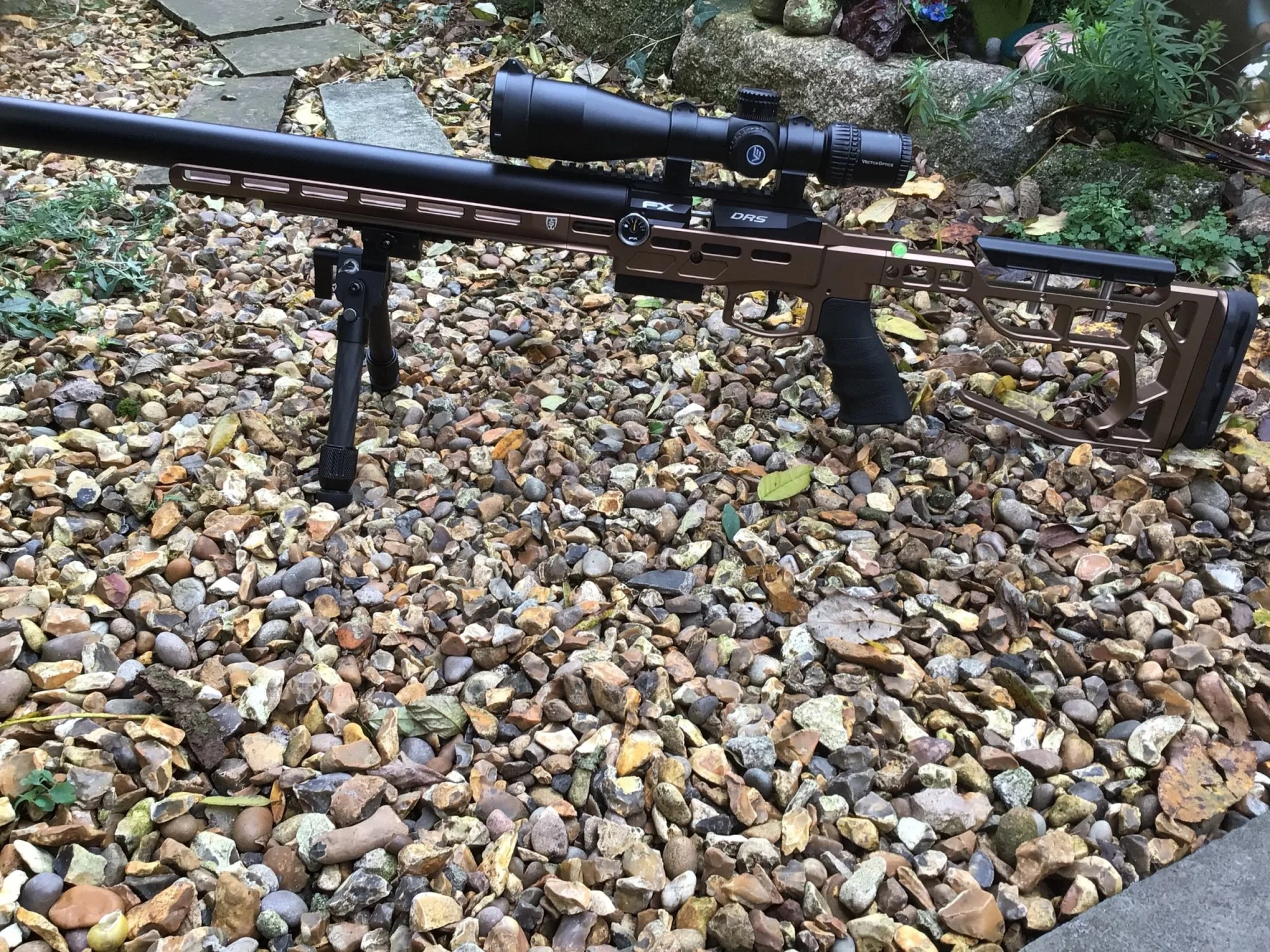

For balance, I really enjoy mine, not superbly well made but good value. It's way more accuate than me, shoots well and has a smooth and (so far) faultless sidelever/mag set up.
Good air economy, nice handling. The rifle can be improved in certain areas, but so can most rifles. I re-stocked mine, because I could, and not from neccessity.
The bad, warranty is with SGC. FX QC is pants. Mags are fiddly and too expensive. You need a pic rail adaptor (£80!). It has that ludicrous barrel system, but the best version of it, in a rigid cylinder.
One of my better rifles, do a search OP, you'll get a better spread of opinion.
