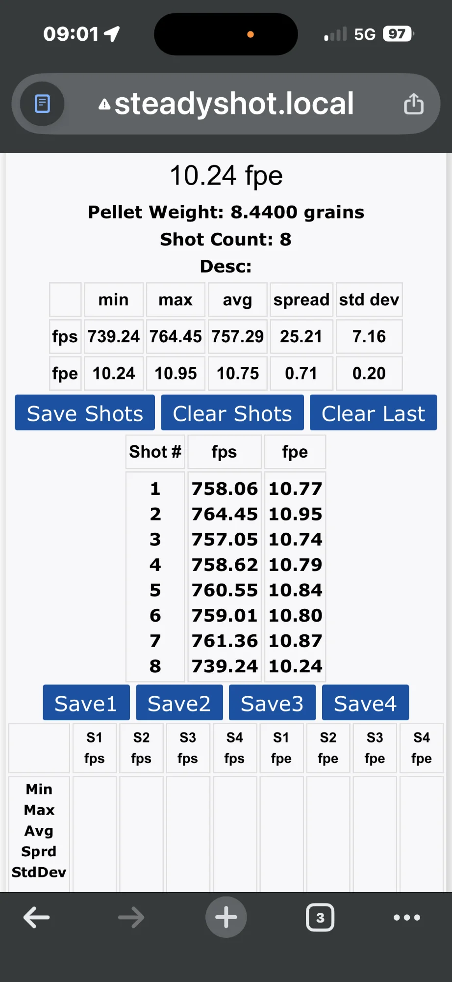

a member has just seen my revere .177 shot string with nate chrony off this morning ... i am pleased he said something got me thinking now
i need guidance
does the power look right or is it all over the place ... i am thinking shot 8 is when i removed the magazine then fired without pellet
maybe try with a heavier pellet do you think
cheers
Your gun is spot on, the variances are good apart from shot 8 - I find mags can increase variances, if you have a single shot loader or can hand load 10 pellets and do another string it would be a better indication of your gun - if you weigh them - all the better. It's a touch low at high 10s with 8.44s, but nothing to worry about, I'd expect it to be low to mid 11s with JSB Heavies, and I see you got a high 11 with Hades - so realistically you can't turn this up legally anyway (y)
