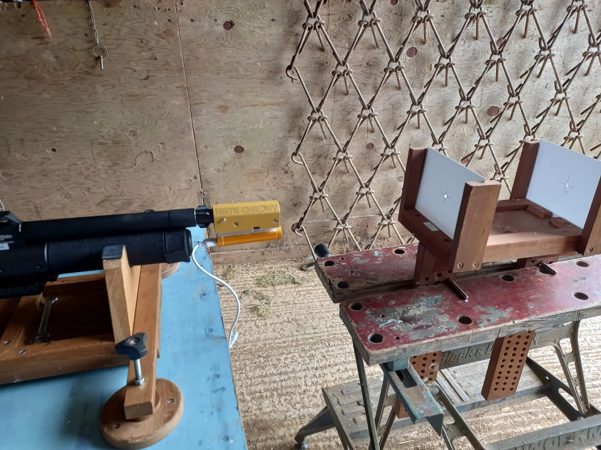

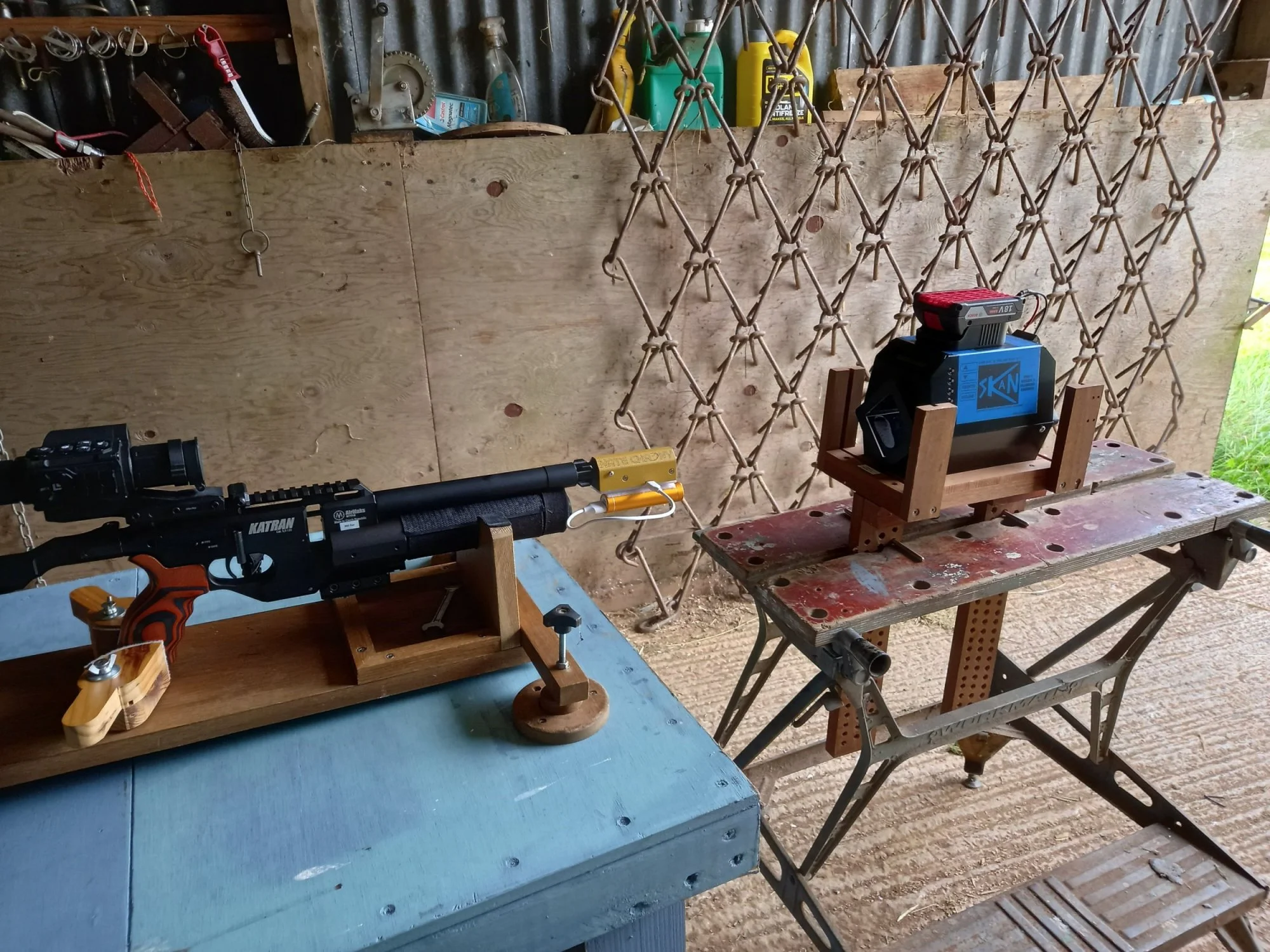

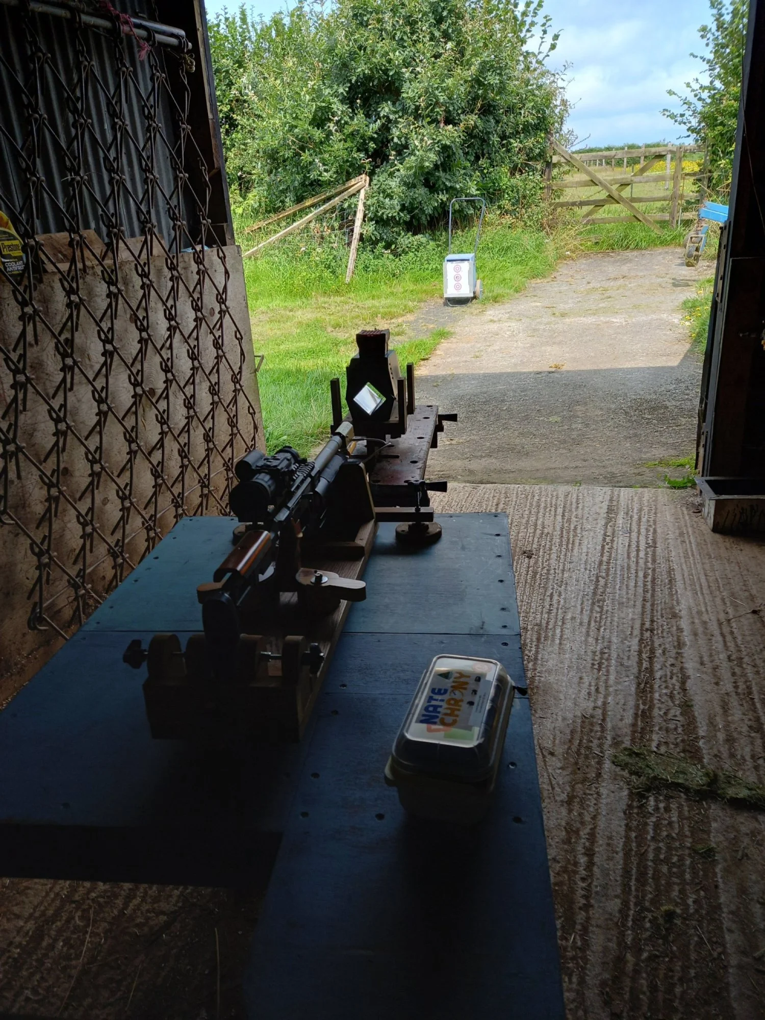

First I clamped the rifle in my gun stand and aimed it onto a safe back stop. This can be seen in the last picture.
I then placed my Skan holder in an old Black and Decker Workmate (without the Skan on board) in the line of fire and adjusted the holder so that the pellet would pass through the main axis of the Skan. The cross on the cardboard is to indicate the central axis of the Skan. So when the pellet goes through both crosses the Skan is safe. 🤞🤞🤞
Adjusted the holder. Good enough I think.
The overall setup.

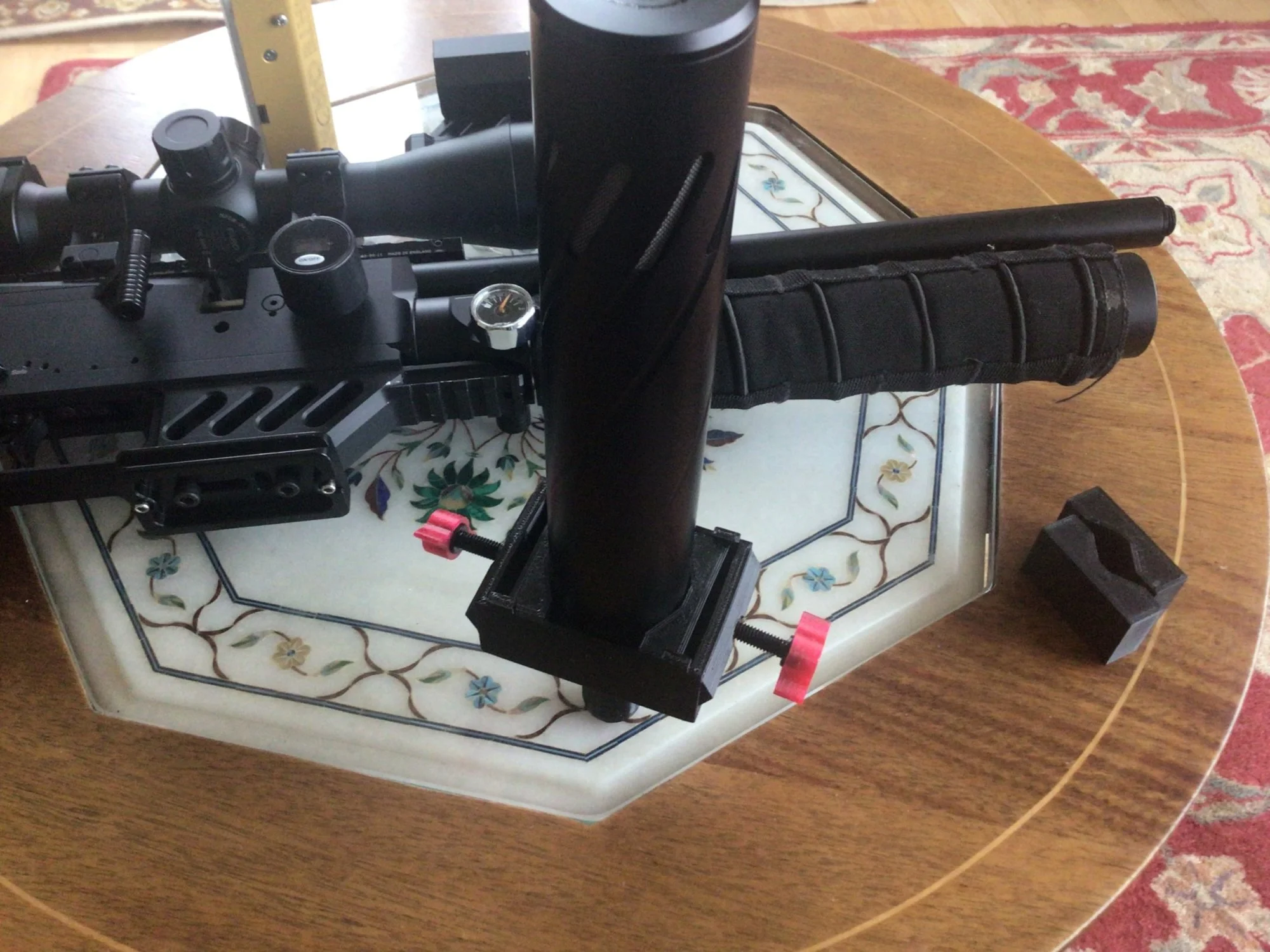

Have you a pic of the silencer adaptor?
Hi eddy6419.
I have two rifles, one with the Hugget Magna 40mm diameter mod, the other with a HW 30mm mod.
Rather than buy two adapters I purchased the one that can take either mod.
The Natechrony attachment comes with the 1/2” screw on adapter already fitted. This adapter is a push fit into the Chrono & retained by a screw. Small screw driver provided!
As you can see there is a decent size transfer hole for the pellet to pass through.
The screw adapter has to be removed, undo the retaining screw, pull out the screw adapter and push in the mod adapter and screw up the retaining screw. (Nate has made special adapters for people with funny shaped rifles, even for those that have fixed iron sights.
Mod adapter.
Front of adapter.
Shows both insert, but only one is used depending on the size of the mod.
If one only has 30mm mod a smaller adapter is available. (And cheaper - size matters so I am told 🤫).
Fitting to the mod. Chose the appropriate adapter insert.
Place on the mod, and tighten the red retaining screw/bolts up evenly.
All you have to do is to ensure that the mod is centralised as best you can. However the transit hole diameter is big enough for coping well with a little misalignment.
I have spoken to Nate and future adapters probably will have a centre marks to enable an easer centralisation of the adapter on the mod.
Hope this answers your enquiry.
