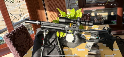

In the end I just mounted it on the kids mito carbine with 1 mount. It’s been perfect so I guess that’s another option too. IMG_1682.png

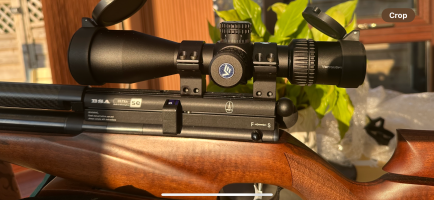

Can’t recommend a Veyron enough!
Quite tricky to mount on some rifles with limited rail lengths though, but fine on an ultra! (Multishot) with complete rail. The higher mag versions have slightly longer mounting tube surfaces.
