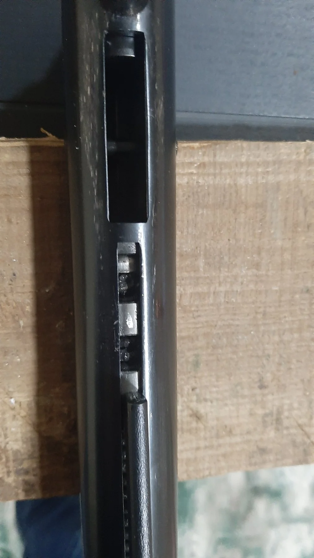

I finally went to disassemble the gun and removed the trigger. As a sub assembly the trigger seemed to be working fine, I could engage and release the trigger itself.
Aftwerwards I've put it back in the gun and the faulty behaviour is still there, can't cock it.
I am now tempted to go a step further and remove the spring, this way I would be able to simulate cocking it, and maybe see where it is hitting a hardstop or something.
Any ideas?
(I've attached a few pictures, could see nothing unusual.)

in the third picture is that fracture metal i see and yes i downloaded and enlarged or is it just mung
take the spring out
does it have a front spring top hat if so set it aside and try with the spring
As above, I'd say the piston is cracked where the cocking link pushes against it.
Those cracks are not on the holding face so I would have thought that wouldn't be the issue.
Possibly Coil bound, removing the top hat, if fitted, would prove this.
I would cock it out of the stock (not easy to do) and observe whats happening. Best with two people.

Went back to the gun, there is no crack in the previous picture, that was only some grease.
I've cocked the gun out of the stock and took a picture where it seems to be the endstop, I don't think this stroke is enough to engage the trigger, it seems something is blocking the movement but can't understand what.
I've also found this weird think, looks a welded bit on the inside? I have no idea why that would be there, could this be the fault? It doesn't seem to be in the exact endstop though... (actually it might be the expected true endstop?)

That silver bit looks like it could interfere with the trigger latching.
Time to get the spring out I think.
Have you looked at the trigger sears? I stripped an older 300 years ago that wouldn't cock, the problem was the cheap metal used on the trigger sears, worn away to the point the sears wouldn't latch.
My first look was at the trigger but in my previous post one of the pictures (pic 3) is cocking the gun out of the stock, and the trigger unit is not there. It will still find an endstop at some point.
