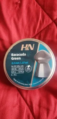

I initially bought 8 different tins of pellets, one being the H&N Match Green (lead free). After buying them I came across threads mentioning that lead free pellets can damage the barrel. Is that true?
I'm not aware of lead free pellets damaging rifling but they are harder than lead. They are ususlly quite poor performers, especially at distance and they loose velocity quickly. Unless forced to I would not use them.
You would be well advised to purchase a chronograph if you intend to pursue this hobby regardless of whether you choose to fit a tuning kit or not. There are various basic models cheaply and readily available that will ensure that your rifle stays in good condition and more importantly, legal.
One more answer:
I suspect that if you look closely at the lid of the tin of H&N Match Green pellets you may well find that it states "For PCP rifles only".
Your HW97KT is spring powered and not a PCP.
However, the pellets will not harm the barrel but H&N print the disclaimer as they have found that the air blast produced by spring guns is different to that from a PCP and may cause pellets to jam in the barrel of a spring gun.
I have tested them in my HW77 and HW50 without any problems but they don't wish to expose themselves to any claims for damages.
The Green models of tin pellets are lighter than their lead equivalent and generally have a harsher shot cycle. The H&N website lists their effective range to be only 30 metres, compared to 50 metres for the lead versions.
Pellet testing for accuracy tends to confirm this and fortunately the anticipated banning of lead pellets has now been cancelled or at least postponed so there is no reason to use the more expensive and inferior Green models.
