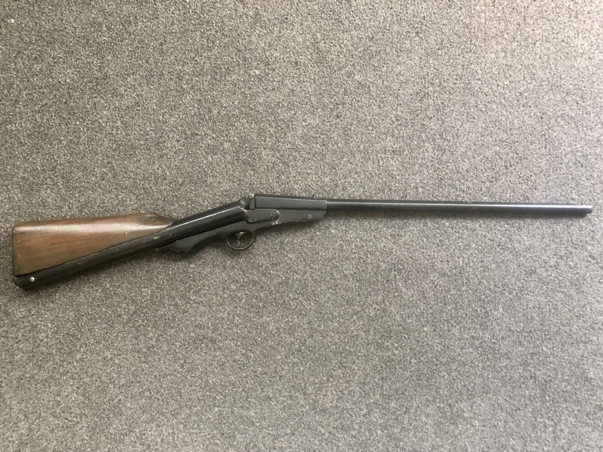

I was searching the usual “for sale” sites & come across this Britannia air rifle made between 1905-1908. I took a stab at it not knowing the exact condition of the rifle all I was told is it cocks & fires & for the price I couldn’t refuse😁

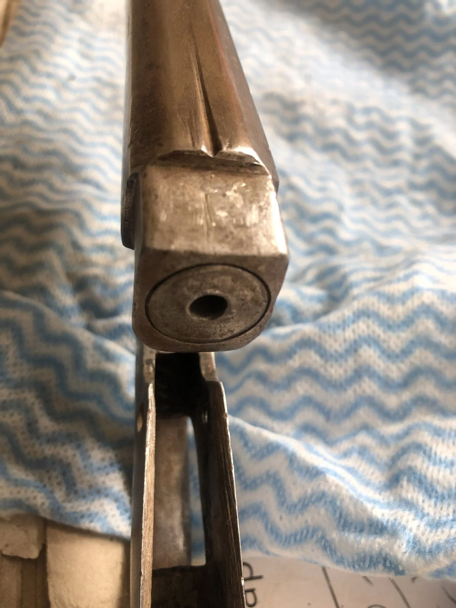

I noticed straight away the end of the cylinder had been drilled either side to take a DIY end cap, why the previous owner couldn’t just drill end cap to fit the original hole in the cylinder I don’t know?🤨

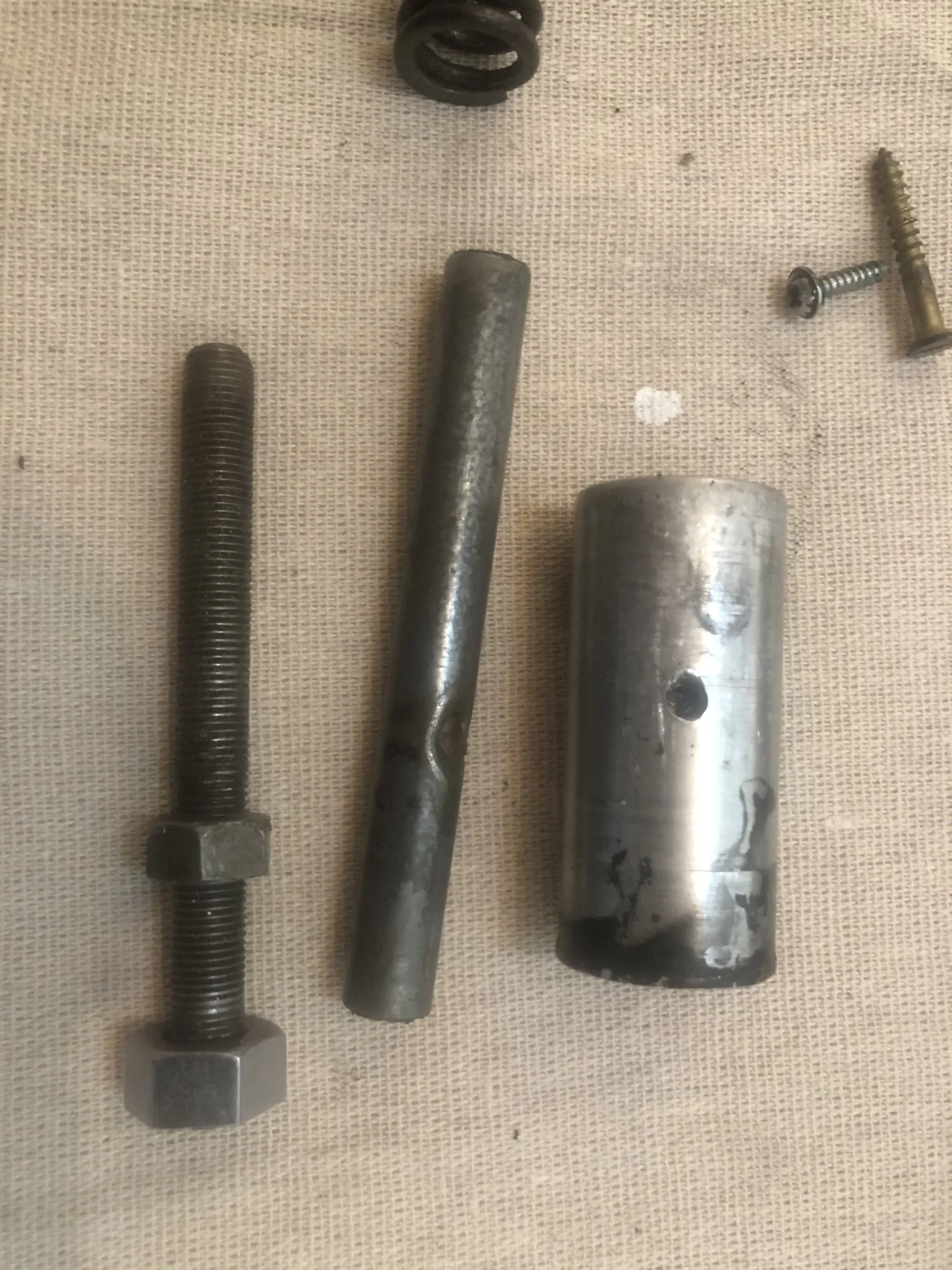

As I started to strip the rifle down more parts were missing or damaged. As the end cap/mainspring guide is missing previous owner has used a basic nut & bolt to act as the guide along with a metal cylinder for the end cap & a piece of metal pipe that fits over the bolt.
End of the cylinder where the curved butt plate sits has been snapped off in past & repaired with two pins which have come loose over time, could possibly try to weld back together & sand?

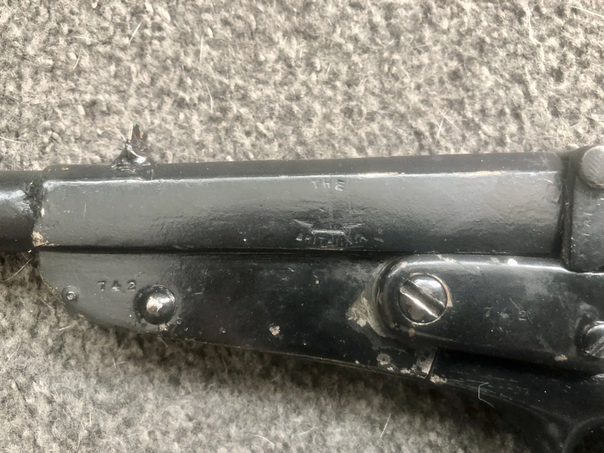

Most of the markings have been sanded off in past, Anglo sure shot No.1 Mark 1 & Made only for R. Ramsbottom Manchester barley visible Cox patent is barley visible, the Britannia marking is still clearly visible.
Strangely the markings are set at side of the breech block & Cox Patent is above the rear sight as I’ve seen others with markings on top of block, also has deep cut out to maybe act as alignment for rear sight?
SN 742 trigger-unit stamped RD394207.

Some interesting markings have appeared now the paint is off.
One is an arrow on underside of the barrel pointing towards muzzle & the other is H C marking that is upside down on the right side of the barrel
